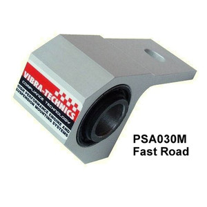

/shouldofboughtvibratechnics !!!
I really rate these and a lot less chance of the rubber dyeing
