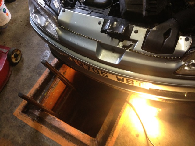

Well start of the day was just terrible. Starting jacking car up got it on first axle stand no problem. Come to raise other side and guess what..... My driveway started collapsing and my car falling over. Just got hold of the car. Shouted my mum to get my next door neibour and sorted that put an got a tow down to my uncles garage who has a pit. Much safer. Just trying to get the clip through the bulkhead now.
My pedal has no spring to it. It's just drops to the floor? Is that cos the clips off it?
Good old fashioned pit.... Umm too tall for it!!!
yea the pedal is held up by the cable, so no worries there
Ok good. See what you mean by the who. Got the air duct out but still no use. Got a mate coming when he's finished work so should be a help then one thread as one pulls. Smile
