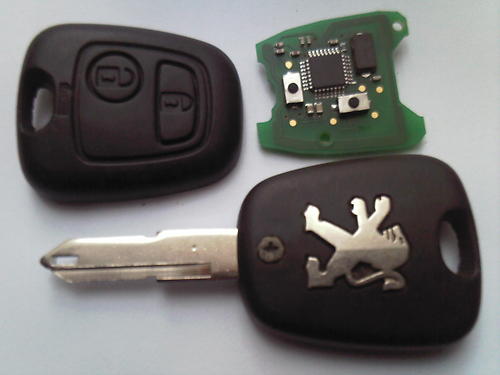

Basically I have the key to my car that is the really fat 2 button key with the LED on it, now my problem is this I want to convert the key to the attached key so I am able to swap over to a flip type as to be honest I'm sick of putting my key in my pocket and stabbing me in the bollocks!
Or am I able to convert to a flip key straight out please somebody help me save my nuts!!!

Hmmm only way I can think of Doing it is fitting a aftermarket locking kit with a flip key. You can't program that chip in the photo to your car because yours is IR and the chip is RF.
The 306 circuitboard doesnt fit into keys off the bay such as this, this or this
The buttons do line up, and locate into the housing, but the rest of the circuit board sits at such and angle it will not fit the body of the key. Unless your handy with micro electronics, and have a steady hand for precision soldering I would wear a cricket box or similar to protect your nuts mate.
Far more hassle than its worth IMO
