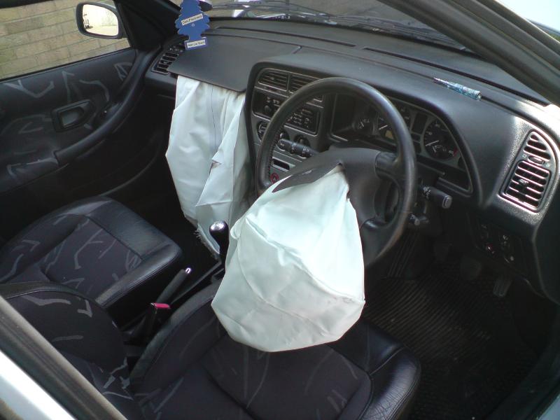

OH FFS DONT TRY TO FIX AIRBAG LIGHT!
nuff said Bollox!
lol
Oh dear :/
Bwahahaha LMFAO
You even predicted that this would happen and still you f*ck it up.
The stupid thing is Ive played with the air bag systems on enough 306s and managed not to set them off yet you the electrics expert manages to fail.
Oh Fuvking LOL !¬!!!!!!1
:clap:
That took you a while.... :L
ROFL, so how did you manage that then??

Good work mate, very clever to notice the safety features. Id of been a pikey and removed the bulb
Was I the only one to notice that wasnt his car to start with? lol
Connor Wrote:Was I the only one to notice that wasnt his car to start with? lol
I noticed first and then everyone else did, scott deleted the comments though to keep people falling for it Wink
Fuvking lol, saw the pic and thought that's not cullys? Who's has he broke haha
Ahhh lol silly people
Good effort with setting them off, I would have just removed the bulb as chris said through fear of setting them off Wink
THIS
LOL @ the people not reading the whole thread!
