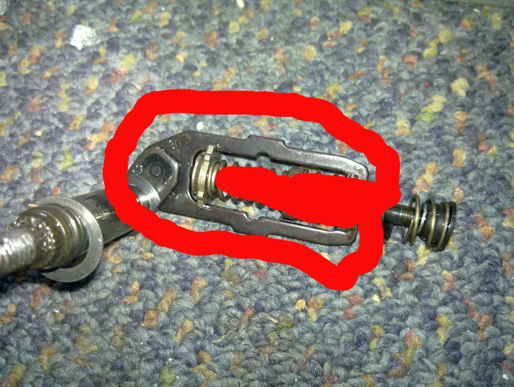

This bit Sad

Ah, the cradle. If you don't get one by the weekend I've got a transit one here you can have for the cost of postage

Are they the same?
Another question why im here, say you forget to mark the throttle arm before you take it off. how would you then go about trying to get it back to the correct possison?
#64
1. The transit cradle has a slightly longer throw than the pug one and is a nice little mod
2. Fail, lol! You will have to put it on so that you can apply the throttle until you feel it com up against the gov spring then it should go a bit more while the spring compresses. May be a bit of trial and error though to find the sweet spot

Do you think. The throttle shaft not being set up correctly. I.E had a mile of slack ti the point where turning the throttle still isnt pullin the cradle will couse the promblem im haveing. Aka no pressure what so ever??
#66
Could well be that the pump just wasn't set up for enough fuel to idle.
Stick up a wanted thread for a cradle I'm sure someone will have one they can get you quick
