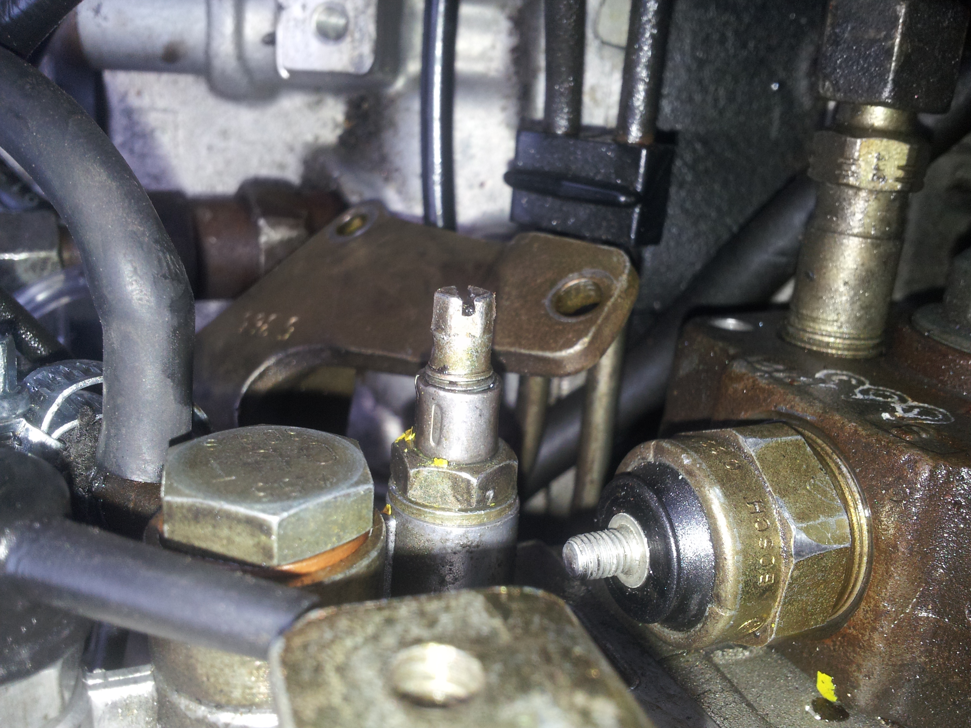

It wouldnt be that someone has wound the max fuel screw right out would it?
Possibly

Anyone got a pic that shows the max fuel in OE possion?
Give it a full turn and then see if it pumps fuel, if it does, tighten up the unions and then try and start, just be ready on the clutch in 5th just in case..

Dosnt look like its wond out
That's still got the security seal on so fueling hasn't been touched

I take it you have the wire attached to the solenoid? As there's no wire in that picture..

Iv took the internals out of the solinoid so effectivly its dosnt have one atm
