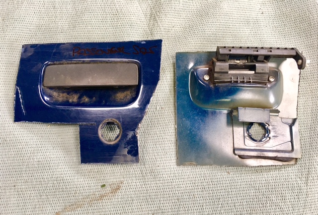

My Friend had a pair of handles for me off a smashed up 306 getting scrapped but forgot to tell me he removed them in a different kind of way .... Rofl
He said the actual door surround / metal would come in handy to see size & shape I need to make mine ....he's got a point but I'm not fitting barrel locks though just the handles Inlove

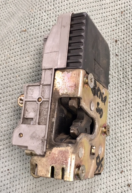

He also gave me a pair of door Latches ...I may need to look for a pair of base model none central locking later on as I'm not using any of that extra side Speechless
wow... yep those handles are certainly removed! lol

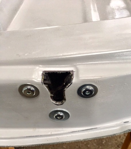

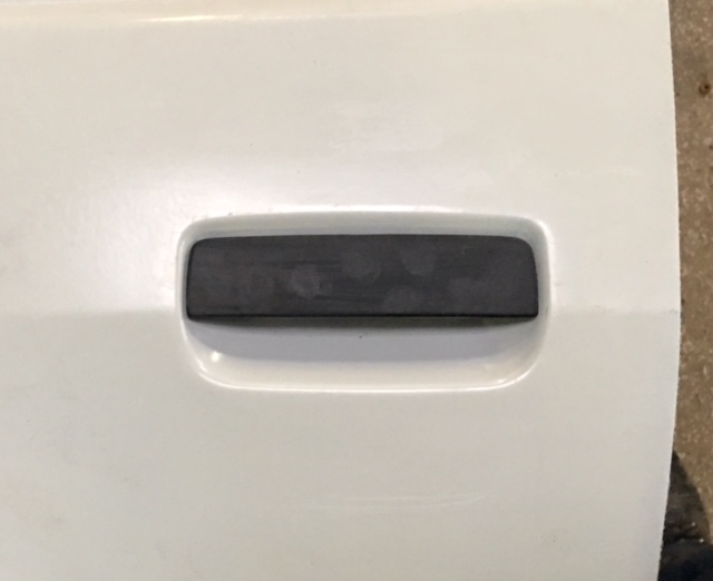

Door handle square cut out of Kevlar & latch fitted & works the same as OE ...
Well small update....doorhandle bolted in place as above post & door Latch screwed in place & door tried back on & it's works / closes almost like original ...
Scratch resistant fixed / bolt in Polycarb windows coming next week with McDonald's Big Mac size 210mm sliders...
Outside opening door handle works as standard too ...just need to cut out internal Carbon door panels for standard internal handles & bond them in & fit wire rod from door latch to internal door panel handle ...
