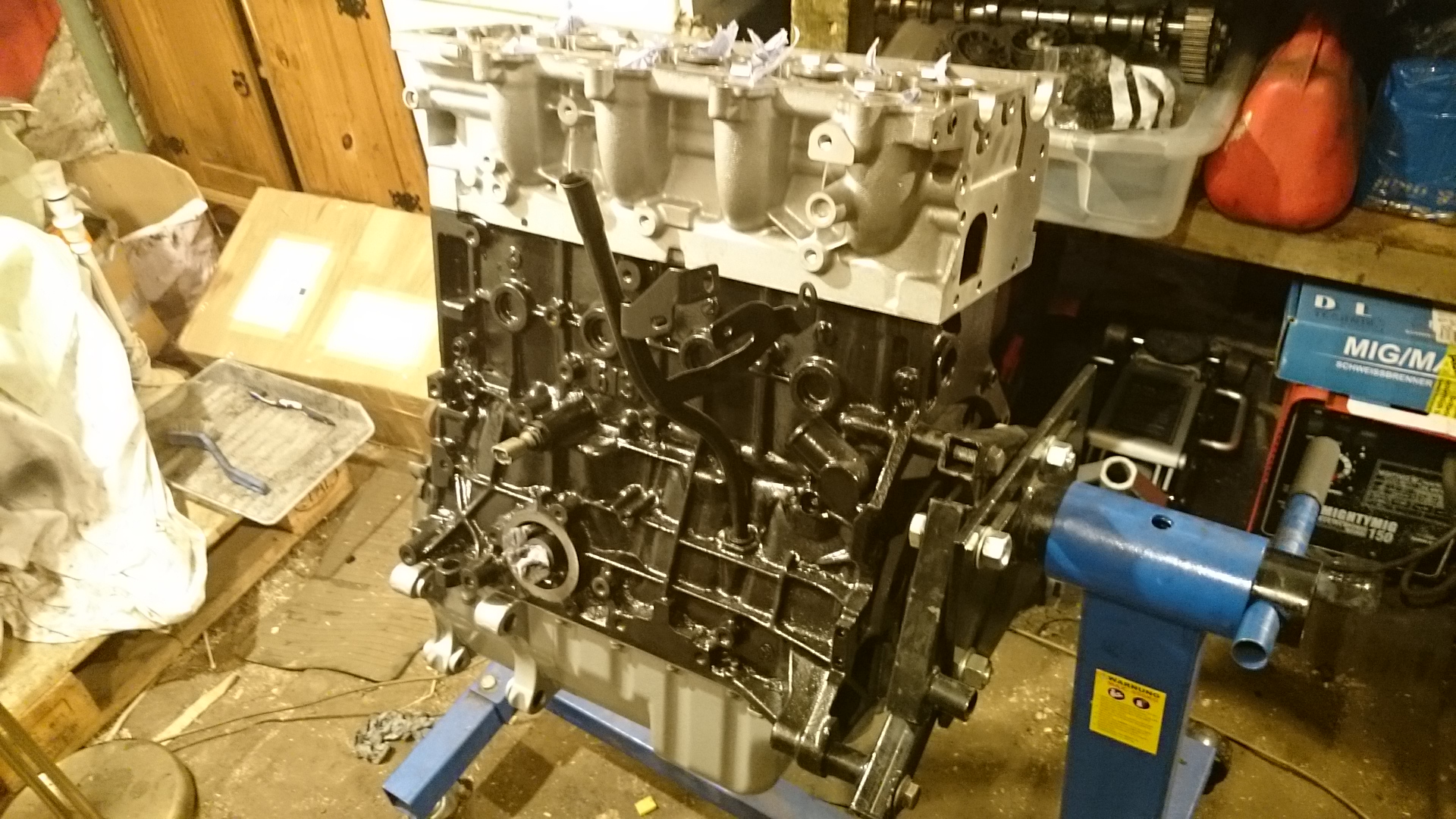

Moved on to sorting the head now...

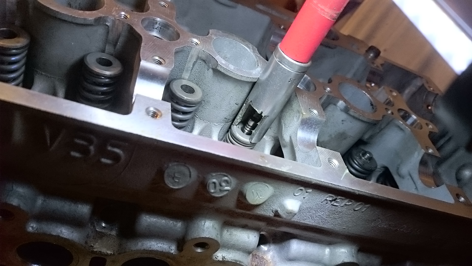

Made up a "specialist tool" for the stem seals as they are a total utter cows udder.
Also drilled and tapped the end hole for the swirl flap shaft. Made a bolt to fit. Sealed her in gurrrd

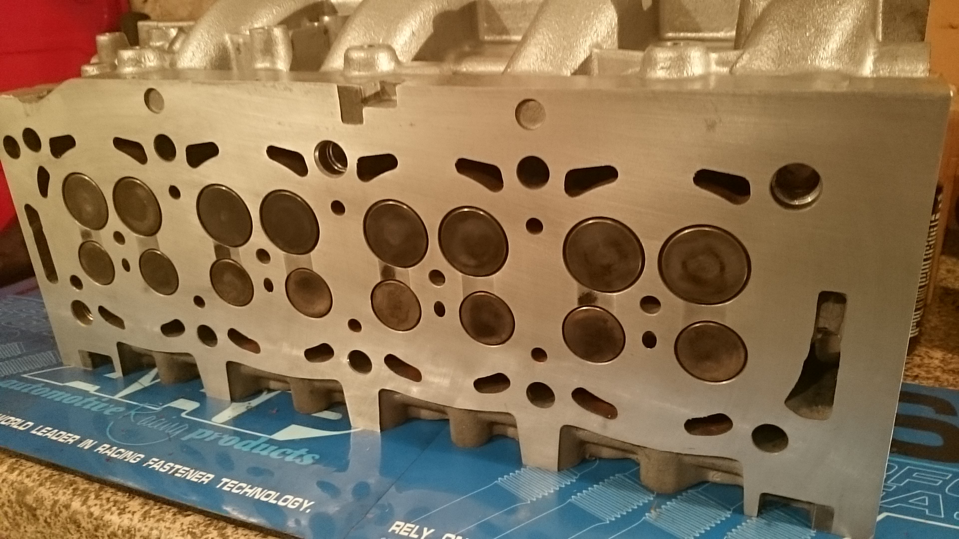

Finished the SIXTEEN valve seats this evening...exhaust side were AWFUL!

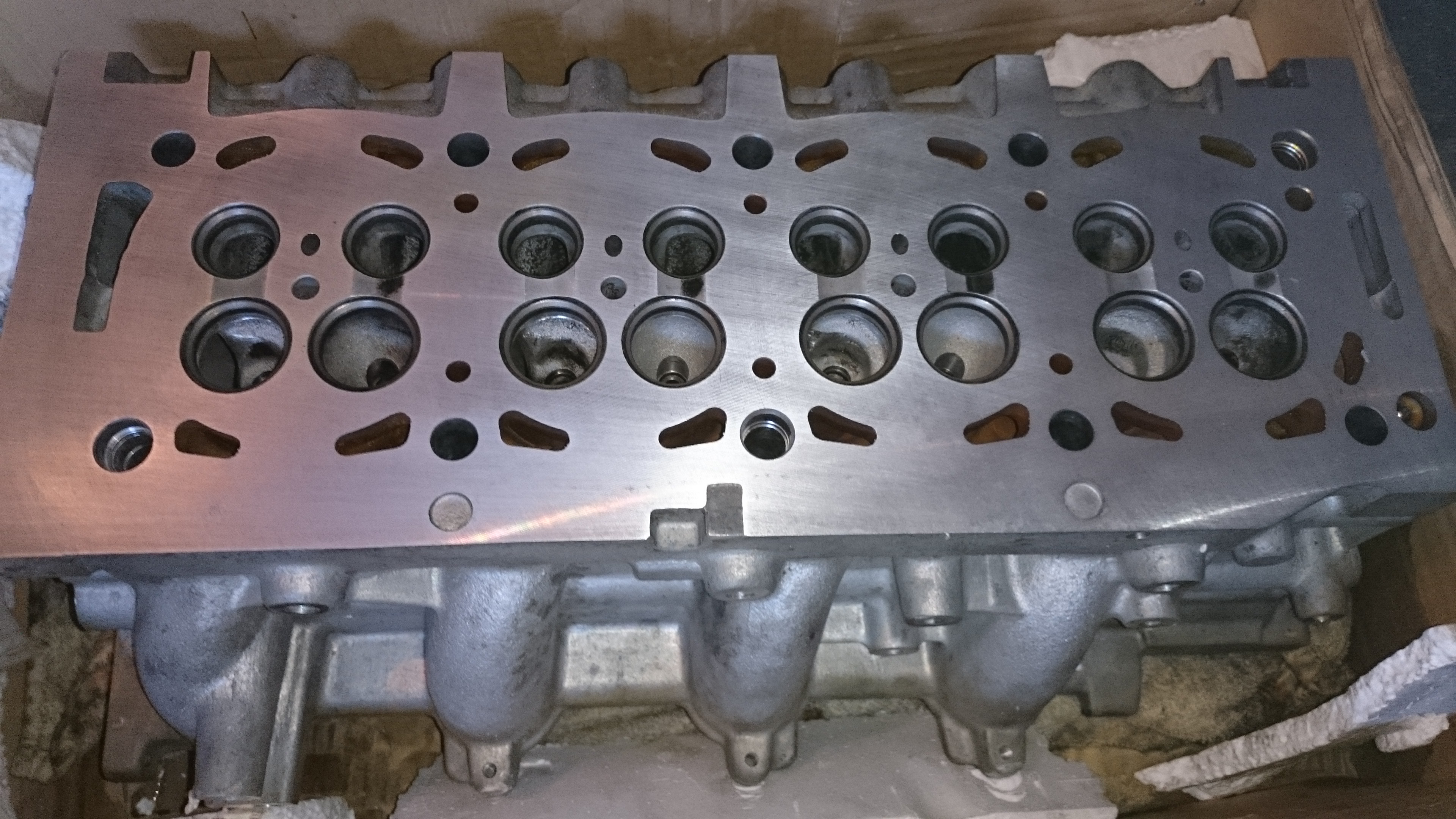

Big parcel arrived today...
Head back from engineers and flangey time.

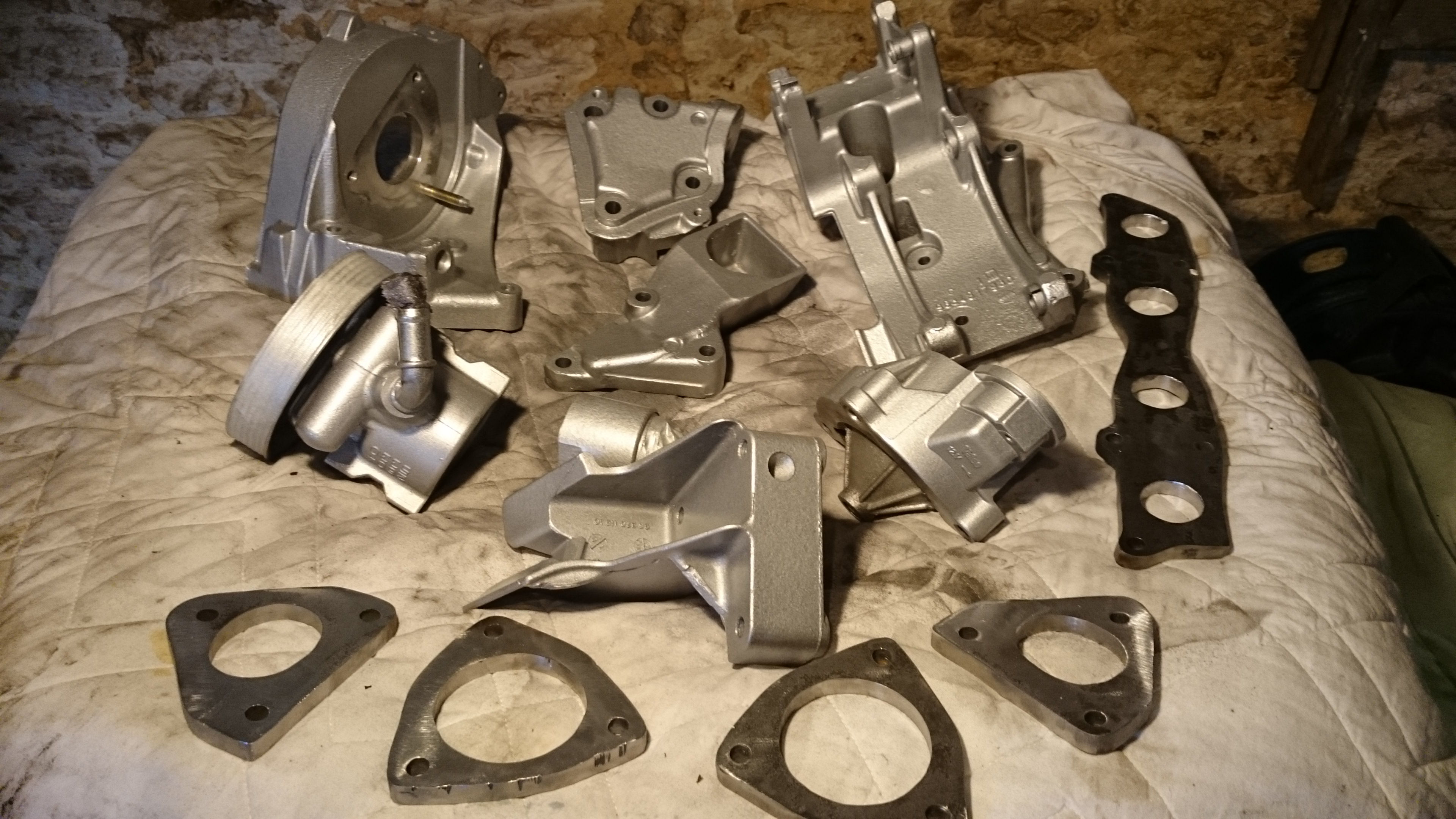

Also pictured are a load of the aux bits which were cleaned up and painted...quite time consuming and boring...actually, VERY time consuming and mind numbingly boring.

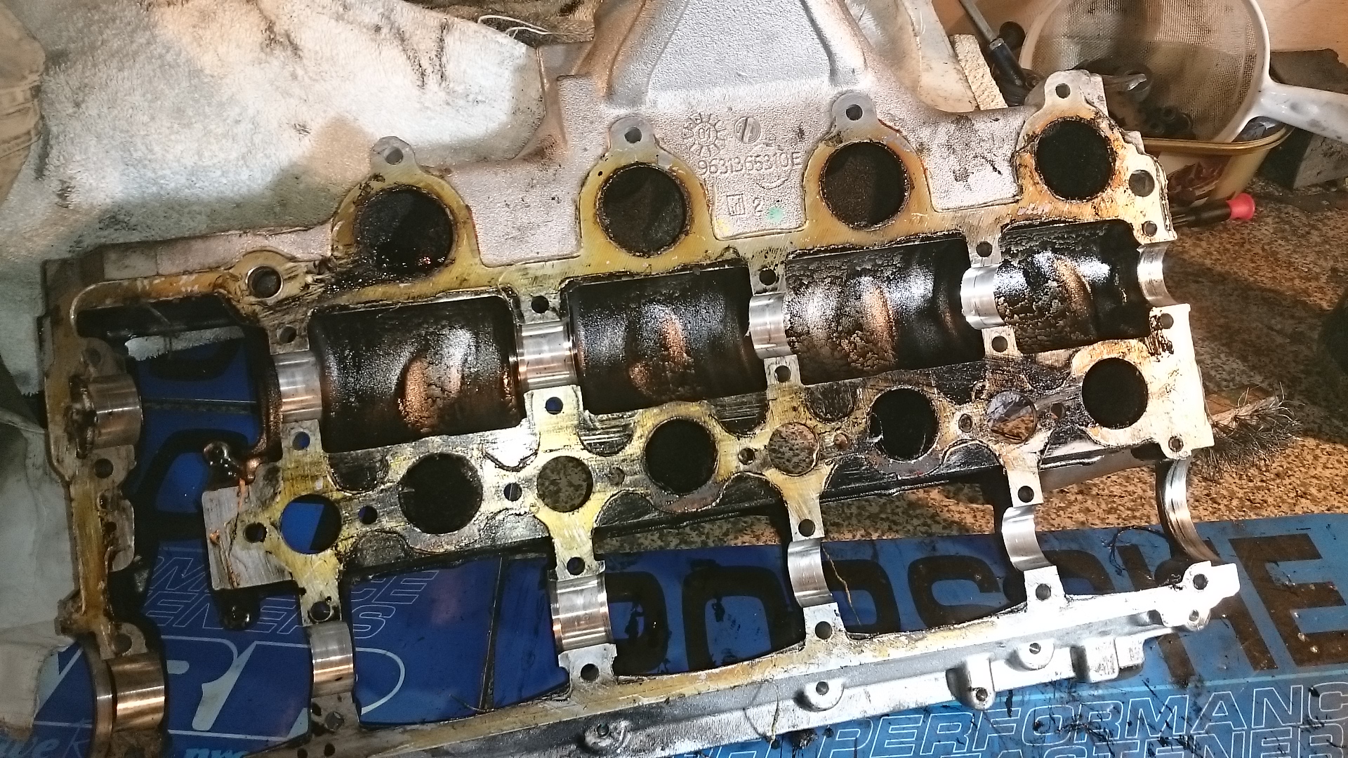

Had to spend sometime this week cleaning this...what a mess it was...90% blocked in places...
Anyways...good things happened!
First... Valve springs. Left one is old 45lb, right hand is uprated 75lb.
Fitting them...can't use ordinary spring compressor for many reasons...so...

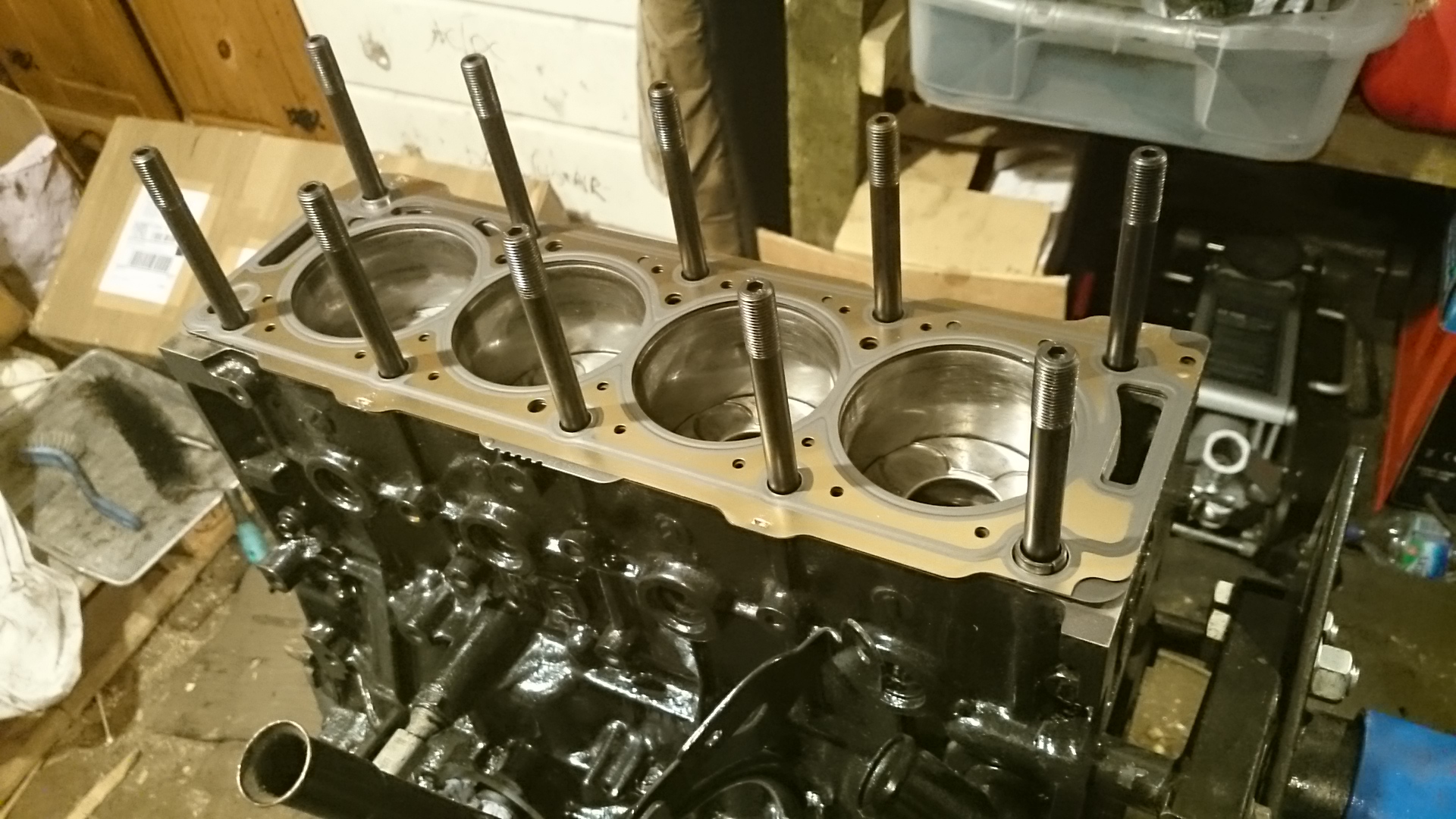

Then I shoved a Elring HG on the deck and wacked a rather useful 16v head on it!
Wet pants moment when bad noises were heard as i torqued the head down with the ARPs...
Slight relief met with annoyance when I then snapped the 12 sided socket on the next nut...
Que a lot of rumaging to find another!
6 sided FTW
