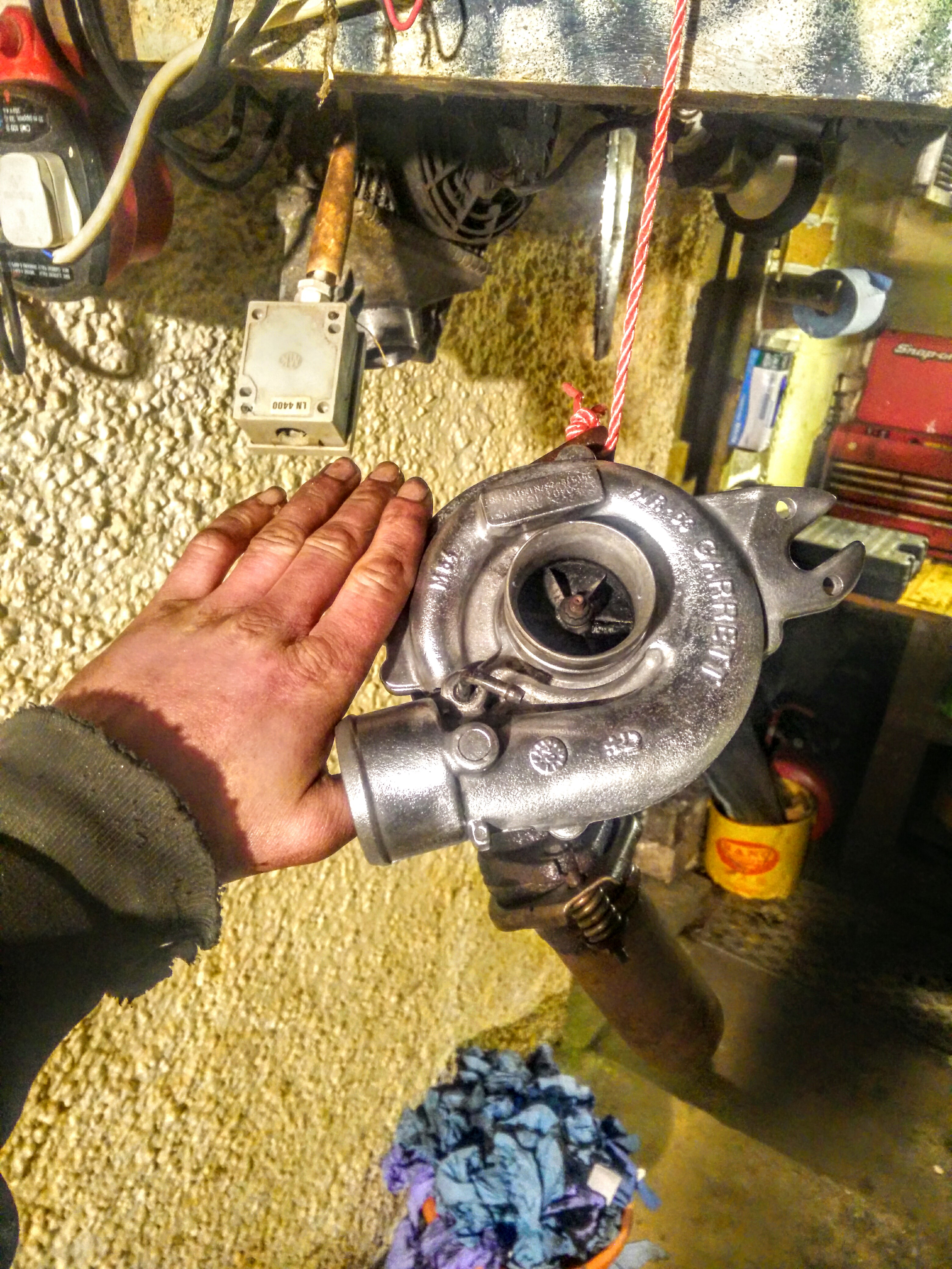

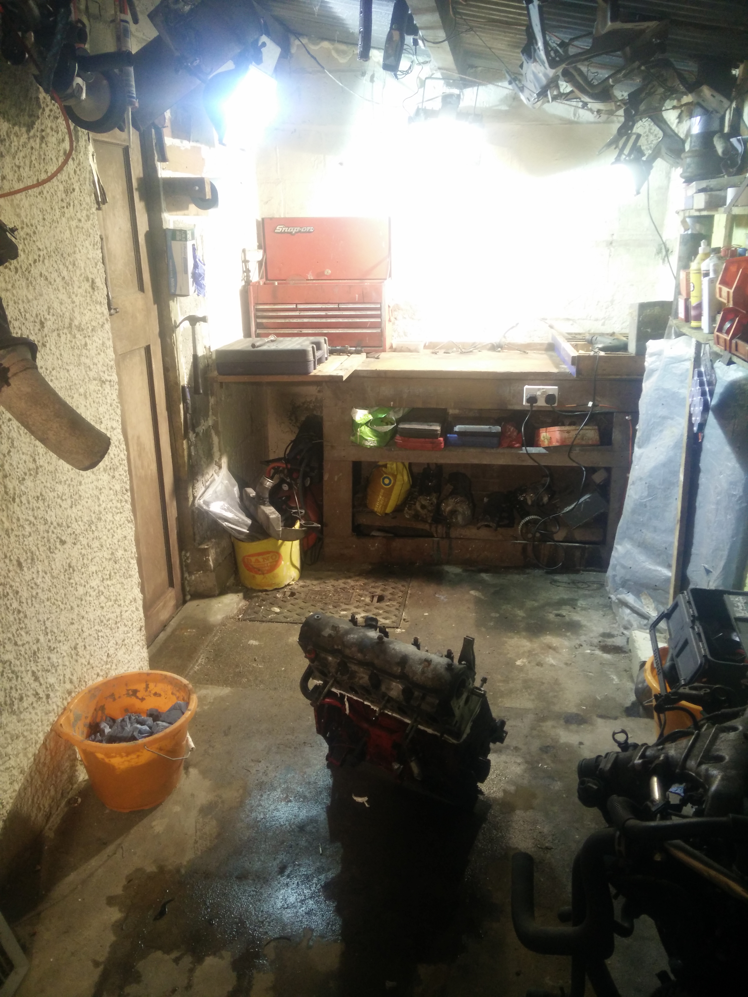

OK so I'm off again  just after redoing my shead so now all work can be done there rather than staying late at work lol any way allways wanted to do the hole twin turbo gearbox mounted turbos ever since the first thread just didn't have time to do it right so Hope fully this time :-) so the engine is getting sent away to get sand blasted and power coated Candy blue hopeing to have that done by  this weekend then i can start putting new part's on all Bean we'll .have got one turbo already a gt2056  so need to find a another one if any one has any idears:-) so that's were im at nw show is about 9 weeks away so  hope fully it's ready will keep use up dated :-)

Just fitted this now so hopefully all tight now so no sand can get in :-)

good luck man. the gt2056s will blow a hole in a standard block let alone twin turbos. So crack on i say.

Ye no wat ur saying like BT  super careful till I get rods sum way cheap :-) the hdi rods will do for now there good for 200bhp are they not . what are the gt2056 like. Much lag? :-)

GT2056 on its own should see you to 200bhp if fueled well.
Not that great for compound purposes but that all depends on how you going to do it and what to match it with
Lag on shifts is almost minimal, threshhold again is very small if fueled well
(21-04-2016, 09:58 AM)Piggy Wrote: Considered 16v hdi rods? Fair bit chunkier than the 8v ones.

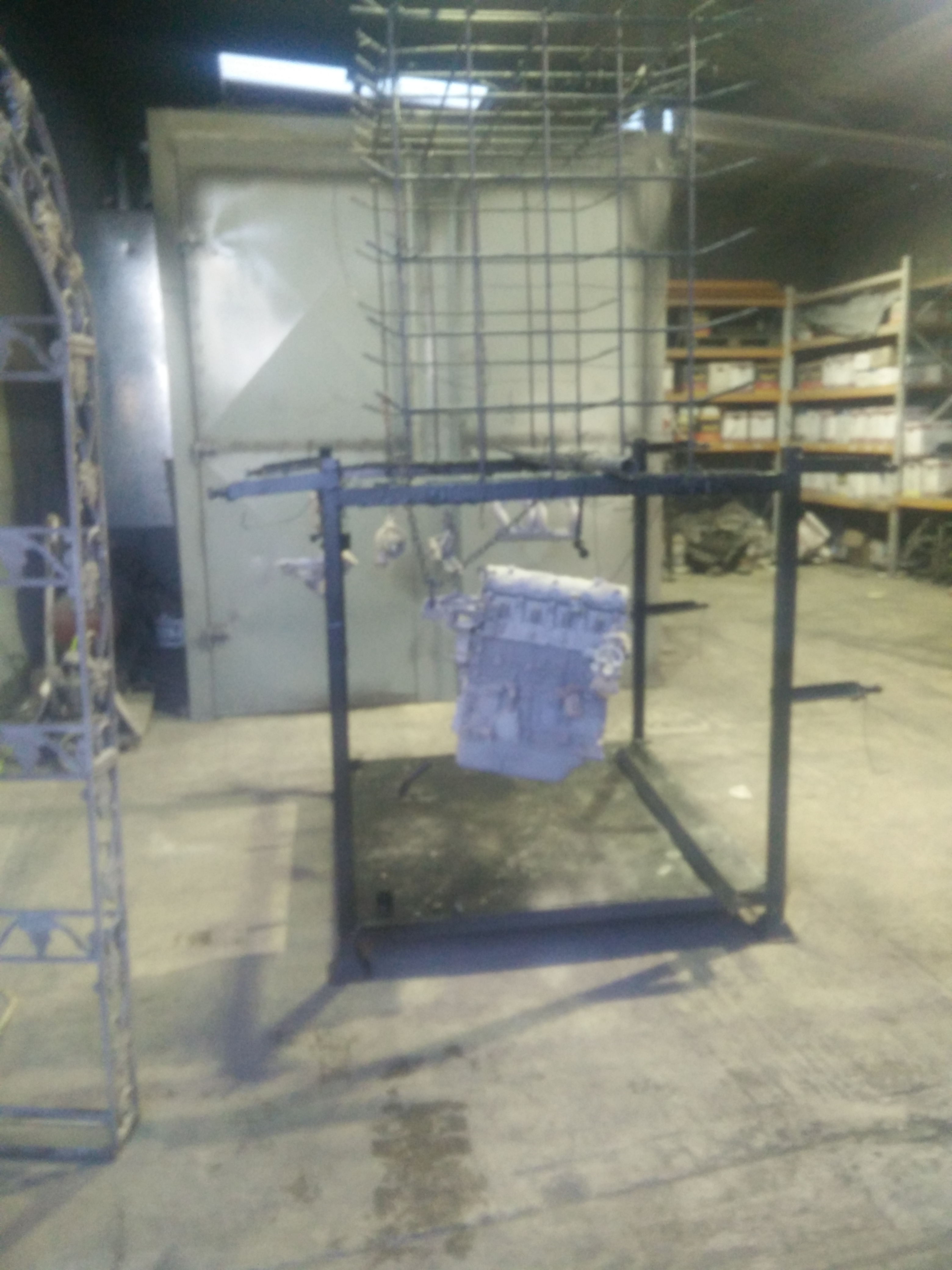

So now ready for blasting tomorrow and then hopefully sum power :-)
So sand blasting done was a bit of a bitch lol BT getting their
Ok so next it was time for sum silver paint this helps the candy pop lol the head will be staying silver so will the turbo's
Time for sum more powder :-) then back in the oven
So this is were im at now any thoughts :-) I'm very happy with the out come .its a lot more matalicy my fone just can't pick it up lol
The final cost for this paint job £0.00 :-)
The advance of having a cousin that owns his own powed coating business lol
