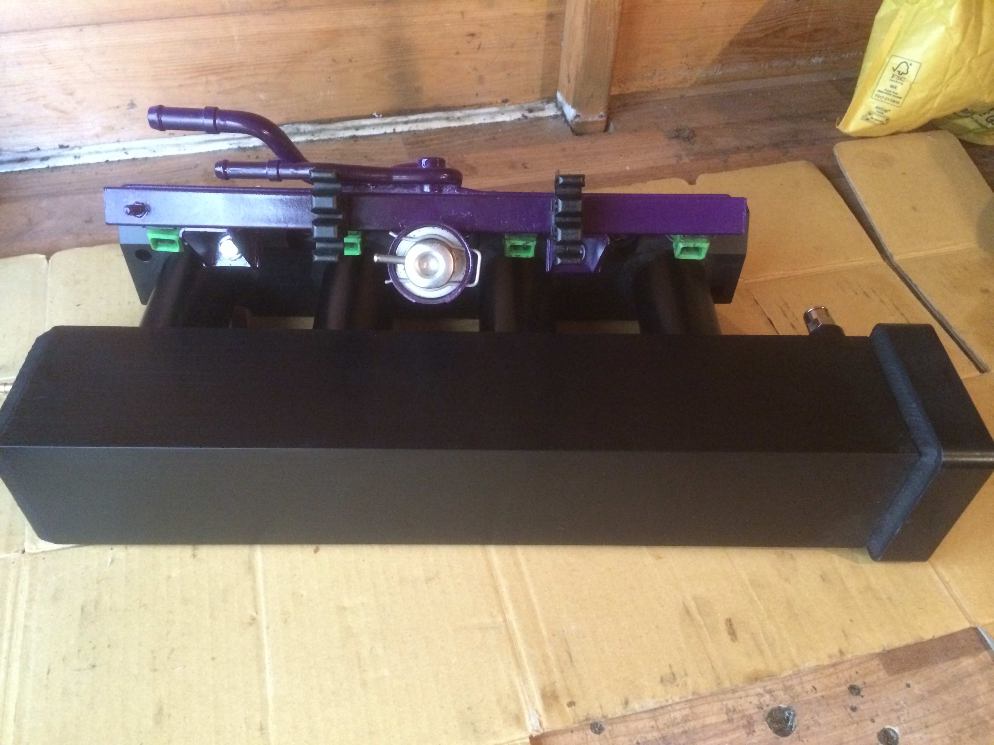

So today, cleaned up my 440cc injectors, replaced the seals and micro filters and got them fitted along with my nice purple fuel rail :p

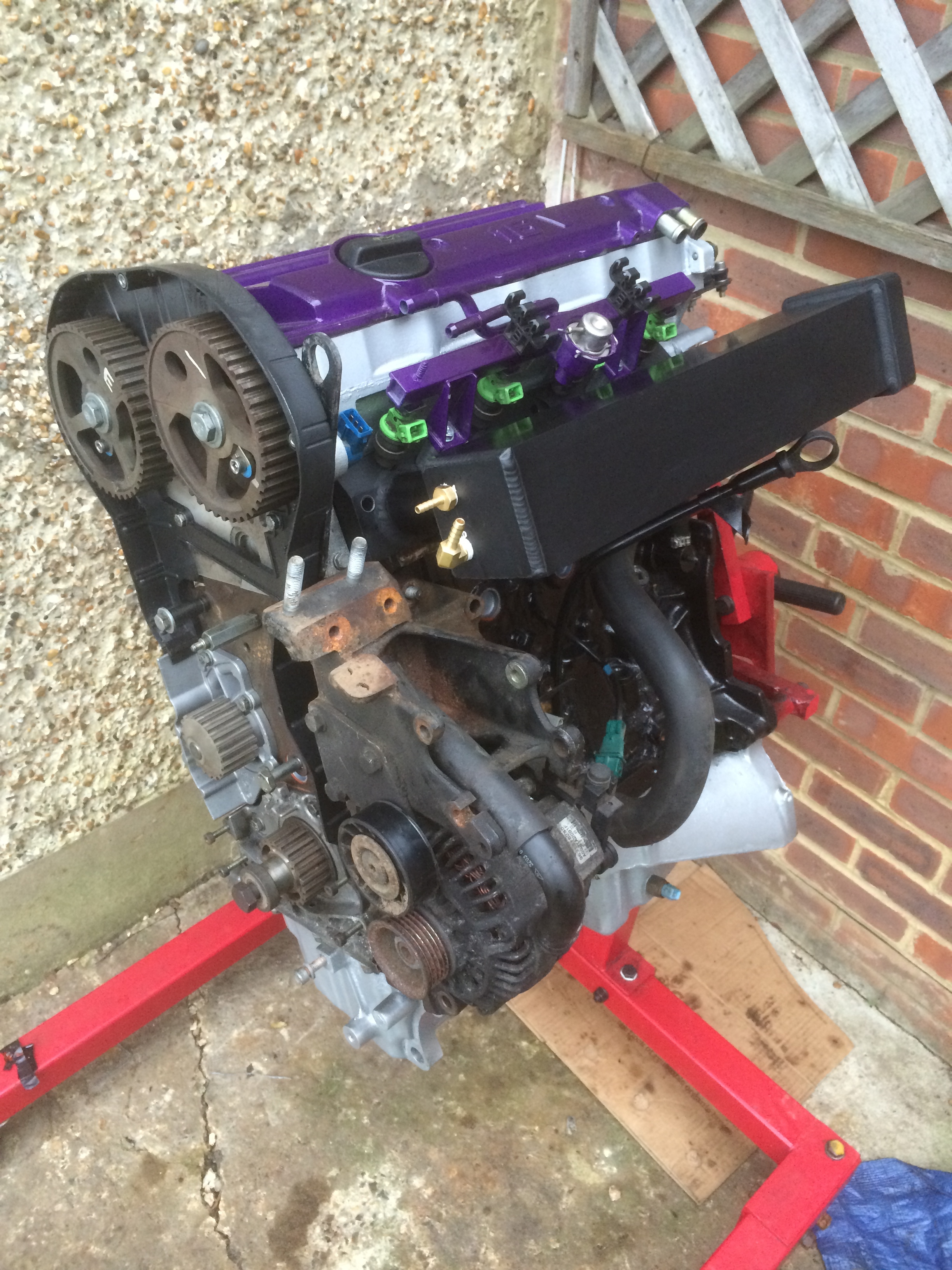

Got that loosely fitted to the engine so i could move some stuff about and work out hose lengths etc. Also got a few more bits painted and fitted so now the engine is ready to go in except for the coils which i haven't quite decided what I'm going to do there. The Omex 600 is semi sequential so i would have to run a wasted spark coil pack which i was going to do but Cully put an idea in my head yesterday to wire the original coils in a wasted spark formation. This would be easier and save some money but i need to look into how well (if at all) it would work.
Ive also made a bit of a chronic f*ck up. Seeing as I'm running the throttle body on the inlet, i haven't allowed anywhere for a ICV Sad. I need to look into the easiest way to deal with this but also if one is even needed! Suggestions welcome.

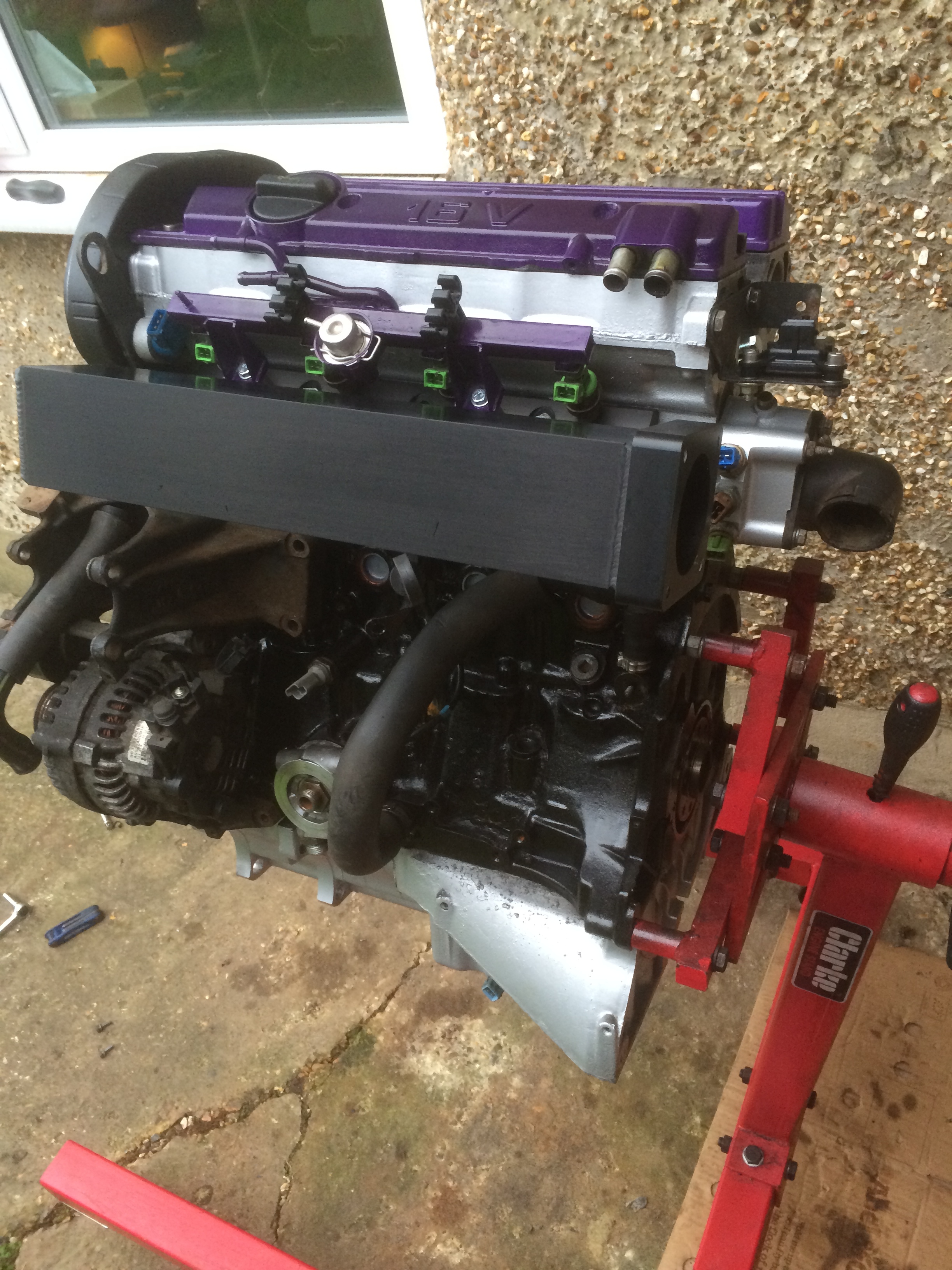

Looks really nice! so how is this charger being mounted?

(24-11-2013, 05:40 PM)ginge191 Wrote: Looks really nice! so how is this charger being mounted?
The charger is going to be mounted to a flat plate on standoffs and then on the back of the plate is going to be 2 bits of metal which will bolt on to the aux bracket where the PAS pump used to be. I was going to maintain the original PAS pump mounting points and bolt it on here for ease but that will leave me with about 5-6cm between the rad and charger making it quite difficult to get a plate on the front of the charger to get the outlet pipe on and also get the air filter on.

Niall iirc the super high boost lynx kits run with a hole in the standard butterfly, might be worth seeing if something similar could be done here.

Incorrect Chris. Super high boost kits run with a recirculation valve welded into the charger body, and with the throttle body on the end of the manifold where it should be, rather than pre-charger. This means they can use the oem ecu as it doesn't see boost.
Niall why don't you cut a hole on top of the inlet and mount an icv there? Should be straightforward from the install point of view, but I dunno how you'd go about mapping it on the omex, or if you'd even need to?

Ed, That was my idea but if i can get away with chopping up the inlet, i would rather tbh. Mapping it on the Omex is straight forward and if i did, i would do away with the pug one and use a different one which doesn't suffer from sticking as with the Omex, i can basically use any ICV i want.
I could just not bother with an ICV at all and control idle when cold with spark scattering but this isn't always successful when its a cold morning.

Ed, I'm fully aware of how the shb setup is layed out. the recirc valve on the charger is just to relieve pressure build up with the throttle closed same as any dump valve, which could be used if so desired.
Niall has the shb manifold here, and from what I recall they run a hole in the butterfly on the lynx kit as said for airflow at idle doing away with the need for a icv.

(24-11-2013, 09:58 PM)cully Wrote: im sure you can fit an ICV on that manafold as there is a takeoff point next to the 4 bolt inlet flange
There is. Its for there brake vacuum (why the hell this was designed into this manifold i don't know!). Its an M12 thread so I'm not sure if i will get enough air flow through it on idle. I did consider using that and just remote mounting the ICV.
m12 will be plenty go look at the gti6 ICV plastic elbow its well less inside
