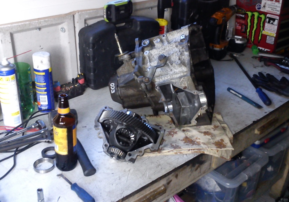

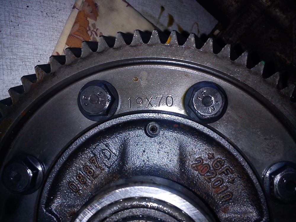

Anyway the "Eco" box I have isn't an ECO box even though I was told it was and paid the price because of this. But the crown wheel on the diff is clearly stamped with the wrong ratio and I counted the teeth to double check. Don't know if this is me being deliberately mislead or of the car it apparently came off has had a new box at some point. Not gonna get my money back either cos although I made sure I got a receipt (just in case something like this happened) it only says "206 HDi gearbox"
So anyway I know what I need to order off service box to be able to rebuild a standard final drive to the ECO spec and its probably cheaper and easier than finding another Eco box.

So here's the diff off the ECO box
And heres the proof its not the right ratio.

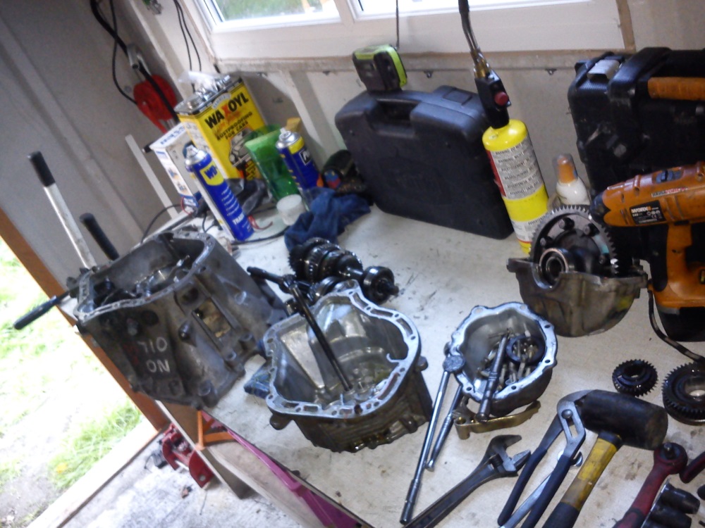

So I finished stripping the box, I used the nine inch to cut the nuts off the ends of the shafts and managed to pull 5th off then split the box in half and lots of bits fell out.

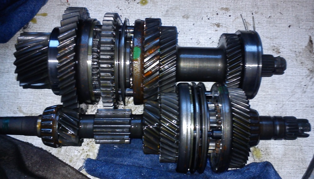

Heres the gears out the inside. From left (engine end) to right
Final drive (the one on its own), 1st, synchro, 2nd, 3rd and 4th with a gap where I f*cked 5th off to get it apart
And the resultant mess. The casing is going to become a wood burner or a BBQ once Ive smashed some more out of it.

Many hours i have spent in service box looking at 206 and 306 boxes mate. I know how many teeth every cog on every gear on any noteworthy box has.
