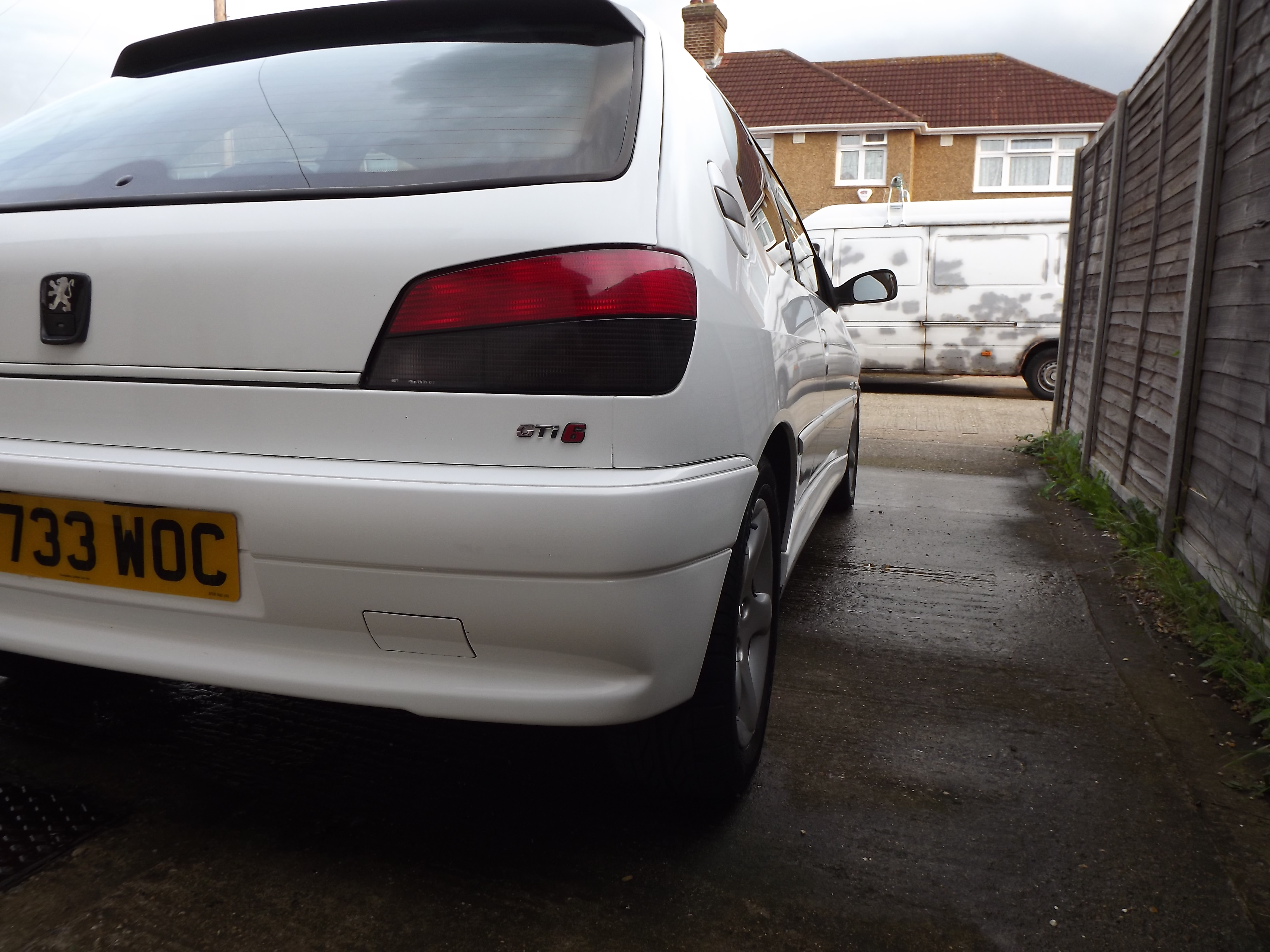

So erm Bianca GTi6, cost a grand ish. Picked it up on Friday.
I did fancy a rallye but i couldnt cope without electric windows and you lot would lynch me if i scrapped one of them. Spent a while looking for either a black or white car and found this one.
It sounds awesome with an induction kit and im getting about 20mpg. Dont need to change to 6th until 130mph. It is breathtakingly fast down a country road and feels faster than some of the other 6s I have been in / driven so Im hoping that means Ive got a good one.
Dont really know what more to say so heres some pics after a wash.
Looks nice man!
carefull parking next to that white van the spots might jump on your clean car!
looks nice in white Wink
Looks amazing but having owned a white car and now a black one they take a lot of looking after to keep looking nice - I do like it a lot though!
Looks good, waiting for the tread that starts: "I have a problem with my 6." followed by "new engine time".
Looks good though, there is a black rallye on eBay for £950 first one on to be registered apparently.
As said before beautiful buddy.
the decat thread makes more sense to everyone now lol!
so, are you enjoying 6 ownership? apart from the fuel pump ra*e of course lol!
Looks good mate :-) hope this one lasts a bit longer than most
I hate you Tongue lol, this is just sooooo porn, This is my ultimate 306 . Bianca gti InloveInloveInloveInloveInlove
Looks real tidy mate, never been played with, looks to even be at STD hight. were all bianca 6's R/S Reg never seen one on another plate?
Also am i aloud to ask what the plans are? And knowing you dum there are some big plans already in the pipe line
oh and mileage?
Gorgeous this mate; good find!
Bout time you saw the light buddy!!
Running the right fuel now boyo
Looks lush that does

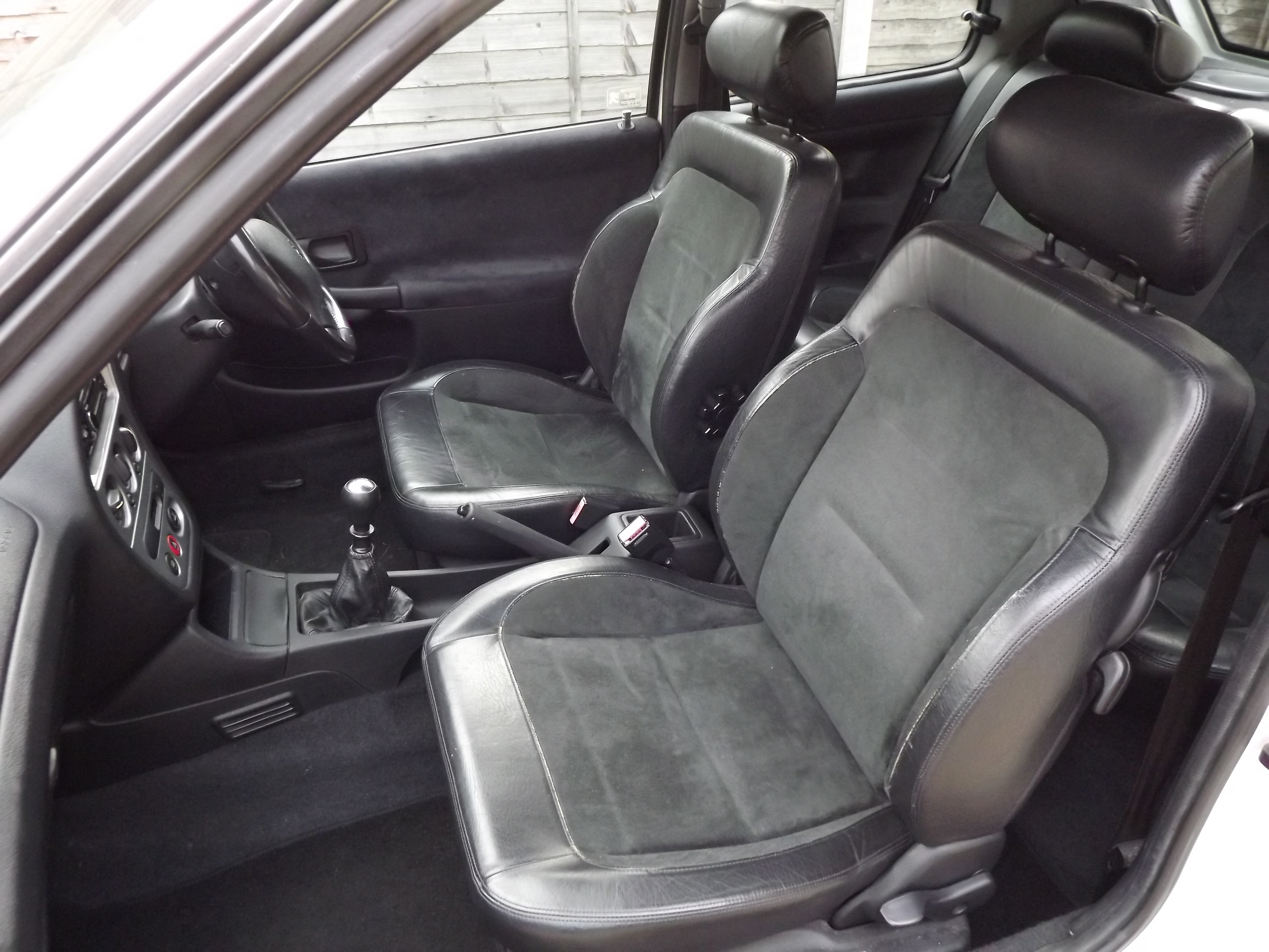

Good call bud, you'll certainly enjoy it as they are great even in standard.

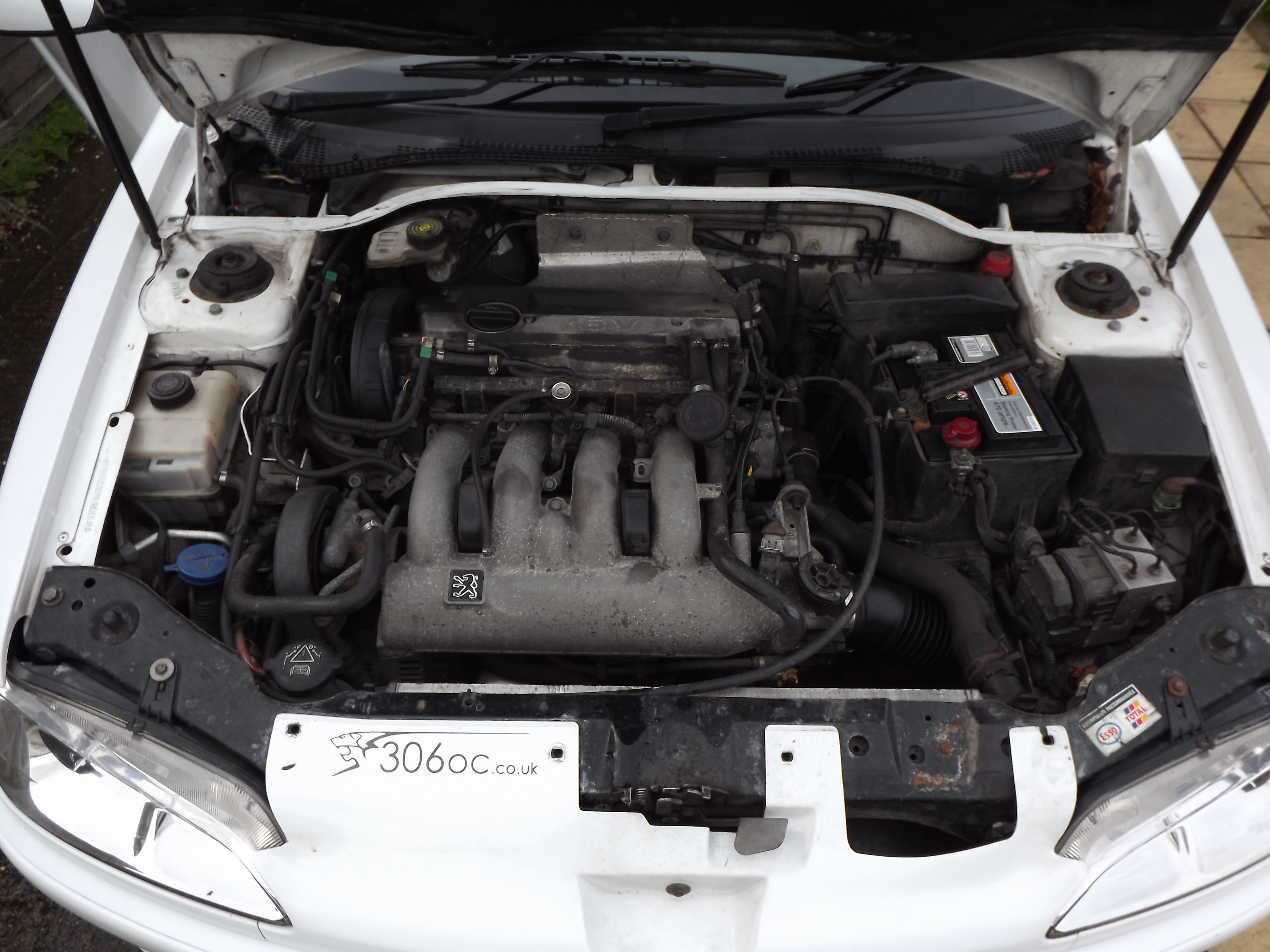

Can I hear tapping?

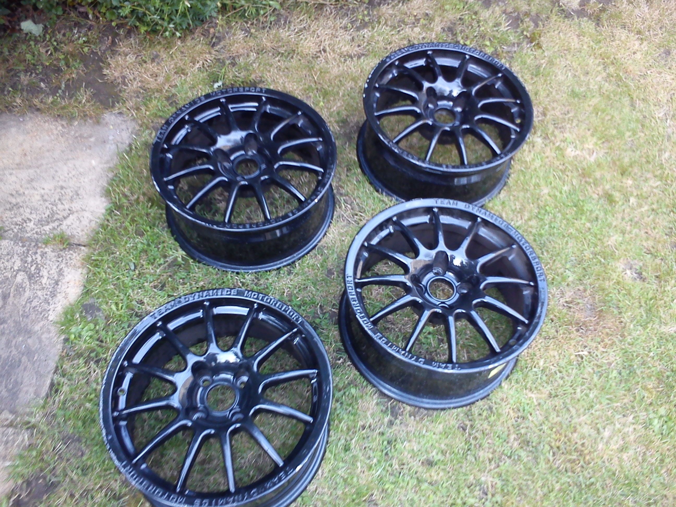

Oh and Ive bought some Team Dynamics Pro Race 1.2s in a 16" x 7" flavour and theyer getting done gold as gold on white is lush.

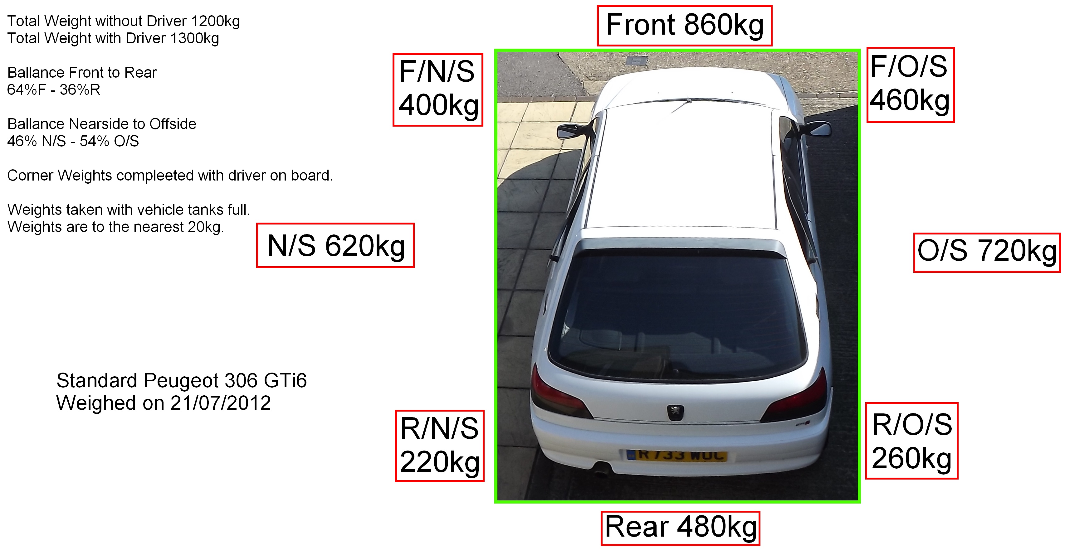

Ill do a full write up on what Im loosing and how much it weighs but Ive only done the back of the car and Im up to about 25kgs already.

(23-07-2012, 05:49 PM)Niall Wrote: Can I hear tapping?
Yes definitely and Im man enough to admit it.
However it might still be eds tapping your hearing and not mine.
60mm drop?? gold wheels???
big no no from me......
(23-07-2012, 06:19 PM)tsotd Wrote: 60mm drop?? gold wheels???
Really??
[Image: IMG_9757+copy.jpg]
Its just not a Scooby though is it? Lol
Bit I'm with you on this its different slightly and I thinking could just pull it off
Spend the money you'll save not doing the wheels gold on decent front suspension pweeeeeeeeeees!!
On a serious note, I'm very interested in the corner weight info etc you've got there, and how you're gonna reduce that.
Where'd you get it corner-weighed?
And finally, f*ck me 100kg extra with driver? 1st step in rallye-ifying it; rallye-ify yourself!! lmao I joke Tongue
(23-07-2012, 06:39 PM)Ed Doe Wrote: Spend the money you'll save not doing the wheels gold on decent front suspension pweeeeeeeeeees!!

Ed Ill call you about the weight but im gonna try and pretty scientific about it and eventually move some bits about to try and get a better balance. I reckon without my weight its gotta be pretty close to 50/50 side to side and that i wasnt expecting.
Oh and yes Im 100kg. Remember its not the size of your nail, its the hammer you bang it in with that counts.

I kinda feel uncomfortable using the term "corner weighting" as TBH what I did was a bit farmer spec and it shows.
My local tip has a weighbridge set into the ground and it is surrounded by flat level tarmac. After I had the whole car weighed I drove 1 wheel on at a time and had them weighed individually. It is to the nearest 20kg and this shows. The whole car was 1300kg with me in but the 4 corners add up to 1340kg. The thing about the weighbridge is theyve just had it re done and so itll be there for many years and so as a test it is totally repeatable. Also the Shell down the road where i filled the car with fuel will always be the same distance away so the fuel weight and that should be the same every time.
Its good enough for what Im doing and if you understand that its not perfect and that any weight could be 20kg either way and accept that then its an interesting tool and may give people here an understanding without paying a special rally company £££ to do it for you to the nearest micro gram.
I would love to see someone else do the same as me and Id also love to get the car properly corner weighted to see how far out all of this really is.

Chris the weigh bridge up in Wycombe has 4 individual pads you drive the car on! Might pop up and ask em what the deal is tomorow after work

You have made a mistake with reducing the corner weight by buying Brembo's they are pretty heavy calipers, and the discs you will have to use will make it even worse.
They are some interesting things on the 6 forum about corner weight.
Lighter wheels is a good start though.
