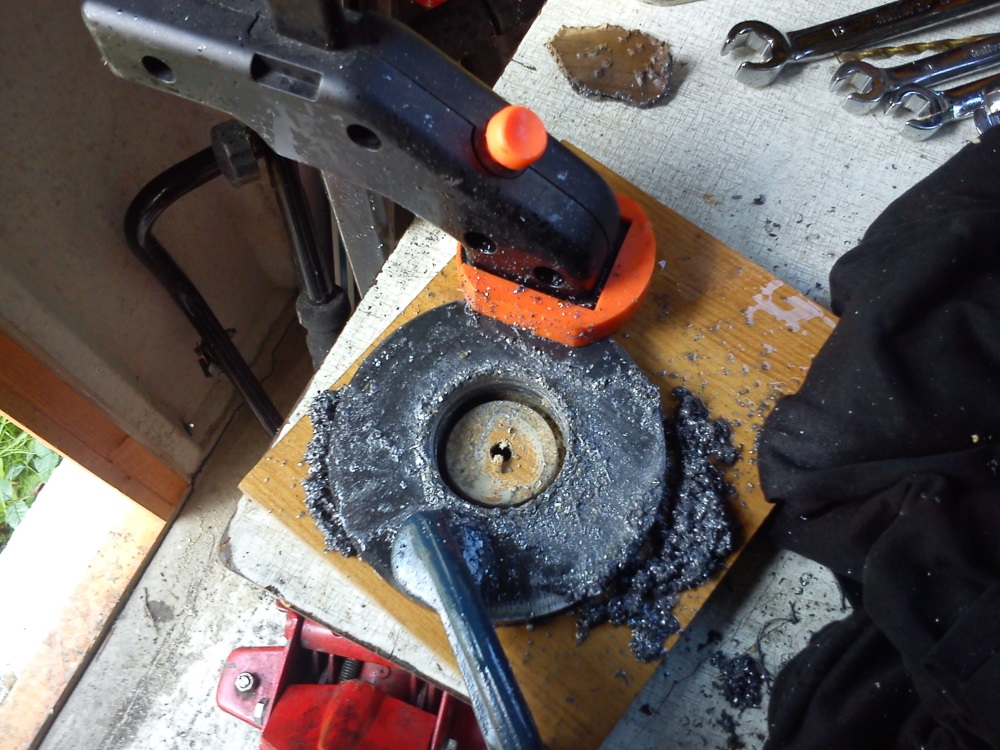

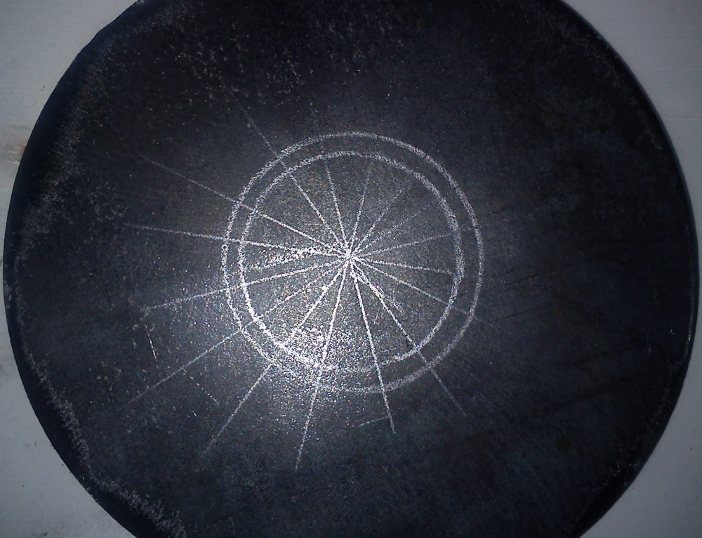

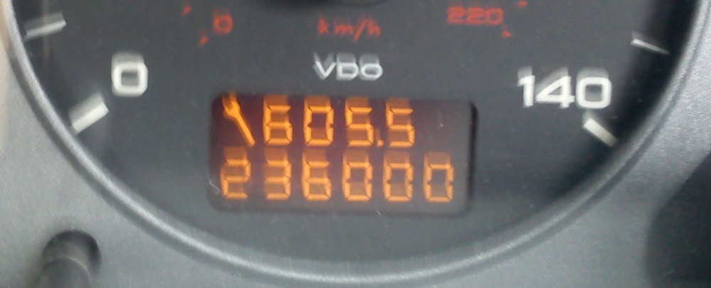

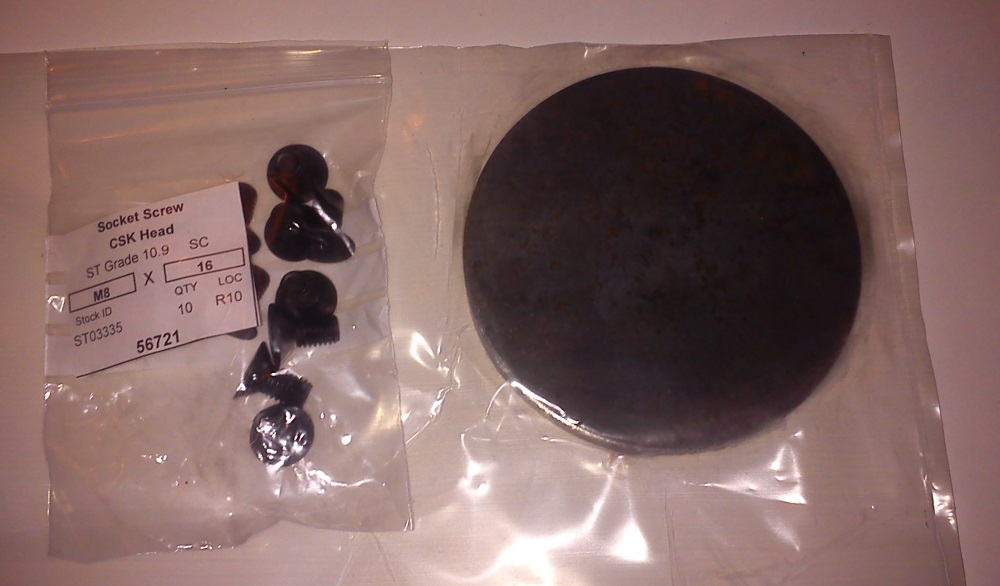

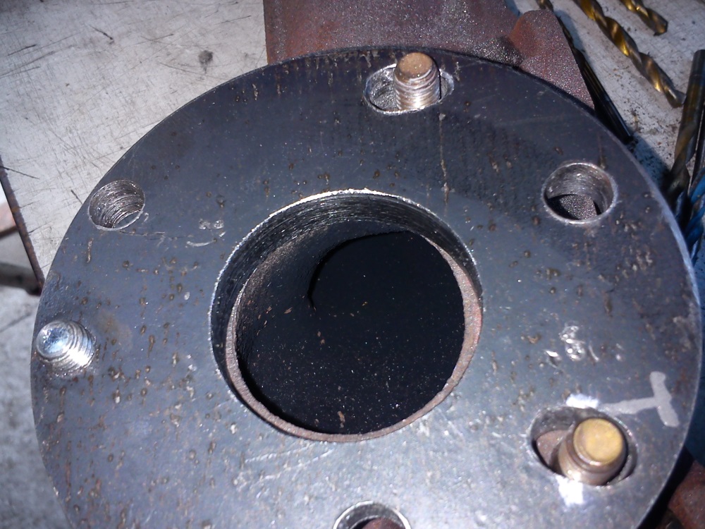

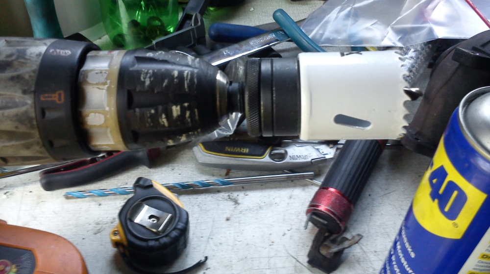

Sooooo, the car tipped over 236k the other day and shes still running (surprisingly)

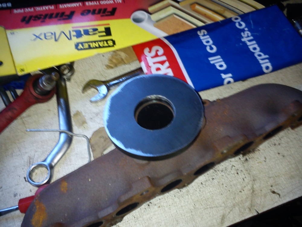

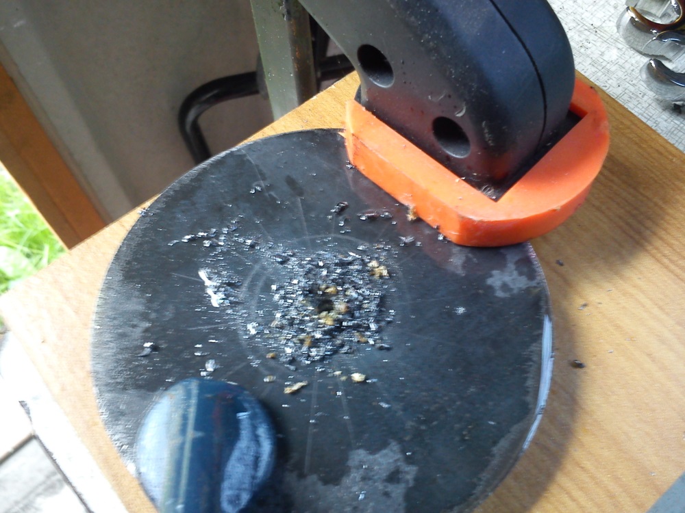

Got a 100mm x 10mm steel disc and some M8 countersunk bolts off ebay
Found the center, drew a 39mm circle (as thats the size of the hole on the manifold then marked it up for a ring of 16 6.5mm holes then drew a double cross for 16 holes where the lines intersected the inner circle.
I then decided that this is a stupid idea and bought a 40mm hole saw as puggy had used one to reasonable effect.
I drilled a pilot hole
Then drained a drill battery making the hole, kept blasting it with WD40 to try and keep it cool but it is a mission of a job even with a decent drill, really glad my drill has a switchable gearbox so I could run it slow enough.
Then I cleaned it up and slapped it on the manifold. Got the first couple of 8mm holes drilled to bolt the plate to the turbo but no pics of that.

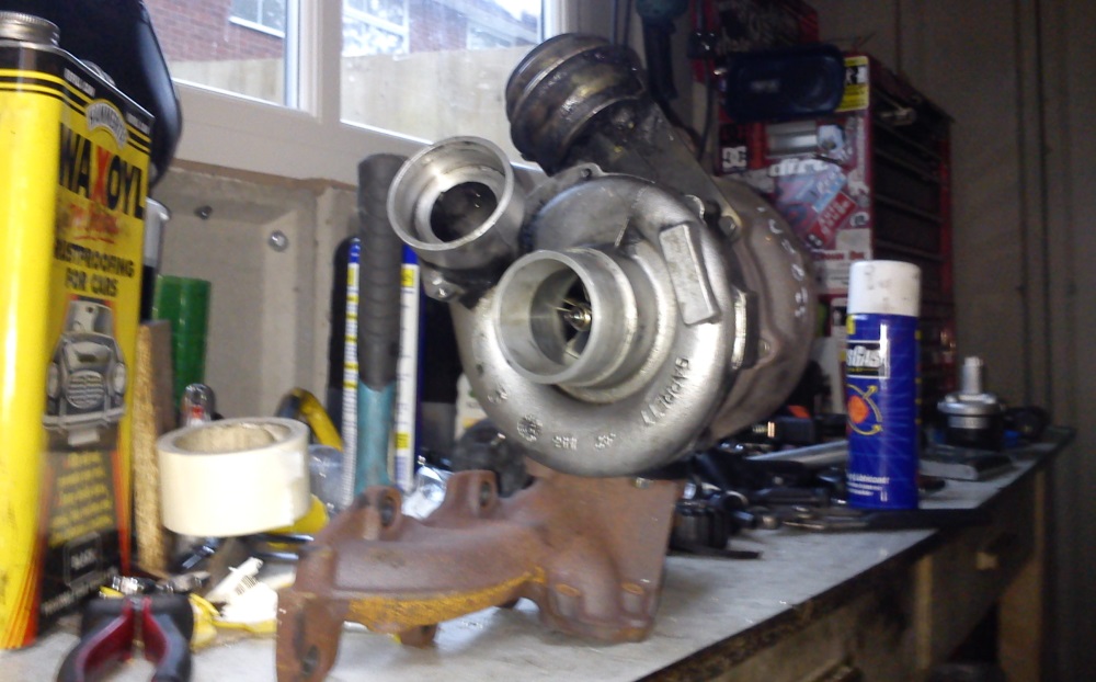

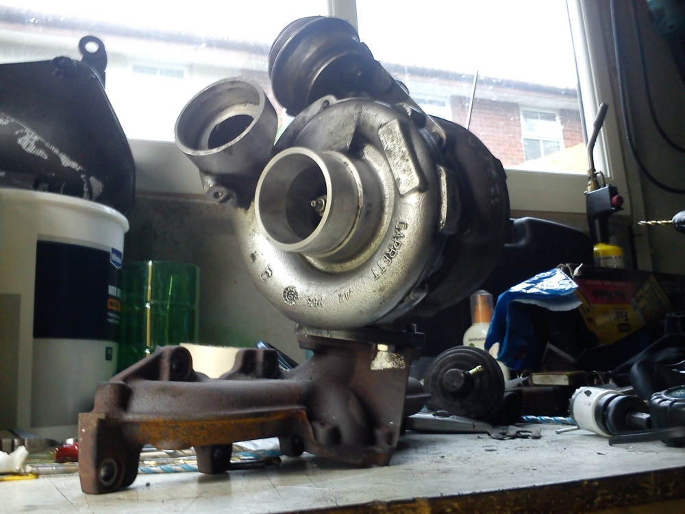

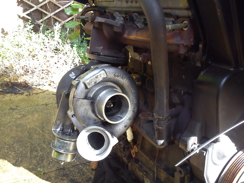

I took the turbo out and had a test fit and it is gonna be a bloody tight fit between the compressor housing and the plastic water rail. Hopefully I can get it screwed up high enough that it will give clearance but I need to get the plate mounted to the turbo properly and then holes drilled and tapped to attach it to the manifold.

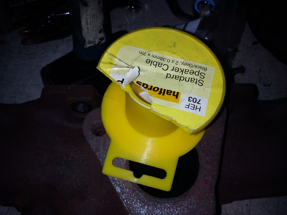

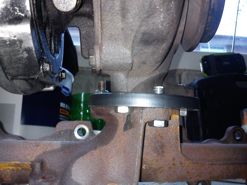

#38

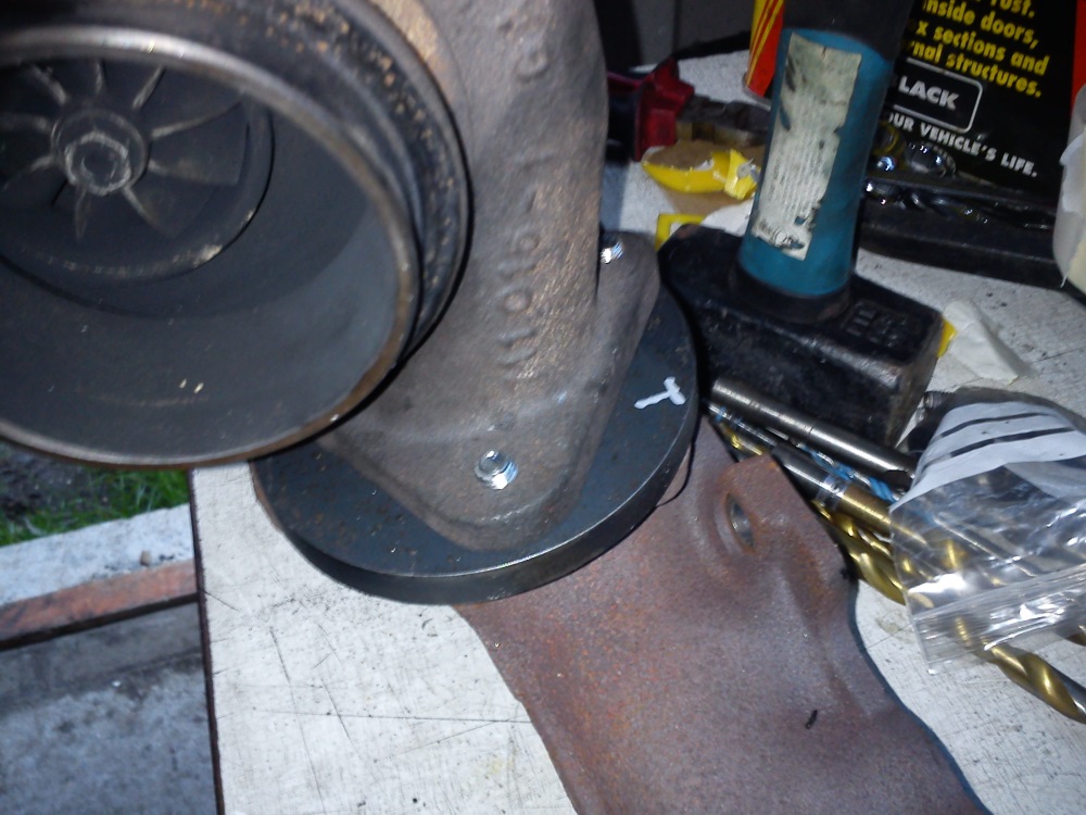

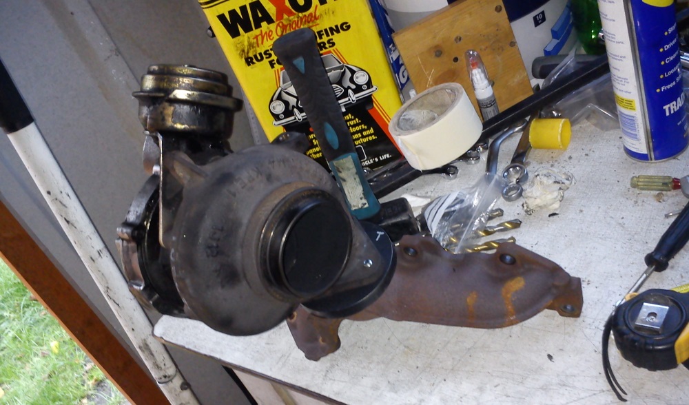

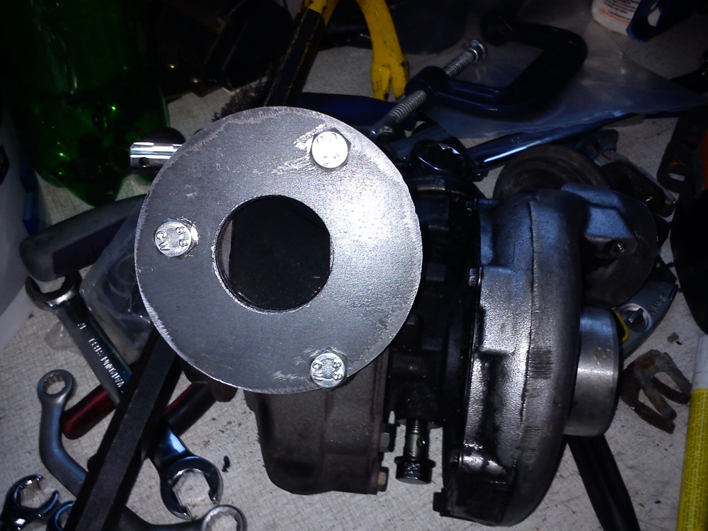

So plate drilled for the turbo holes and bolted up, the drum of a Halfords cable reel is almost the perfect size for lining up the flanges and adapter, found out that by sheer dumb luck the bolt heads clear the manifold flange and so have started marking out and drilling the holes for the manifold but both drill batteries are dead again so I might finish it tomorrow.
#39
looks a good start...though is it going to clear?
#40
Good progress there matey!
#41
(01-10-2013, 03:58 PM)mr_fish Wrote: looks a good start...though is it going to clear?
Gonna be close on the engine and the bulkhead is gonna need some work but the honest answer is I don't know.

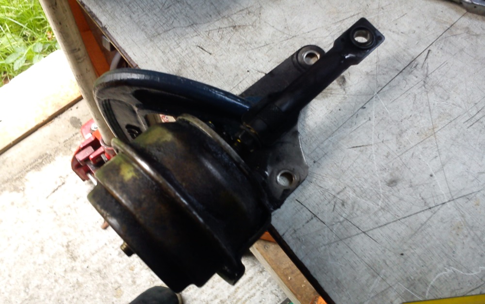

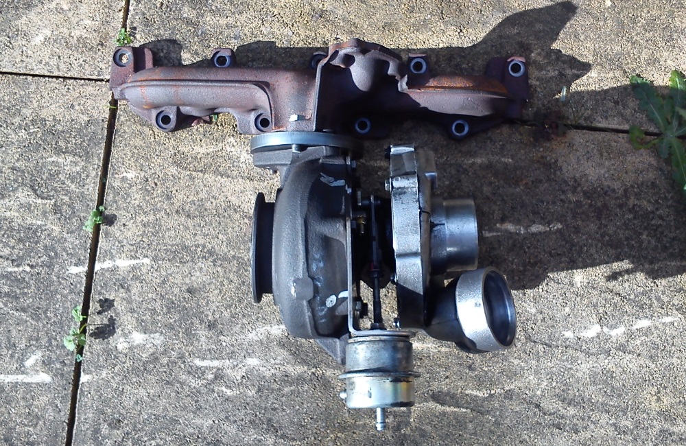

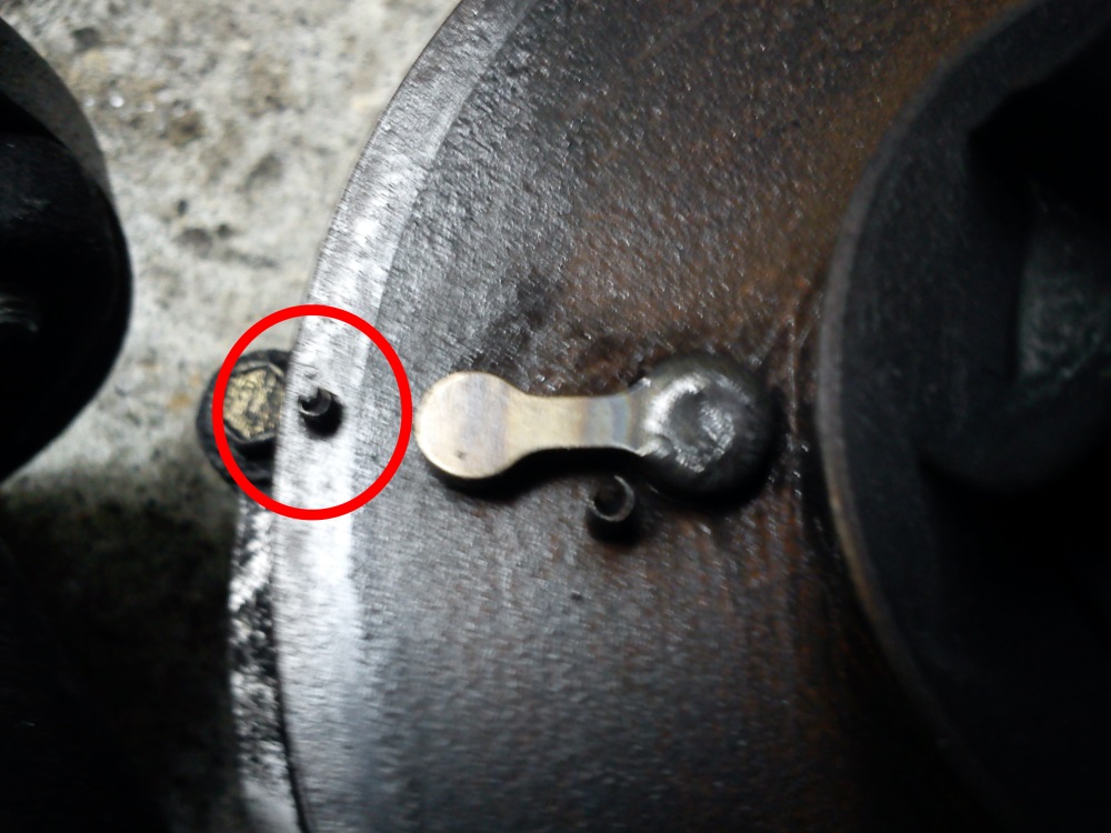

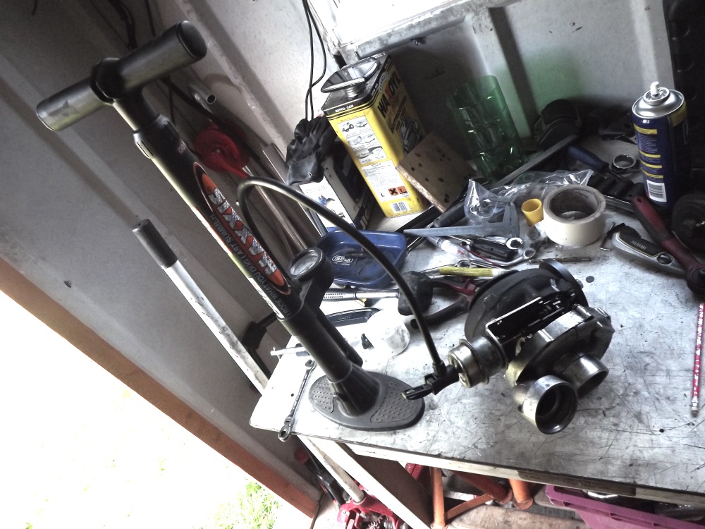

Getting there with the turbo, finished the adaptor plate, the slotted holes for the manifold studs might end up getting slotted further to twist the turbo and bring the cold side away from the water rail at the back of the engine. I should really of test fitted it on the engine before taking it apart.

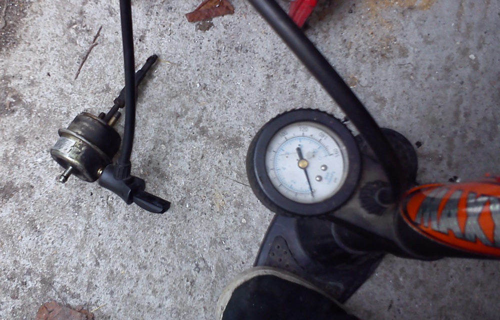

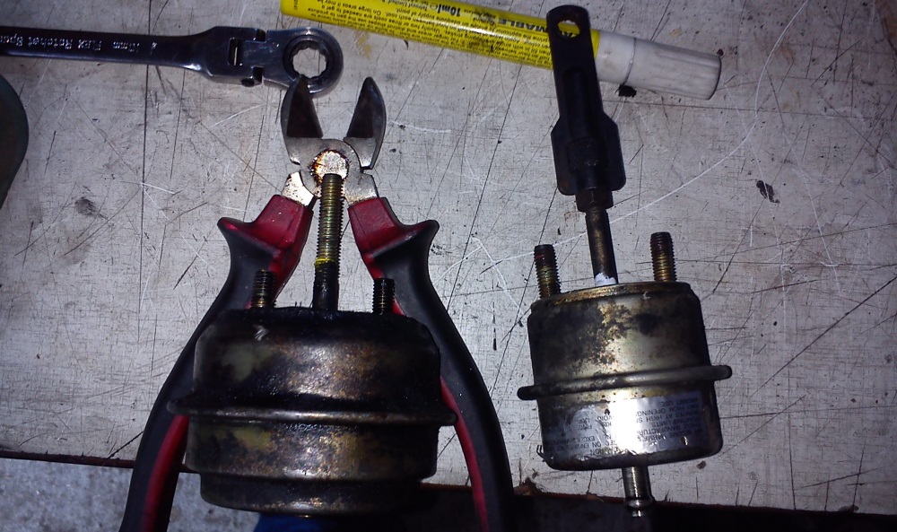

Took the vacuum actuator off the turbo after measuring its travel (11mm from the stop to fully open). Had to clamp it to the desk to get some of the nuts undone but got the old actuator disassembled and then went through my box of turbo bits and found a boost actuator to play with. Sadly its got 2 boost inlets but tested it using a track pump and its got a good 20mm of movement at full travel but that isn't till about 40psi. It does 11mm at about 15psi which is nearly perfect. The new actuator is alot smaller so I'm considering weather to use the heat shield off the old actuator or keep it off to save space.

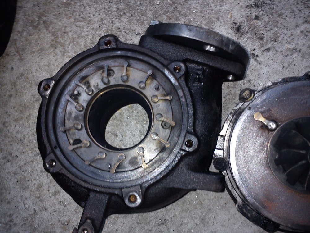

Finally took the turbo apart and cleaned some of the soot out the VNT mechanism. Was well stuck together and when i finally knocked the hot side off the CHRA it dropped to the floor and I nearly lost one of the bushings that the vane control ring rotates on. Anyway had to pull the little locating pin circled but had no luck so ended up filing it flat.
There is 13 flaps in the ring and I wanted to clock it 2 flaps but had to go 3 as otherwise the control lever would drop onto one of the bushings.
Been really grateful for having a tap and die set today, been worth its weight in gold. Cleaned up all the turbo and manifold holes and knocked loads of rust out of them, taped a fresh hole in the adapter and cleaned up the very tight thread on the new actuator.

I'd be tempted to keep the heat shield, but suppose you can sack it off as you'll have additional air gap
As long as the boost can move the lever from stop to fully open you're onto a good 'un, 15psi sounds good as a minimum boost pressure Smile
Won't it be a pita if the turbo is on a jolly angle?

(03-10-2013, 08:22 PM)zx_volcane Wrote: I'd be tempted to keep the heat shield, but suppose you can sack it off as you'll have additional air gap
The actuator actually starts moving at about 4psi but reaches the required 11mm at about 15psi. Its not at its full 20mm+ extension till 40psi
The turbo is angled with the cold side nearer the engine than the hot side like the standard turbos are but I think I need to run it parallel to clear the water rail. I suppose parallel it'll also make it easier to do the exhaust.
The actuator is probably going to be at quite an angle under the car from clocking the housings so the worry is drive shaft and intercooler pipe clearance.

(03-10-2013, 09:01 PM)Dum-Dum Wrote: The actuator actually starts moving at about 4psi but reaches the required 11mm at about 15psi. Its not at its full 20mm+ extension till 40psi
You going to be using a mbc to control though right? So the actuator won't see anything until whatever target boost you set on that, and then as long as mbc is min 15 psi, bam vanes wide open.
Nah I'm going to be using an electronic boost controller but I'm tempted to see If i can actually set it up without so it actually utilises the actuator creep so it doesn't just whack the vanes open and closed suddenly. Might even see if I can run it without a controller

My one bit of advice - don't use an electronic boost controller, they're simply too slow for a VNT - you'll get chronic overboost/underboost situations, it's mostly when you come off the throttle at ~3k and go back on, it'll go absolutely insane with overboost/underbooost as it tries to settle it...
And yeah, you really want a bleed valve for the smoothest progressive increase in boost... I've found that even simply having pipes too long with the target pressure at 20psi will see 80psi EMP and spike to 30psi inlet...
#56
(04-10-2013, 10:29 AM)Ruan Wrote: My one bit of advice - don't use an electronic boost controller, they're simply too slow for a VNT - you'll get chronic overboost/underboost situations, it's mostly when you come off the throttle at ~3k and go back on, it'll go absolutely insane with overboost/underbooost as it tries to settle it...
Yeah one of my jobs for today is to go out and play with the control and see what I can do seeing as I can play with it on the bench before fitting it to the car.

Just make sure all the angles are right and that it isn't just going to jam up and get stuck...
And make sure you put the can on the right way round, so it's up against the screw stop Wink

(04-10-2013, 10:42 AM)Ruan Wrote: Just make sure all the angles are right and that it isn't just going to jam up and get stuck...
All tested and working. Actuator is a piece of piss as it goes in the bracket for the original actuator.
Did I read that right, a bleed valve!?
Yep because of the way it leaks out pressure it can allow the actuator to gradually open and close rather than whacking it straight open and straight closed again which with vanes rather than a waste gate will cause huge surge issues.

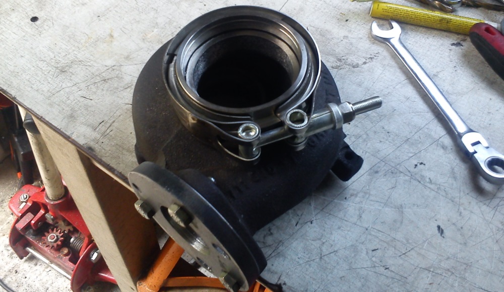

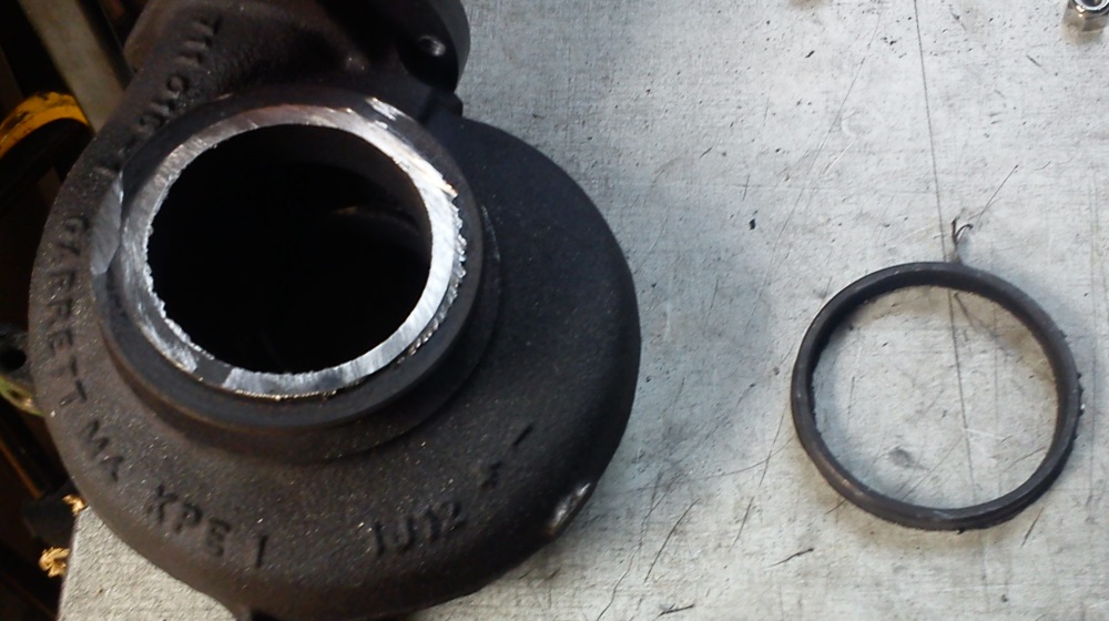

So todays progress.
To be able to slot a 3" pipe inside the V-band clamp lip I needed to cut the lip off the turbo, out came my favourite toy, Mr nine inch grinder and made short work of it. I left about 1mm of lip as the V band sits on this and it helps to make a good seal. I filed it all off smooth and flat too obviously.
I then put the turbo back together after very carefully marking exactly where the housing should sit in its new position (I can explain to anyone planning the same how to do this but its a bit long so wont post unless its wanted) and then fitted up the boost actuator and wound the stop back a mm or 2 as the turbo is off a much bigger engine and I want it to spool. I hooked the actuator up to a pump with a known good gauge and set about testing for the right position for the actuator rod.
At 10psi It starts to move maybe 2-3mm
at 15psi its maybe 6mm across
at 20psi its its about 9-11mm over
at 25psi its on the far end of its travel at about 13-14mm
I dont think I'm going to see the far end of the travel as the turbo is off a 3.2l engine and is capable of over 300bhp so I don't think Im likely to make that amount of flow through it.
I then took the whole lot out and test fitted it, there was no way it was going on so Ive drilled some new holes and rotated it about 10-15* and its now a much better fit.
