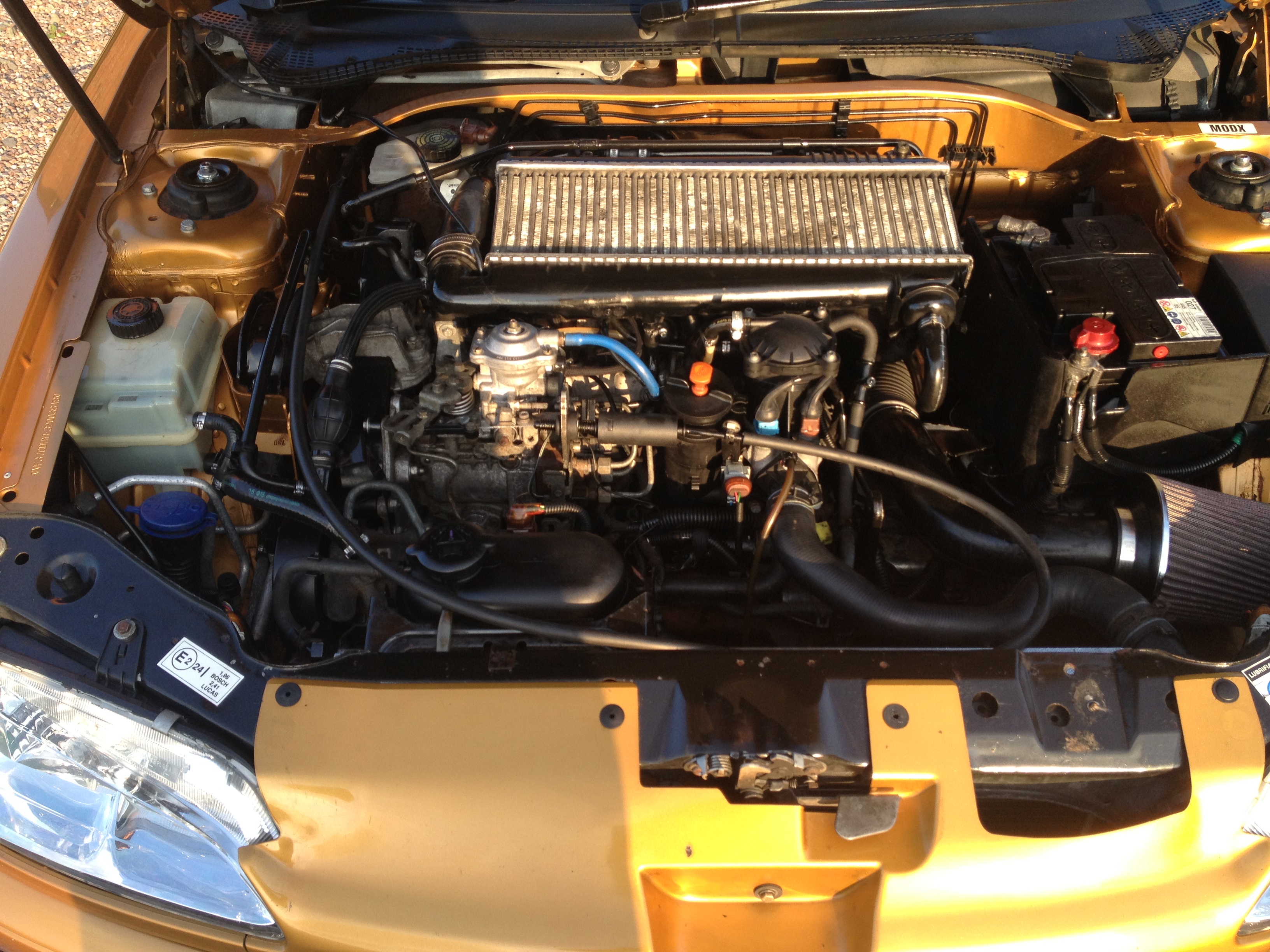

Thanks mate Smile it definitely has more torque, well it feels that way, dyno suggests that too, went from 170 ft lbs when on tmic to 204 ft lbs on the fmic, although i think that is because when i put the fmic on the smoke cleared up a lot due to the air being colder so the fuel was getting burnt easier? so obviously i could add a bit more fuel in until i was back to a slight haze on boost again, seems to just have more 'grunt' all round with the fmic, can also hear it 'chatter' on gear changes now, not good but hey ho Smile

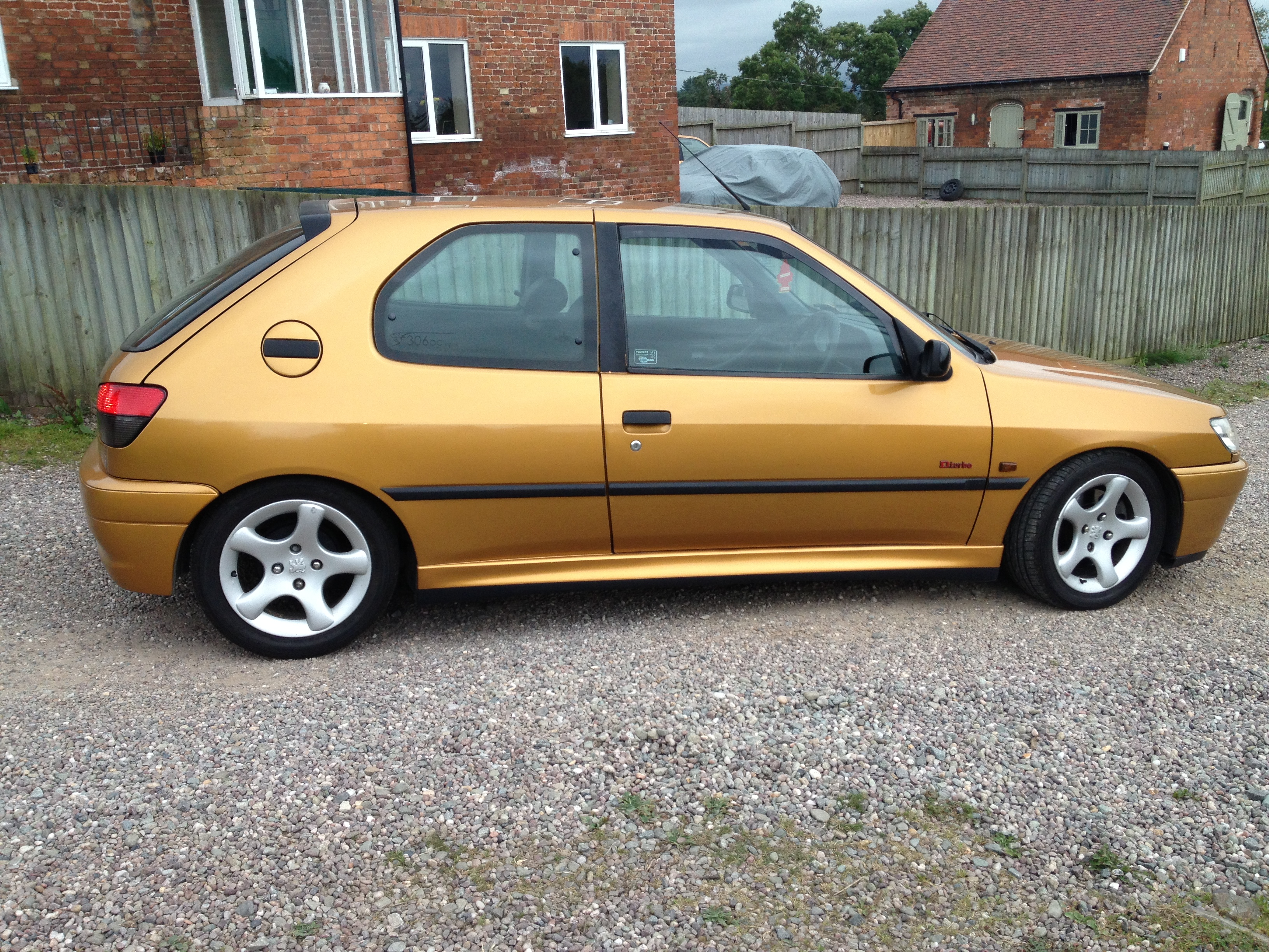

Gave it a good clean and put the black plastic rub strips on as personally i think they suit the car more? Smile
not far of ready for fcs now, need to sort out mirror caps and get a fan of some sort rigged up! Smile

The tmic is now back on, the fmic was causing the pedals to vibrate alot, due to me using the standard tmic pipe, also not really seeing the need for it, made the car slighty more laggy, goes just a well on tmic in my opinion, fmic kit is for sale, 80 pounds, including 406 inlet manifold, can bring to fcs Smile
Got some black mirror caps to replace the paint peeling blaze ones, seem to suit the car better as the bump strips are black and the bottom half of the side skirts

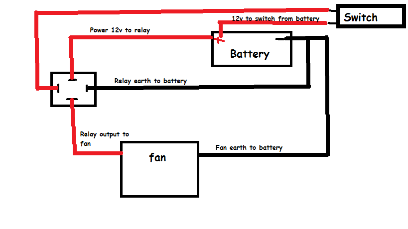

Also wired up a 12" fan when i took the fmic off, as the standard ones had a mind of there own, i used a 4 pin relay, the one out of the standard fans, i presume this is okay? connected it to a switch which i have placed in the small ashtray thing behind the the handbrake, also tried to hide all the wires in the existing looms as best as i could
temporary position for the relay, all wires are now taped up
rough paint diagram of how i wired it up, there is a 15 amp fuse in the wire from the battery to the relay, can anyone tell me if this is correct? Smile

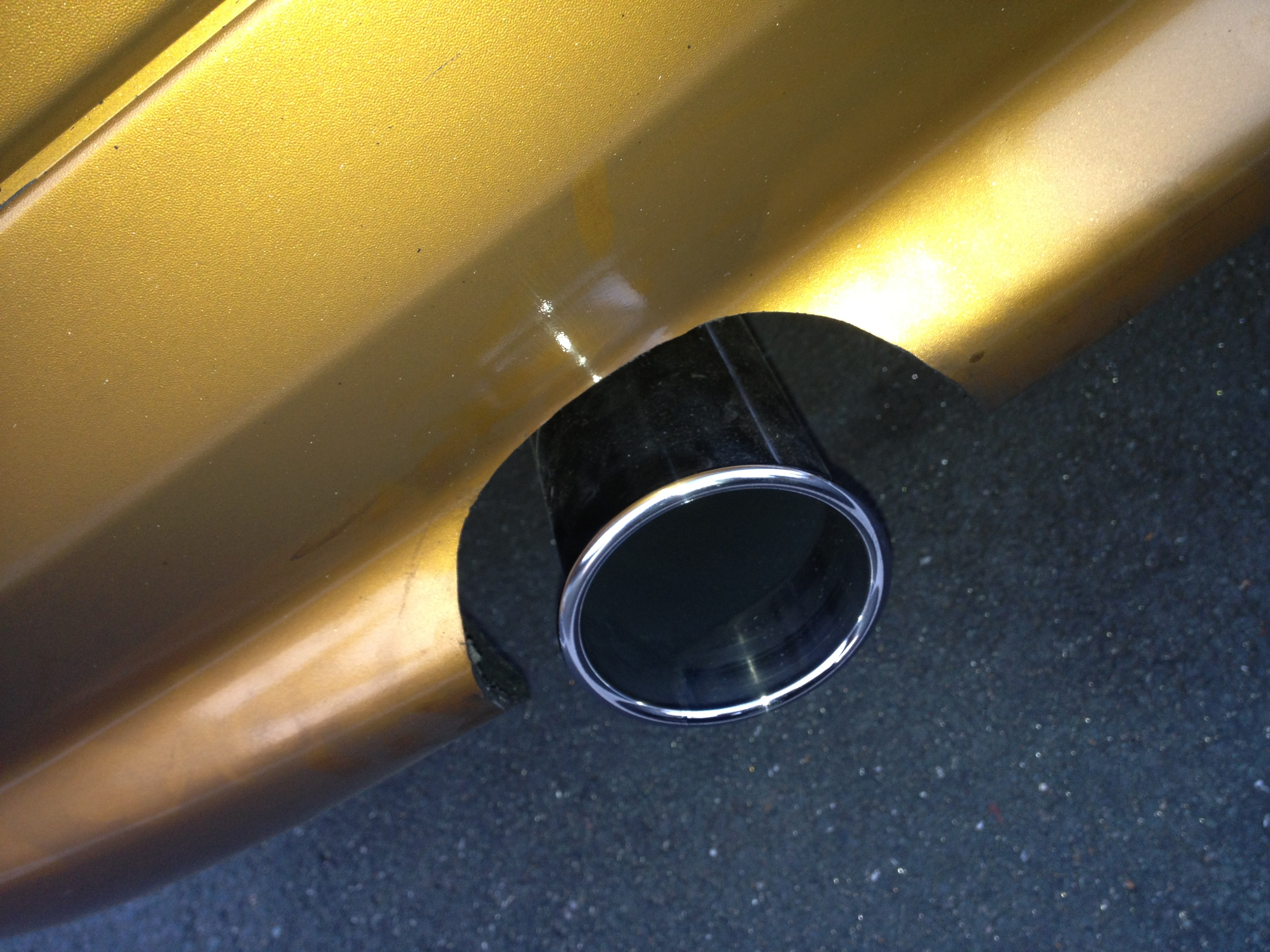

Going to have a straight through 2 1/4 inch pipe to a 3 inch tip made tomorrow, at aa silencers in stafford, 86 pound plus the vat, they do a really good job, cannot wait! Smile

had the exhaust made, quite happy with it, can still drive it pretty quietly too

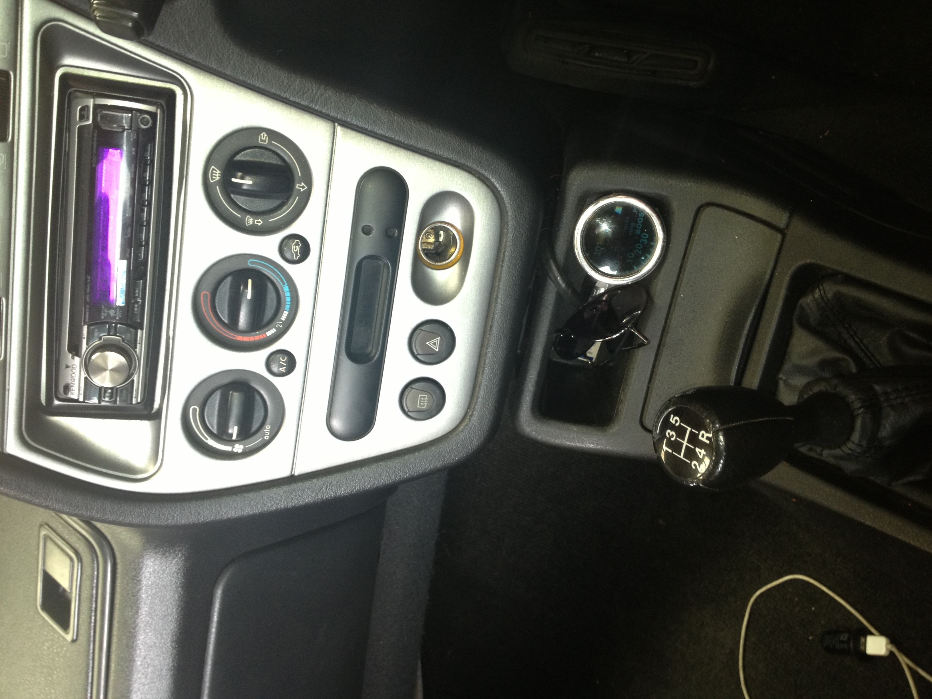

Also swapped the center dash pieces and the gear knob over from the other blaze which im breaking, gear knob is from a citroen zx

nice tailpipe.

what diameter?? and where was the tip from? looks sweet and sleeper all at same time!
#52
Cheers! 2.25 and the tip is 3 inch, all got made at AA silencers in stafford

Was advised at FCS to get rid of the standard inlet pipe that goes around by the master cylinder by Ruan due to how restrictive/small diameter it is, cant believe its made such a difference, got hold of some 2.25 industrial hoover pipe and a custom made pipe from ash23 to replace the bit that goes round by the master cylinder
Recommend this to all xud owners Smile
