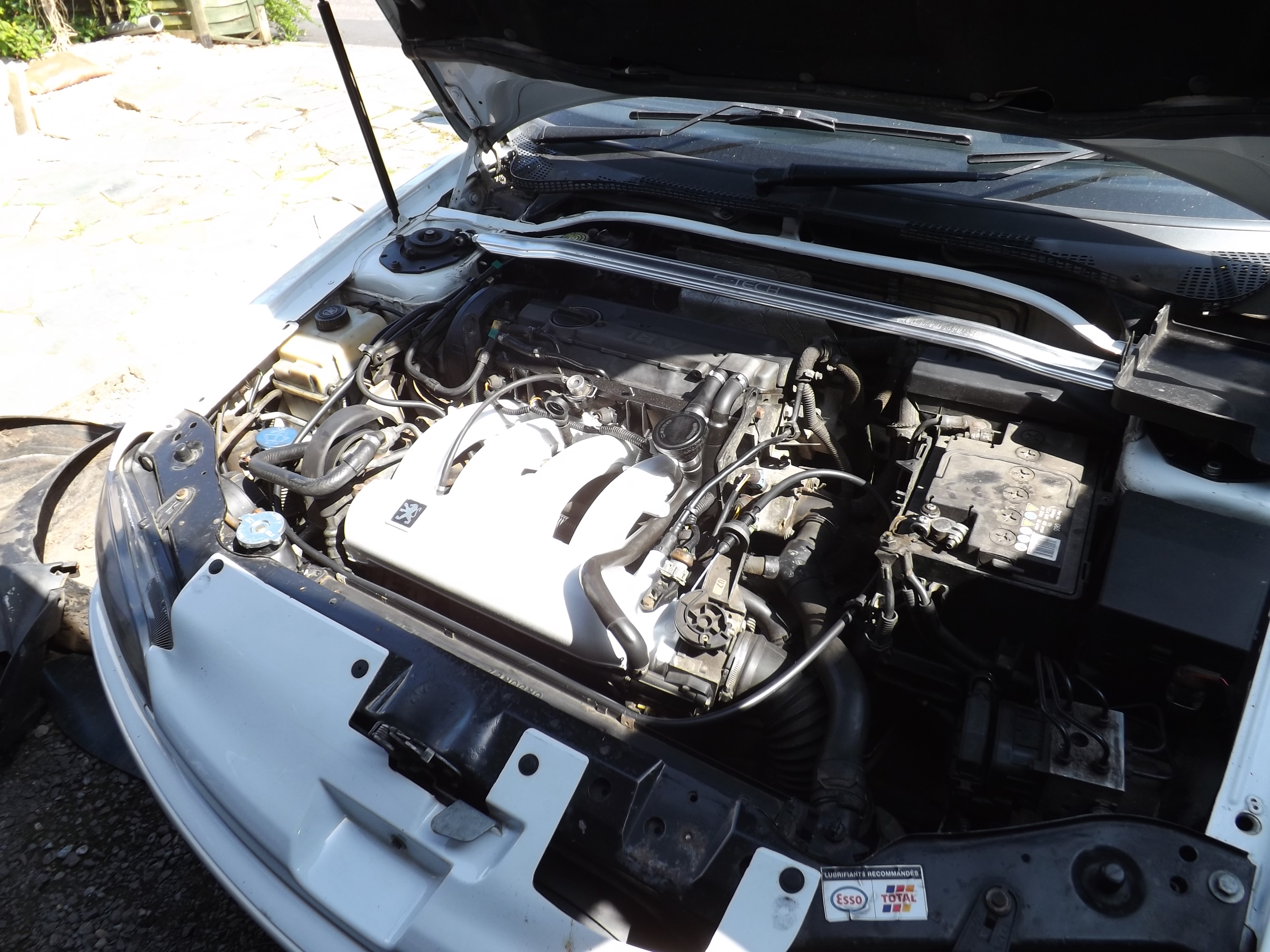

looks good paul, needs the pug badge back on the fannymould, its looks a bit plan without it
i do have the badge but left it in work Wink
Looks clinical ha
deffinetly brightens up the engine bay nicely Smile doing the same to the engine covers
(27-05-2013, 08:18 PM)sam Wrote: deffinetly brightens up the engine bay nicely Smile doing the same to the engine covers
This
Best buy yourself a good duster lol
Looks fresh pre-driven though Wink

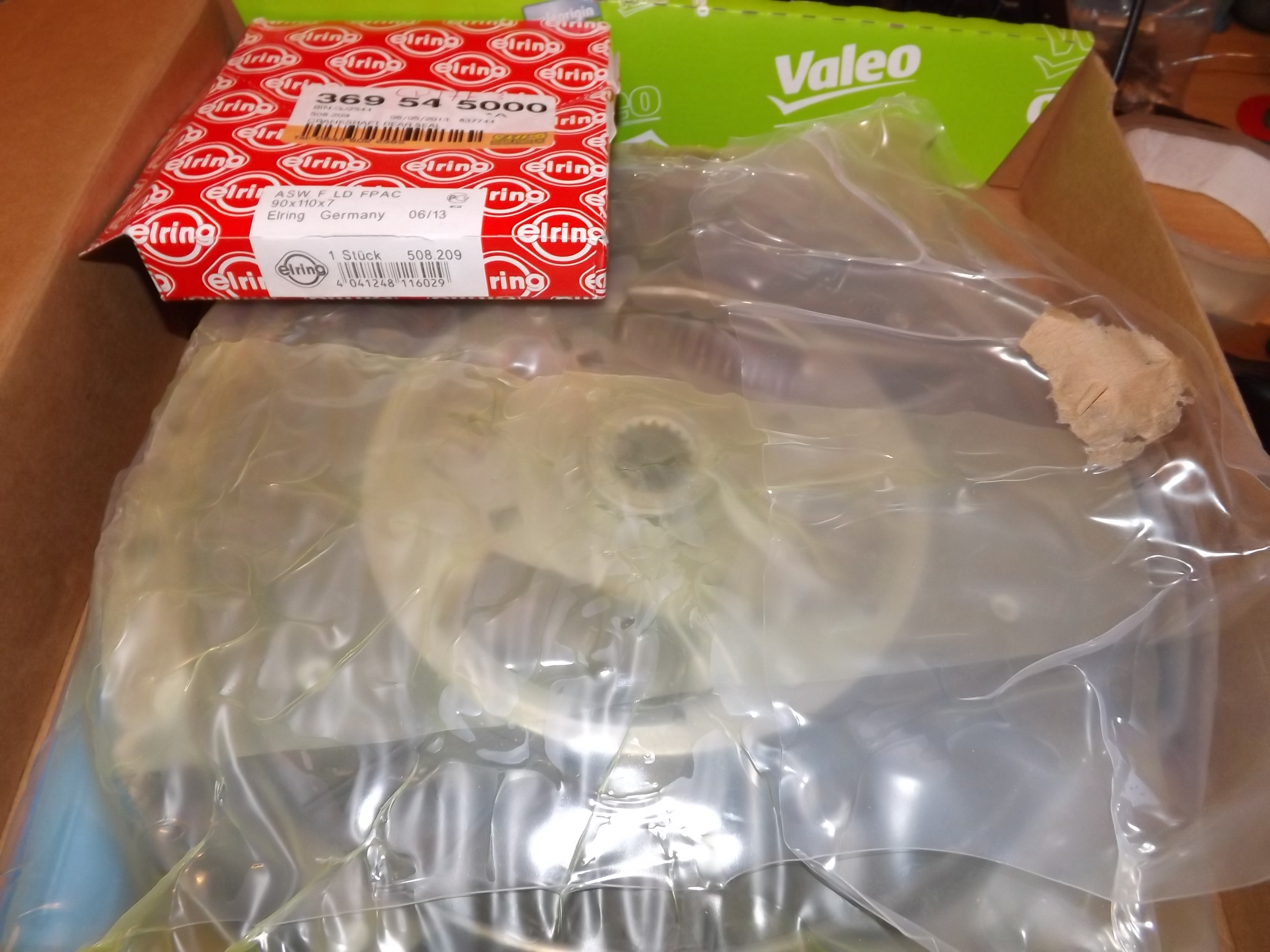

i have a nice new clutch and crank seal that needs fitting Big Grin

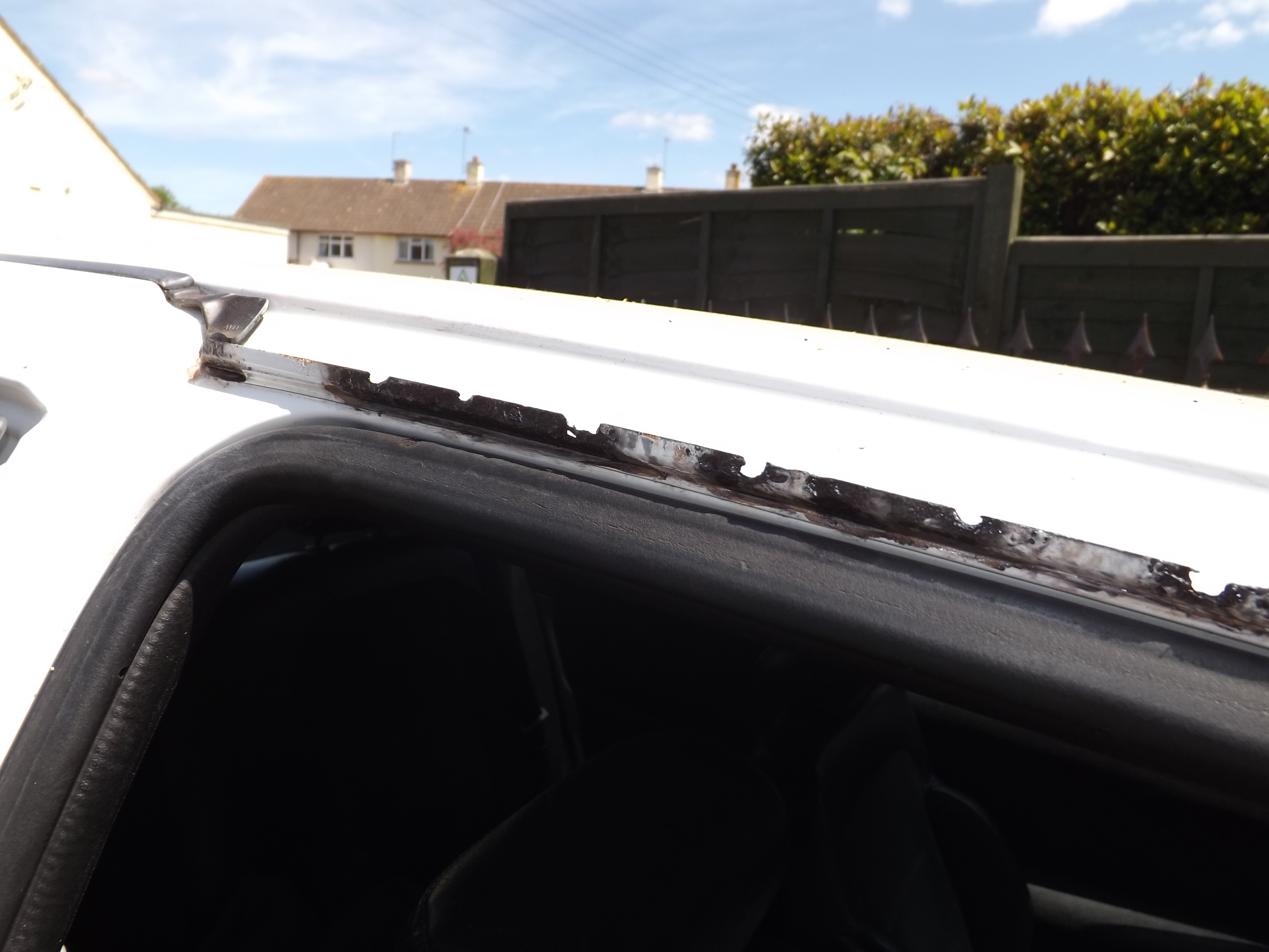

at the moment im attacking some rust on the gutter above the drivers door,
so get that undercontrol before theres a hole in the roof
dremmel with a wire brush some kurust and some paint will sort that as its under the gutter rubber

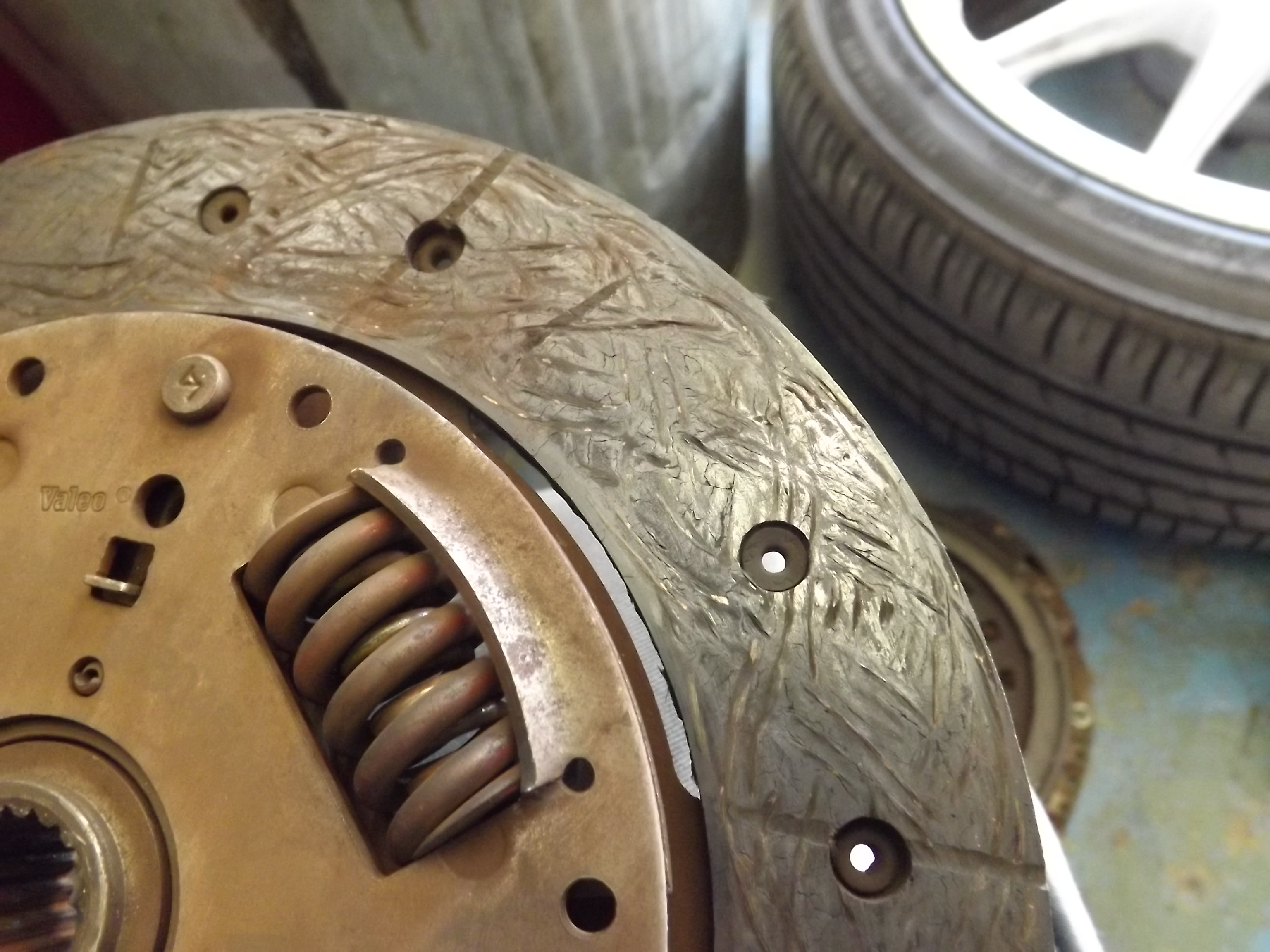

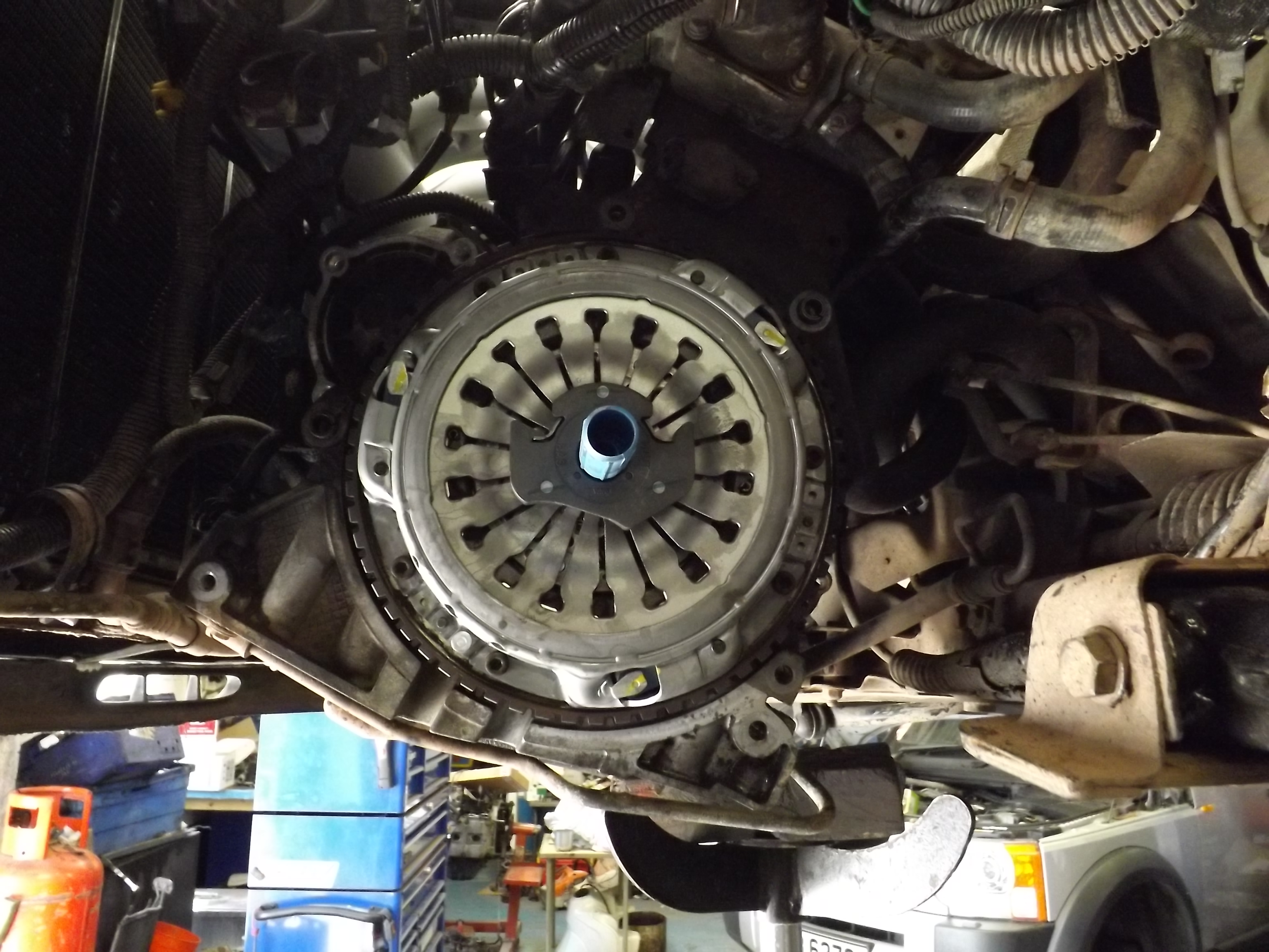

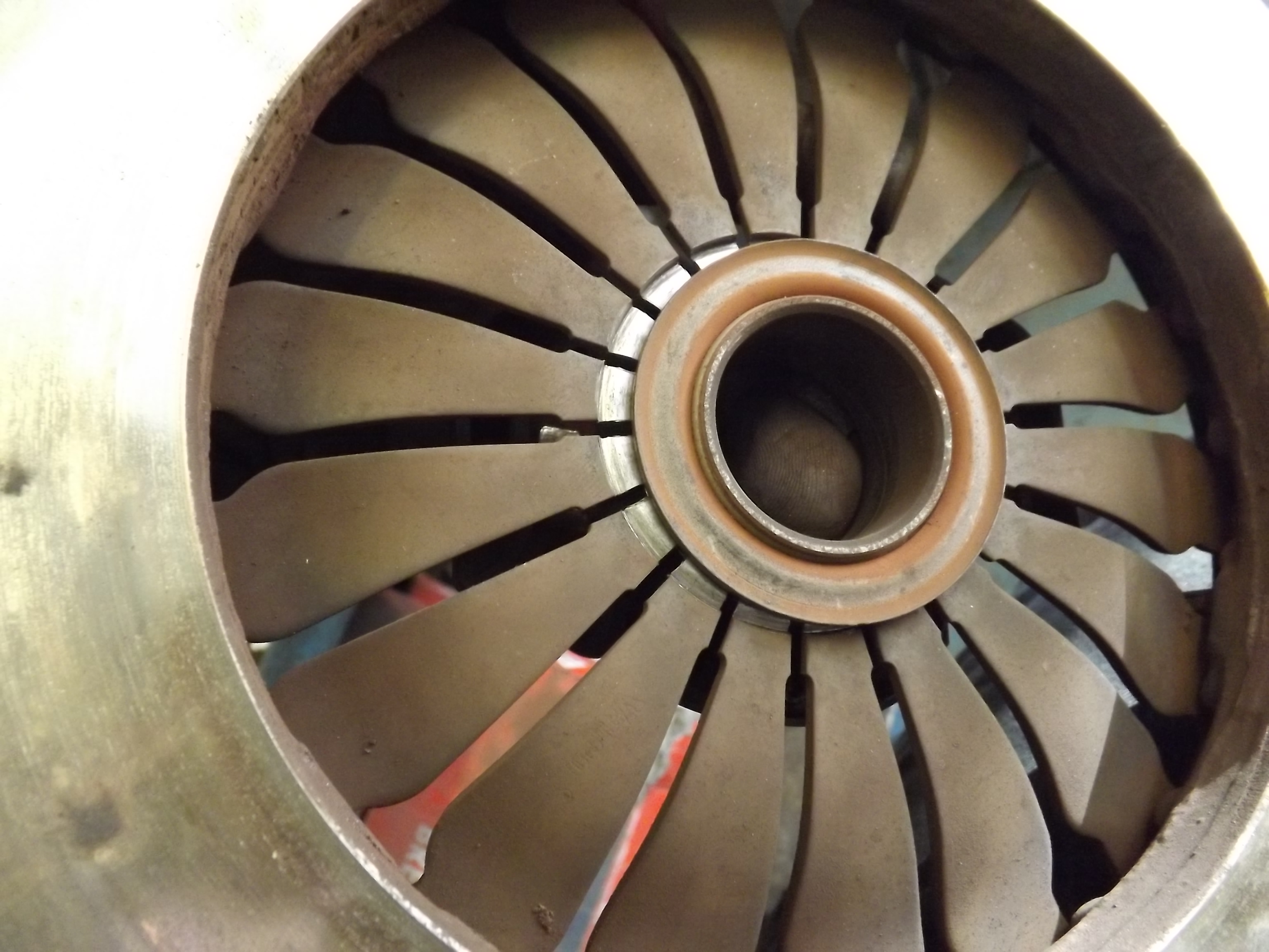

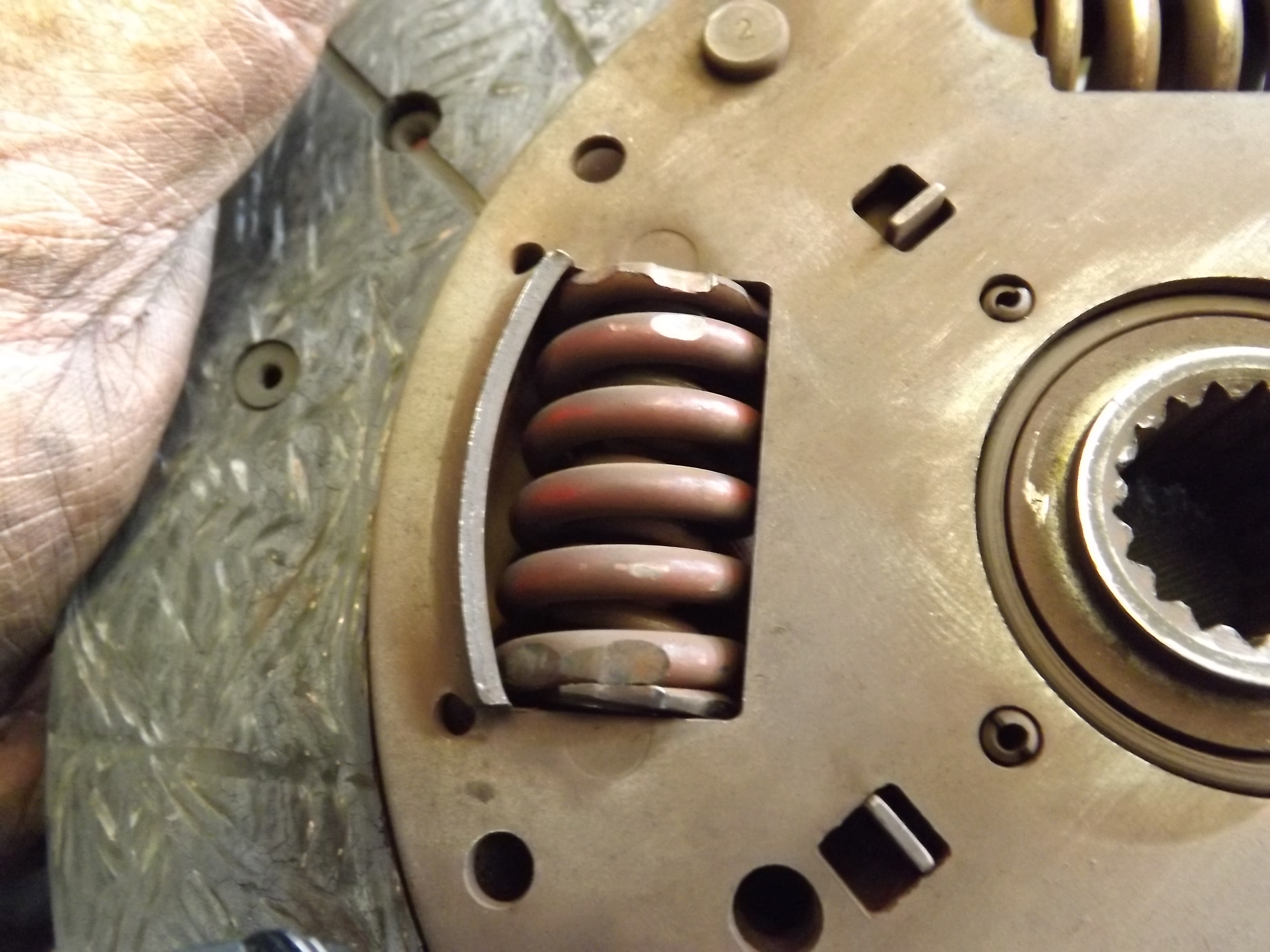

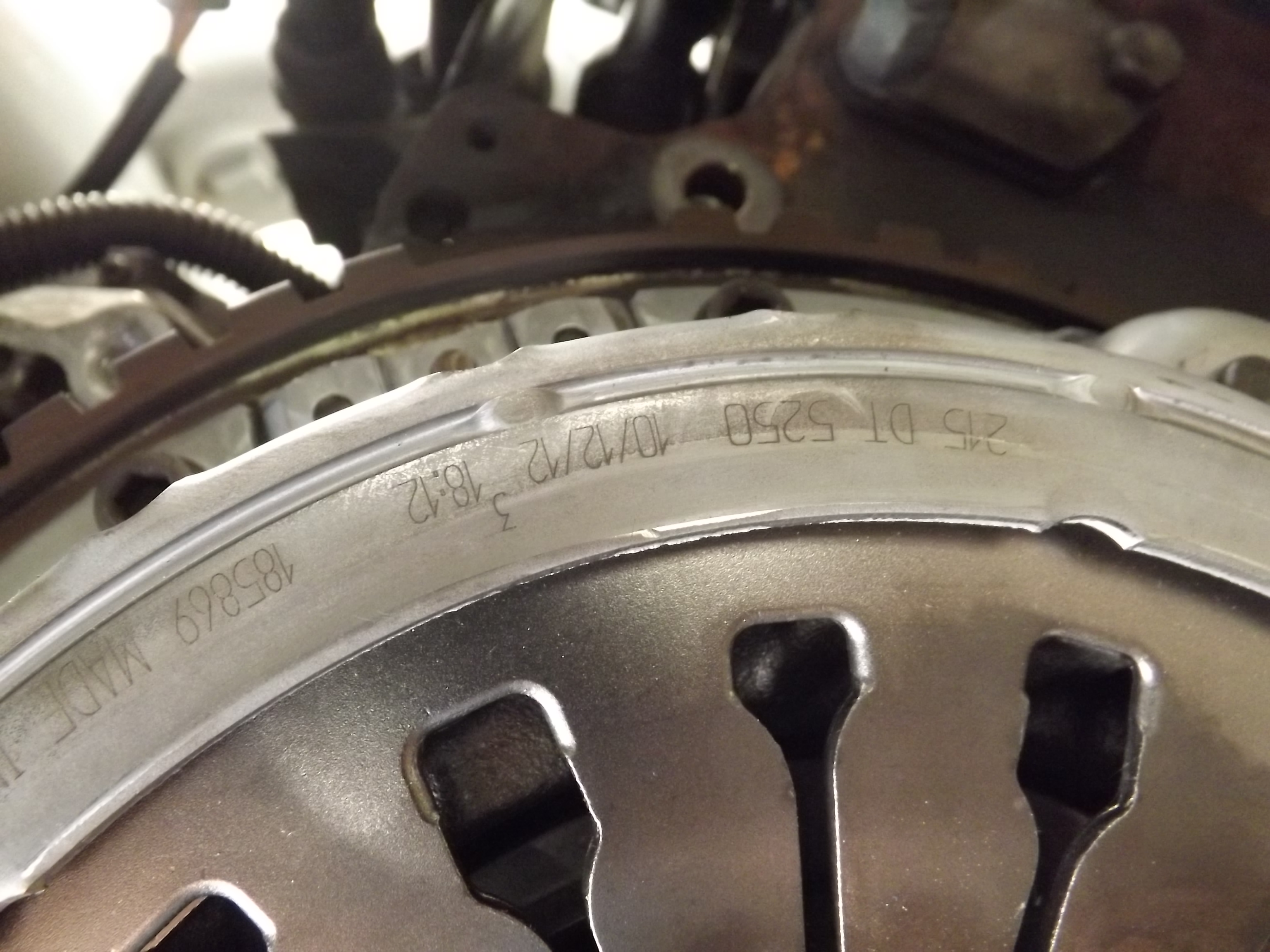

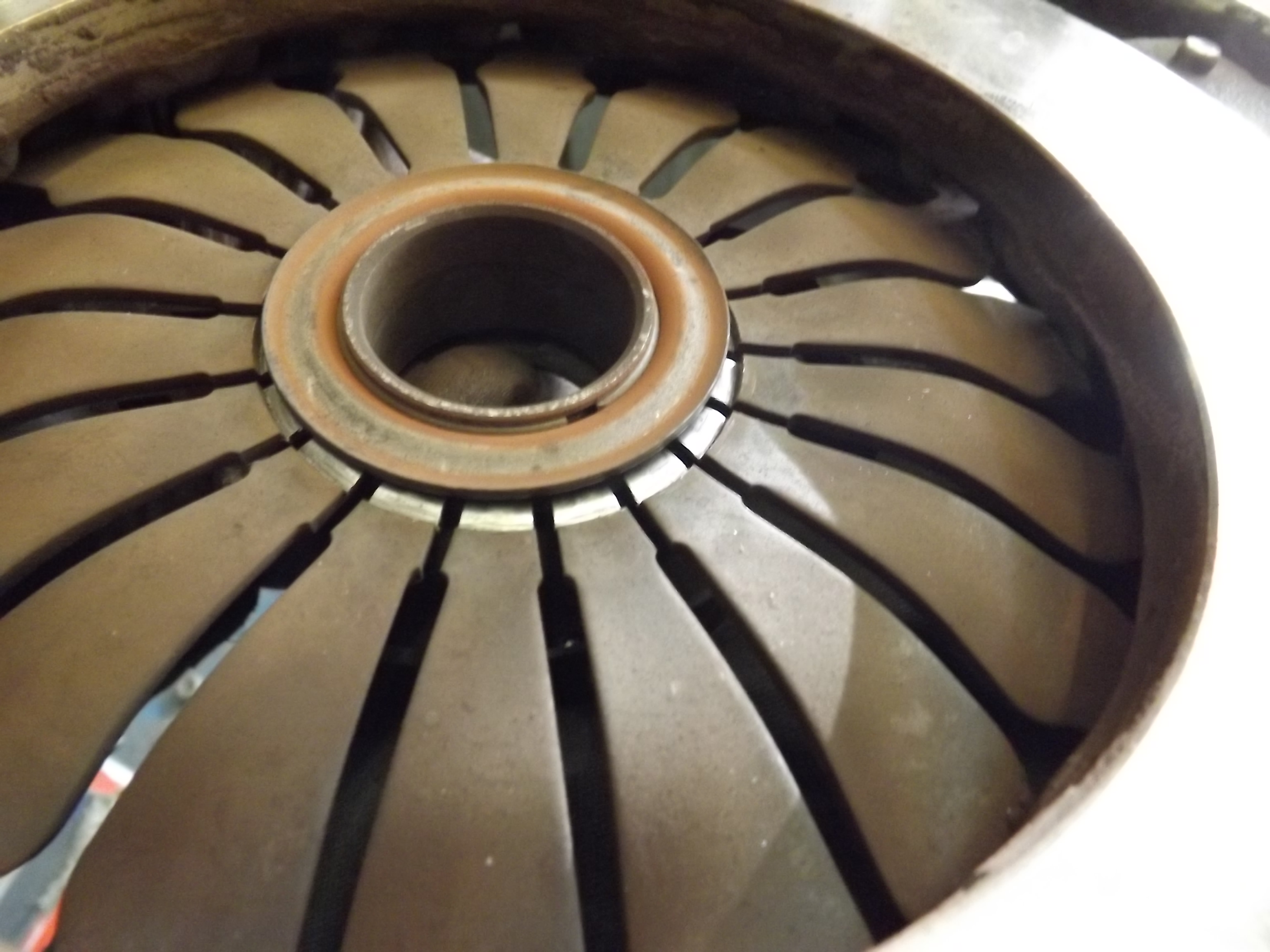

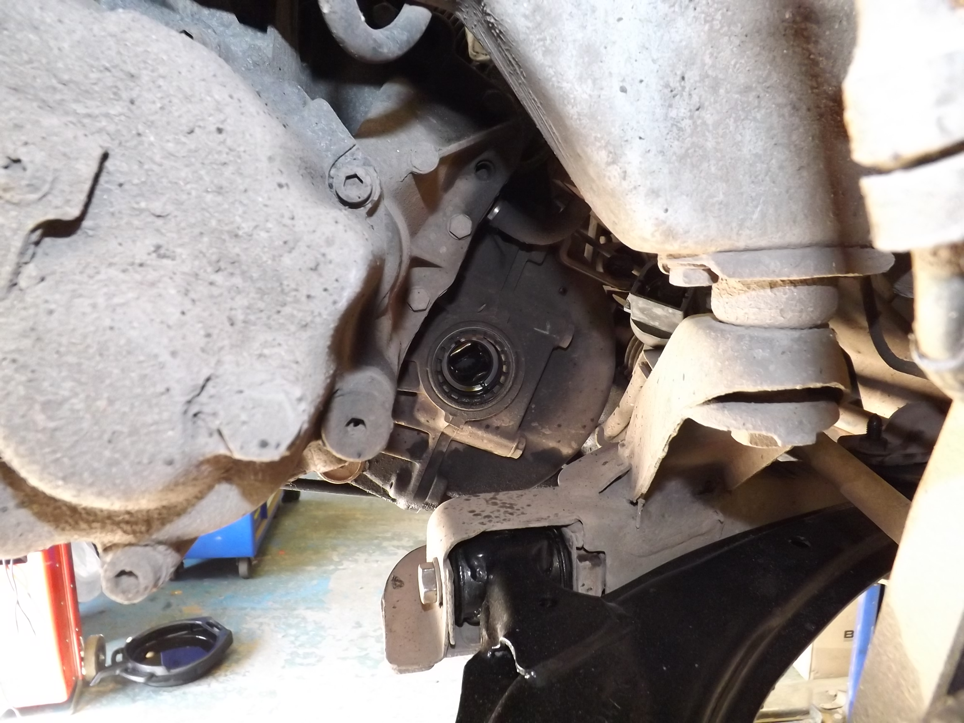

clutch is Done what a shit of a job

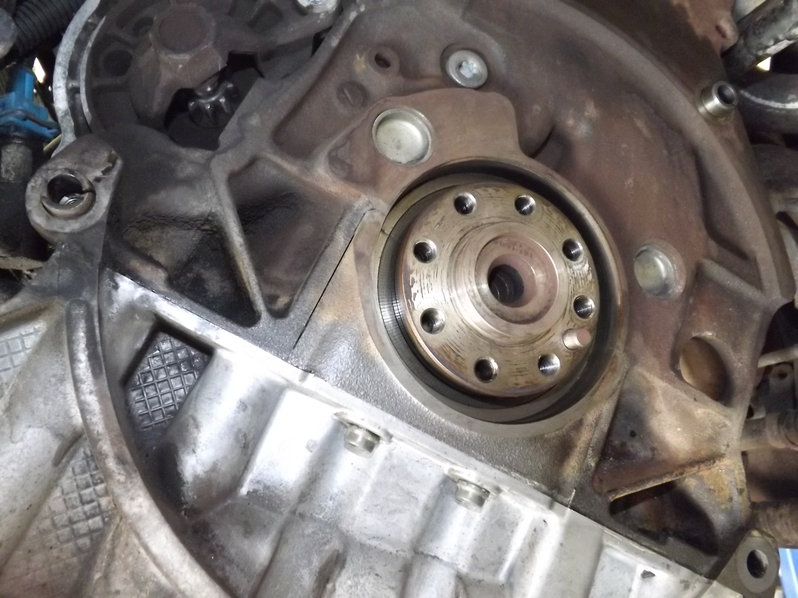

thanks go's to Dum-Dum for some advice over the phone, or we would have been scratching our heads for a long while on how to disengauge the fork arm from the bearing
oil seal was replaced it looks as if the leak was from the sump though as the bolts were loose all cleaned up and refitted
dont want to do one of them again for a while!
clutch plate was well worn and the pressure plate was falling apart!
clutch is light and bits hard now!

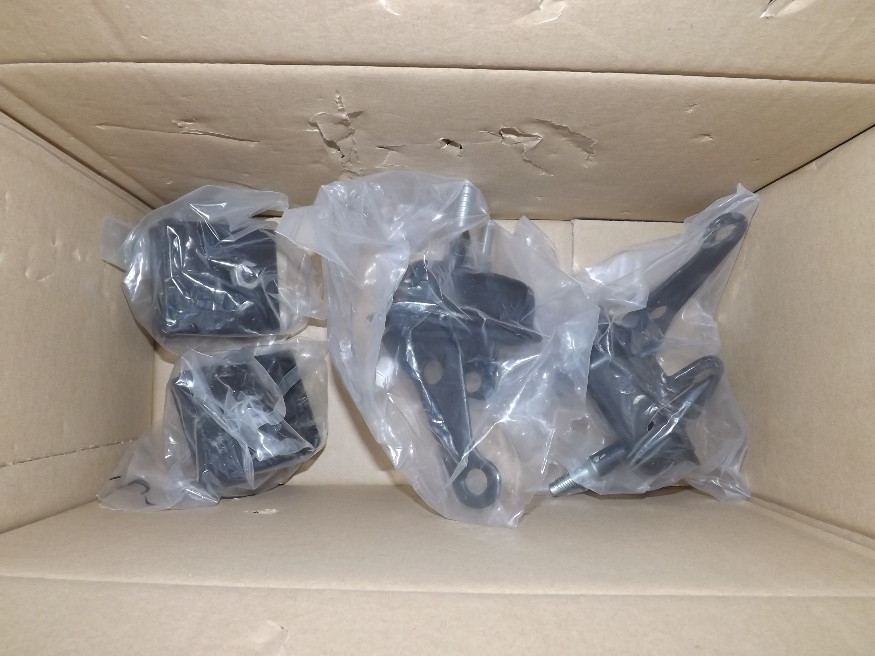

this week ends project has just arrived in a box
new set of rear beam mounts should go nice with a recon beam Smile
Ooooer your cars getting the works! Definately a good save. Did you think about solid rear mounts or not interested/too much wonga for how much you use the car?
yes tom exactly that too much money for what they are for the amount of use/ abuse they would get.
all the latest stuff ive bought like gear linkages,rear mounts,oil,filters,gearbox oil, have not cost me anything as the airbag resistor sales are paying for the parts, ive just got to fit them Smile

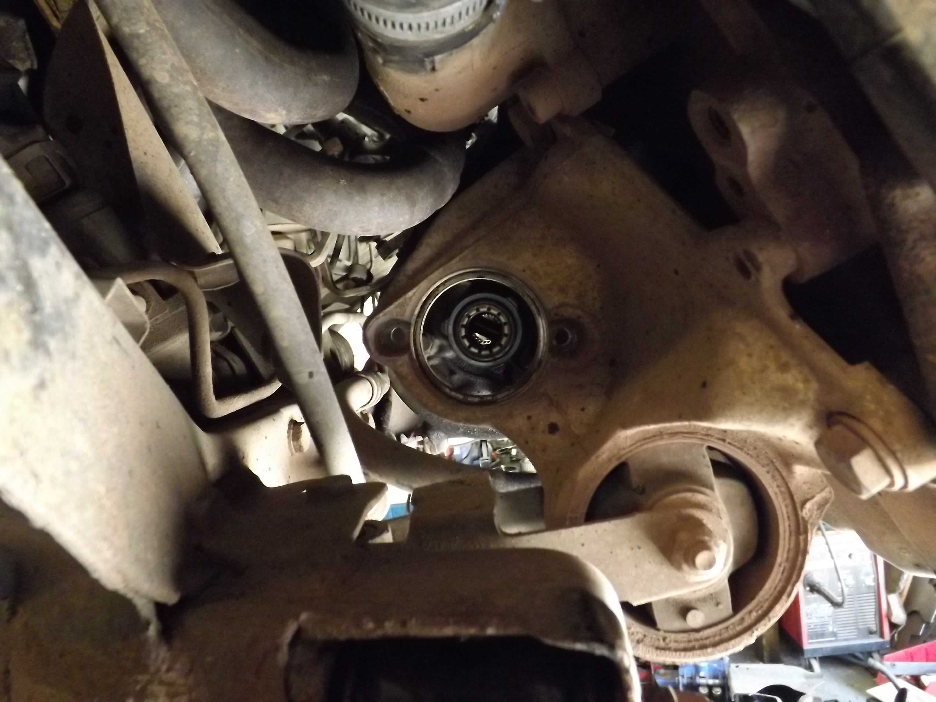

some quick pointers for changing the beam mounts
jack up car support car on the propper jack points to avoid damage
use penetrating oil on all bolts your going to slacken/remove
undo bolts while axle is mounted firm but dont remove bolts
slacken but dont remove
slacken but dont remove oposite side
remove top fixing bolts slowly lower side on jack caution watch brake lines!!
part remove lower bolt, fully remove top bolt
mount should wiggle out by tipping to the rear of the car
remove mount note offset
admire the used mounts
refit in the oposite manner
near side needs bottom damper bolt removing to let the arm swing lower to let bottom mouunt bolt out
only part remove lower bolt same as other side remove top bolt lower beam on jack caution watch brake lines!
refit new mount
admire your handy work

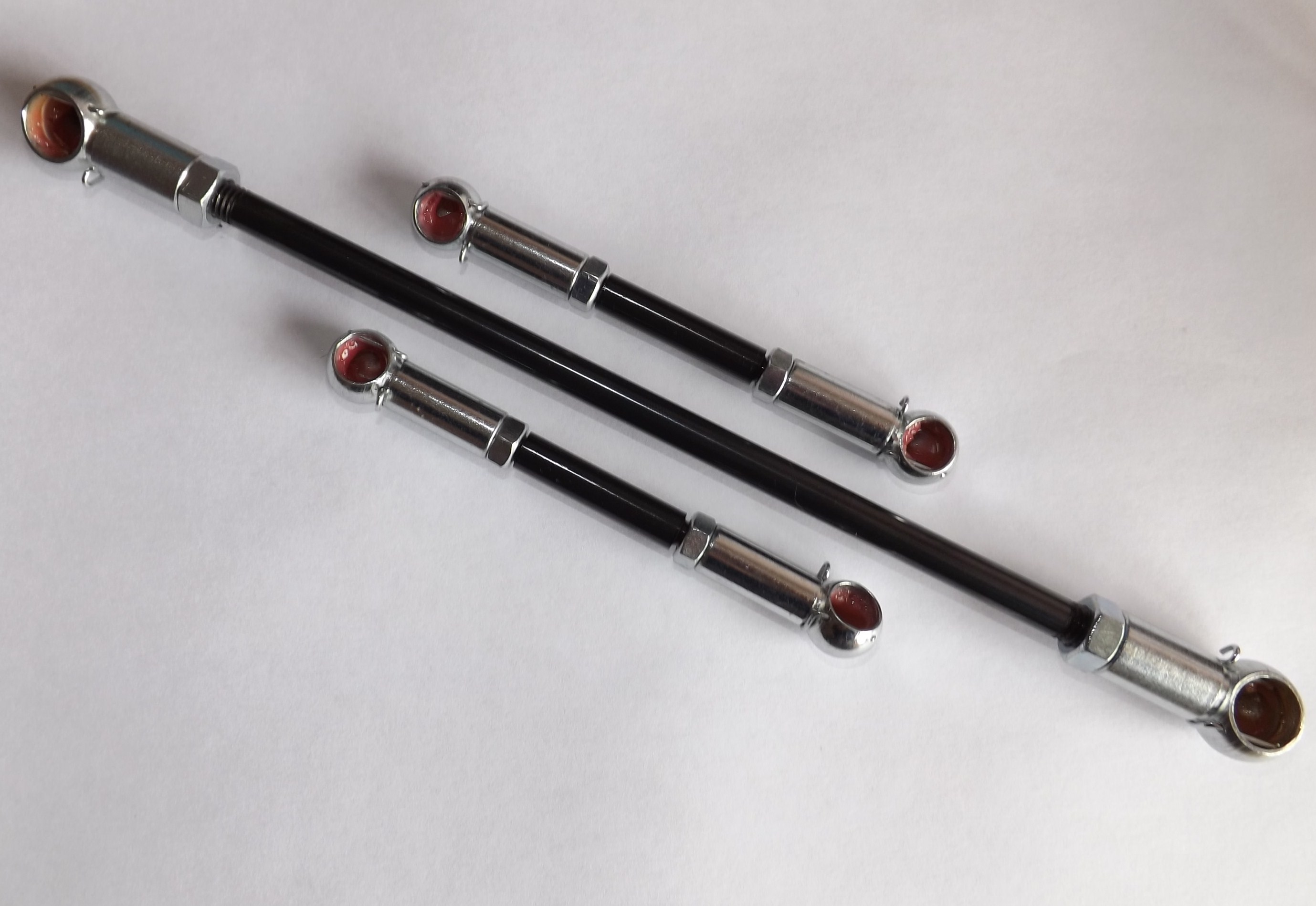

new comp gear linkages
