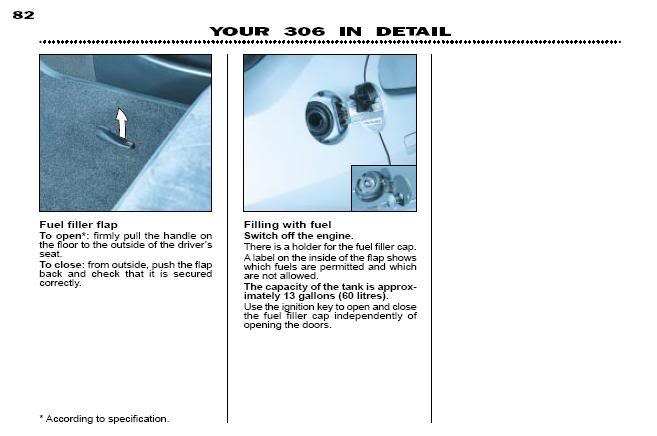

Same here that and the petrol cap holder lol

petrol cap holder?
Ha ha you as well !!! If you look inside the flap there is a spot to put your filler cap! So you don't lose it, can't shut the flap when it's in so can't forget to put it back in lol had mine 5 years before I found out ha ha

petrol cap holder?
shhhh dont tell him the secret holder for the fuel cap Big Grin
How can you not know bout the holder, it's like the best part of the car lol
WOOOOOOOOOOOOOOW WOOOOOOOOOOOOOOOOW WOOOOOOOOOOOOOOOW.....................................
Im going out side to try !!!!!!!!!!!!!!!!!!!!!!!!!!!!!!!!!!!!!!!!!! AAAAAAAAAAAAAHHHHHHHHHHHHHHH so excited
how did i not notice this?!?!?!? Shame mine is snapped off Sad Knew i should of taken the flap off the 1.8!
See now you know the secret of the fuel cap holder you have to be initiated by Samass!!! Into true 306 ownership!!
You won't know where or when!!!
But it will happen!!!!!
Lol
