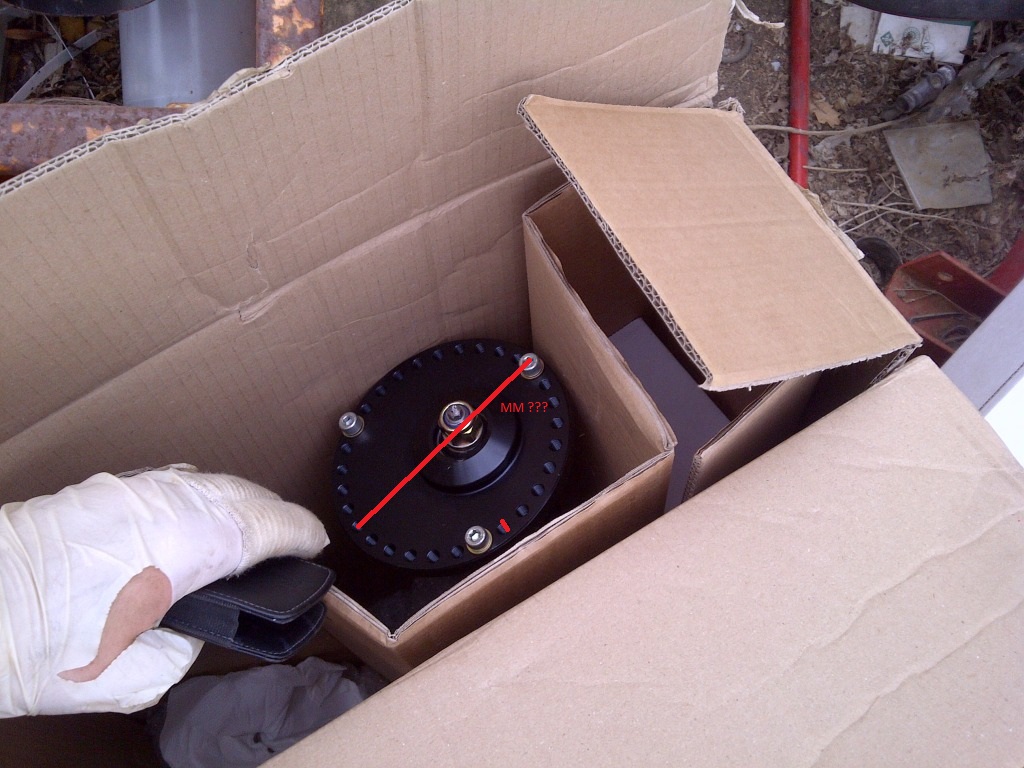

Ed i dont supose you know/could give me the mesurment for bolt center to oposite bolt center , i.e the red line distance in this pic?
#64
I'll do me best measuring them on the car Jamie! will see if I can grab 5mins tomorrow to get the front end up in the air and have a play Smile
#65
Nice one Ed your a gent. Just want to figer out exact size difference between mine and yours.if you messure from your top bolt ( one closest to the engine and bolkhead) to the bolt hole that needs adjusting (hole on the T/M its self) that should give me what im looking for i think. Should be able to do this from the top. Big Grin
again cheers dude

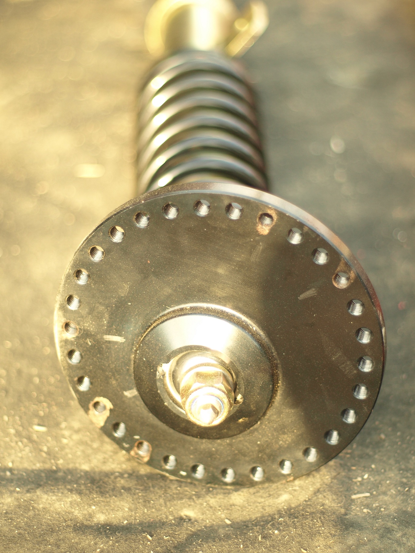

Right been out and made a template of my strut mounts and I can get 3 holes to line up after drilling and tapping the other holes, only thing is to me the top mount looks pretty much Fooking neutral, no camber or caster

Err. You're doing it wrong?
but srsly, why you drilled and tapped holes to fit the stock location? turn it to the camber/castor angle you want then. Droll and tap it!!
#69
I havnt drilled any new holes just opened the ones up that we're there and tapped them? If you look at the template that's all the holes I have available on the car and to get any castor and camber there is no hole available on the top mount if you get me
[Image: SDC10442-1.jpg]
#70
yeah but that's cause you're trying to make the wrong mounts for your car. Send them back and send them a photo of mine! you'll then be able to ajust them with plenty of different settings...
the only people to have these mounts installed and working are myself and grant, and both of us have ones with holes round the entire perimeter...

Here's a picture I took ages ago pissing about with a new lens when Ed was rebuilding the deadablo, shows exactly what Ed has:
Not sure if it helps or not but thought I'd stick it up
