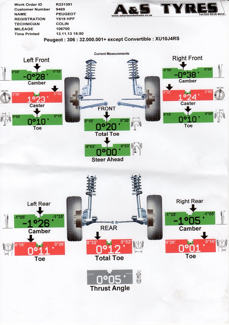

What could be causing this? I would have thought if it was aligngment it would be pulling offside in reverse and forwards. Would this suggest something is loose such as a rear trailing arm? ![]() I bought the car it it was slightly pulling to the right since and I have changed for new front wishbones and and rear bushes and a refurbed second rear beam which I done myself with new pins and bearings. I have also changed for a good second hand front shocks and pillow mounts. But since changing the front wishbones its pulling harder to the right now. I am going to take it for alignment again and hope that will cure the issue.
13-11-2013, 05:58 PM
I got the alignment done it's a lot better but its still pulling to the right.
![]() I asked them about the rear thrust and they stated that it can't be adjusted and because it's front wheel drive it won't make any difference. Anyone got any ideas where I should be looking next? I am hoping I am not looking at possible bent chassis I haven't seen any signs of damage.

Somethings not right on that rear

Perhaps I can loosen off the rear bushes and give them a bash to get the toe into spec? Should I take it the front is ok but the caster seems well out?
13-11-2013, 07:51 PM
having a look at it again....
From memory it should be 5' toe in, in total! Might be worth getting them to set the suspension to parrellel, ie no toe and see how you get on. This is easily achievable with a few bricks, 2 lengths of wood and 2 tape measures I set up my own cars like this and had it checked on some "proper" gauges and my work was spot on to the millimetre
Are we talking about the front or the rear? They said they couldn't adjust the rear but I am happy to have a go at the rear myself.
What are the settings for the phase 3 HDI Dturbo if you know or where I might find it cheers?

Sorry I was talking about the front
I freely admit I am baffled by all this I keep thinking there must be damage down there somewhere so I am going to give it a thorough look over.
Thanks for your help Paul but can you explain the logic to setting the toe to zero on the front will that help identify the issues in someway or rule out others?Also if I put lowering springs on it will that give me more caster?
