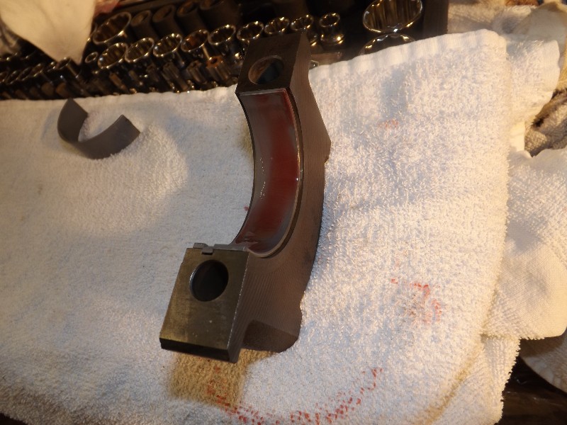

decided to check the big end bearings with a micrometer could only get an imperial one so had to convert the reading!
the micrometer is a 1" to 2" size
so the reading is
1.9...50+18 = 1.968" which works out to 49.987mm =standard bearings

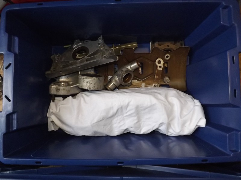

have been going mad at cleaning stuff the box of clean is getting bigger

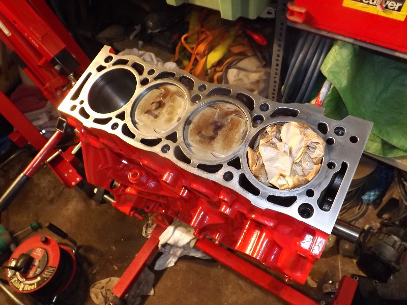

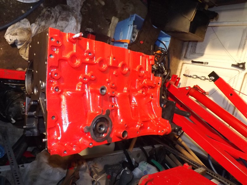

have also painted the Block Red!

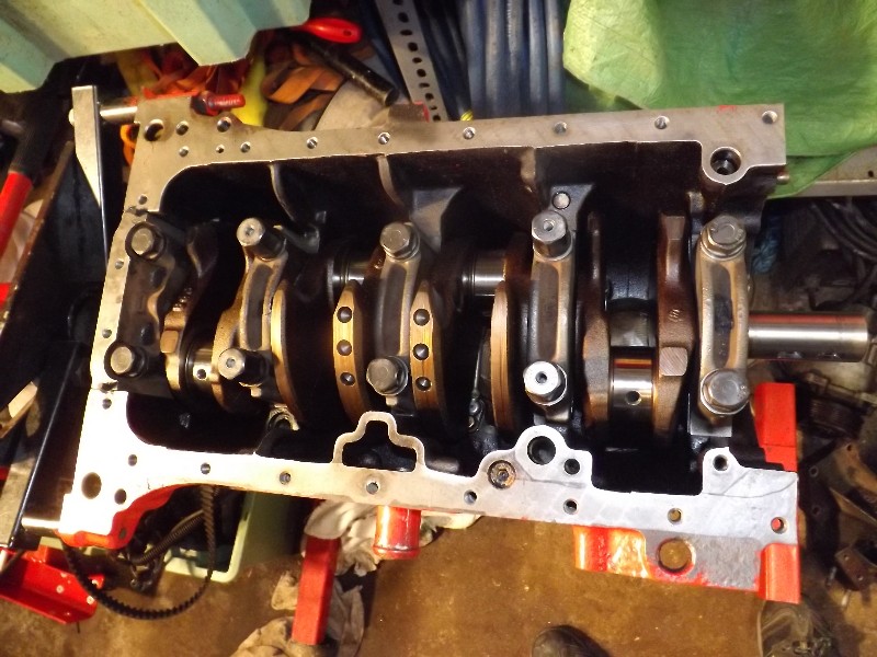

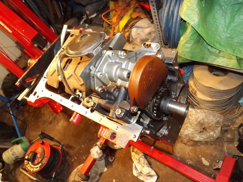

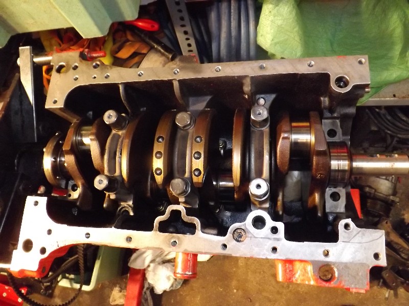

started rebuilding this today as the weathers been pants so havn't been able to work on the car so its in the garage today!

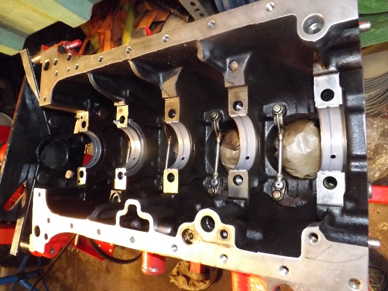

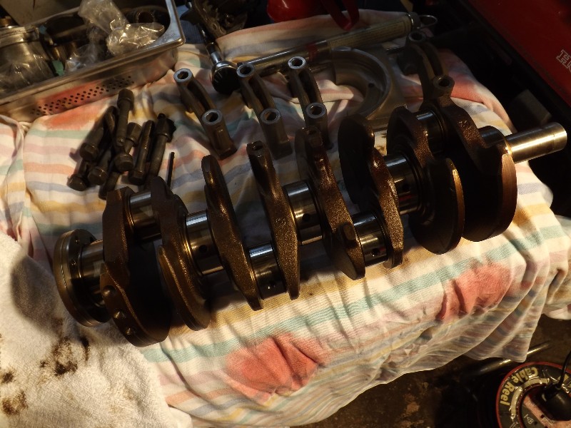

cleaned crank ready for instal
new ACL bearings and thrusts installed pre assembly lub
main caps fitted bearings with assembly lub
main caps being installed and torqued down
after each cap is installed the crank is turned to see if its free of pinched tight
all main caps installed and torqued down crank was still nice and free

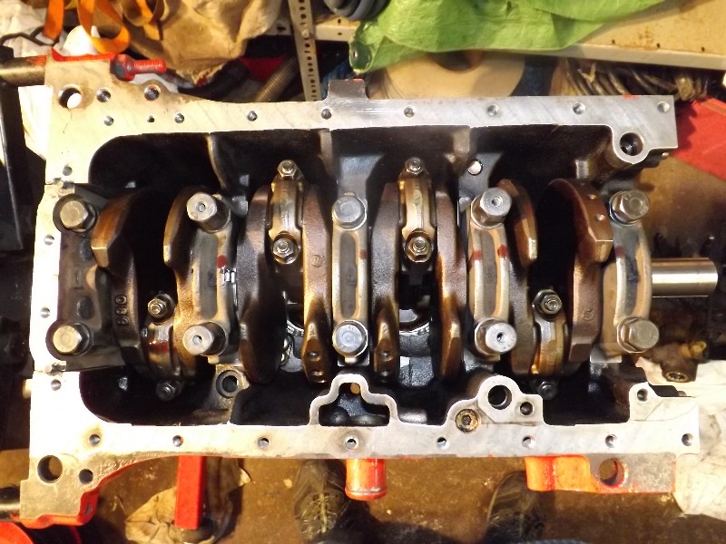

starting to install the pistons and ACL Race big ends
all in

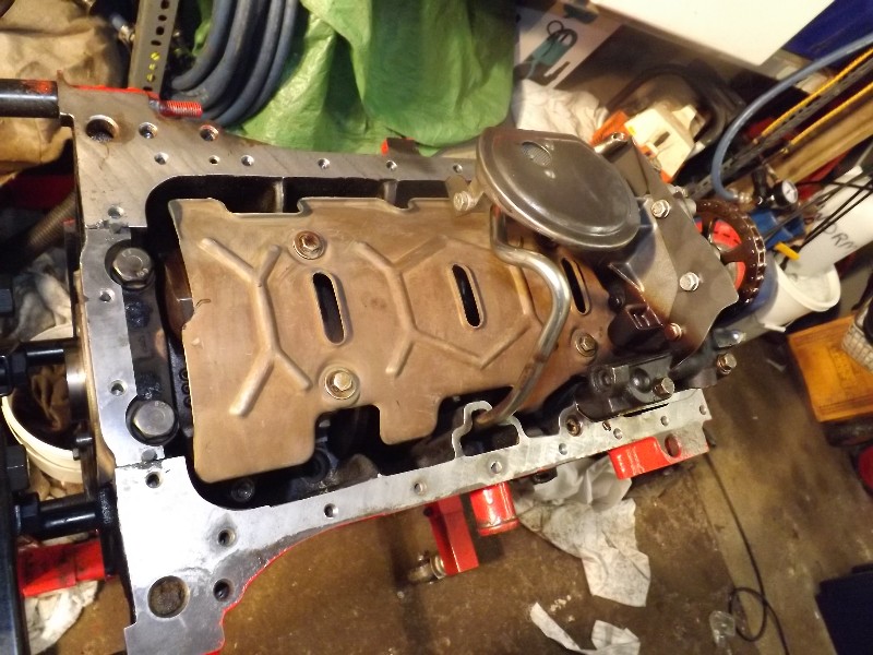

windage platew oil pump in

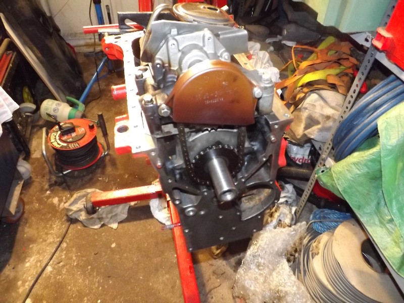

oil pump drive and chain oil bath

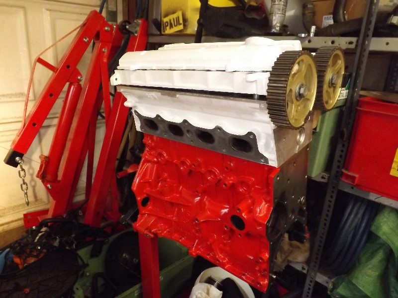

as it stands tonight
