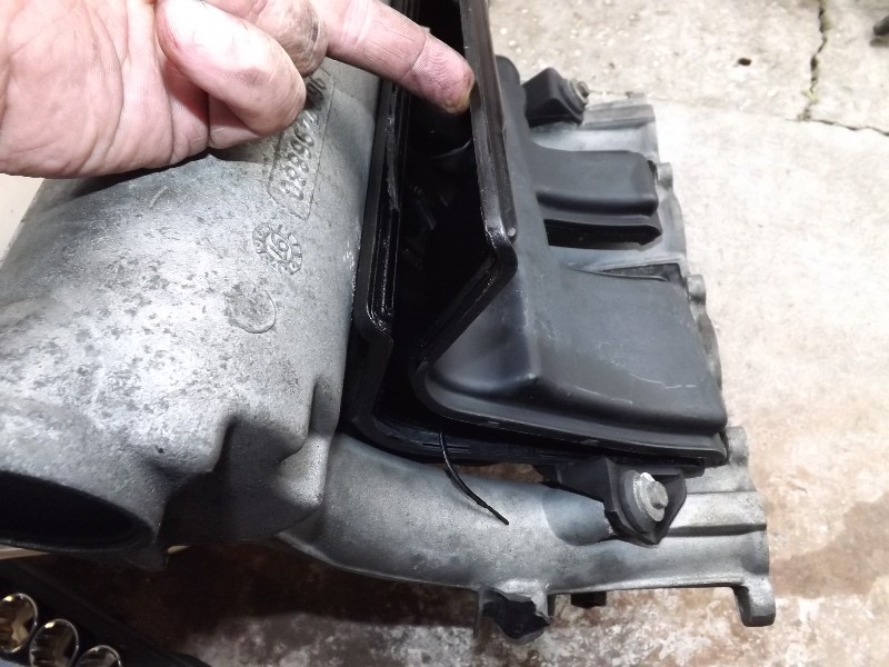

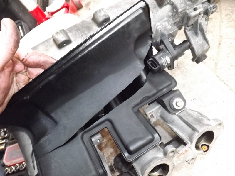

looking at the inlet on the back there is a resonator box this looks like it has exploded!
my theroey is poor idle irattic reving caused by cracked box
finished off by a blowback back fire into the inlet explaining the Bang!
[attachment=10350]
[attachment=10351]
[attachment=10350]
[attachment=10351]

It isn't the first time that one of the resonators has exploded on these engines and I doubt it will be the last

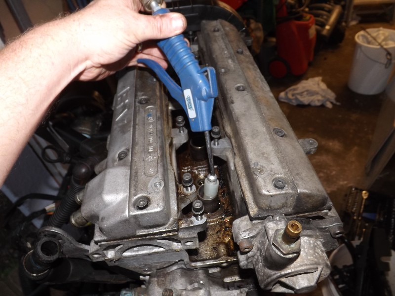

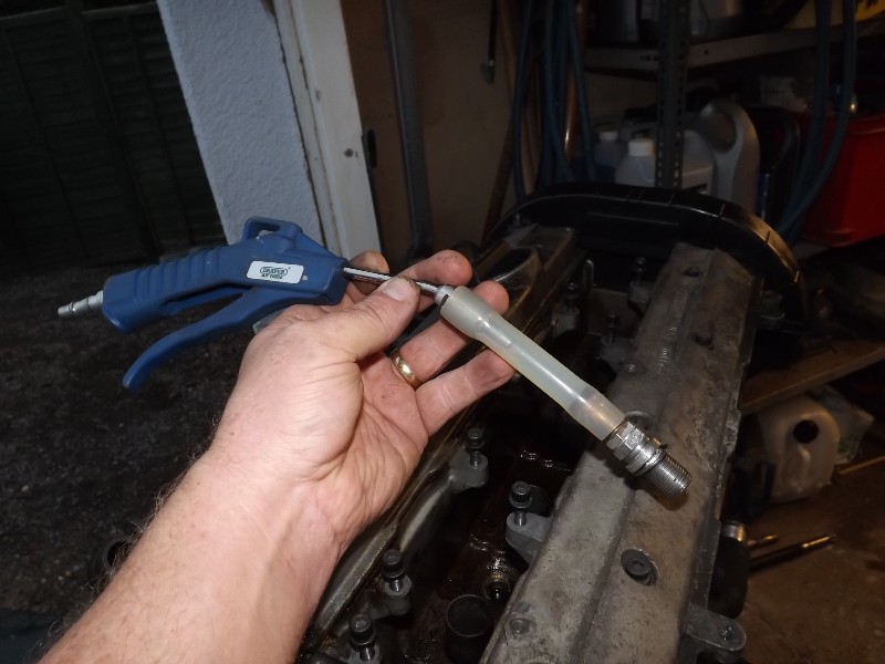

have made my pipe so i can inject compresed air
[attachment=10377]
screwed it into the plug hole and compressed the cylinders in turn
[attachment=10378]
have been through all four cylinders and the results are in...
cylinder 1 from gearbox end leaking on exhust valves very slightly
cylinder 2 from gearbox end leaking on exhust valves very slightly
Cylinder 3 from gearbox end leaking on exhust valves very slightly
the rest including cylinder 4 inlet and exhust valves and rings sound good with no leakage
so as of now the head needs lifting and the exhust valves on 1,2,3, need checking
they may only need to be re ground but we will see
[attachment=10377]
[attachment=10378]

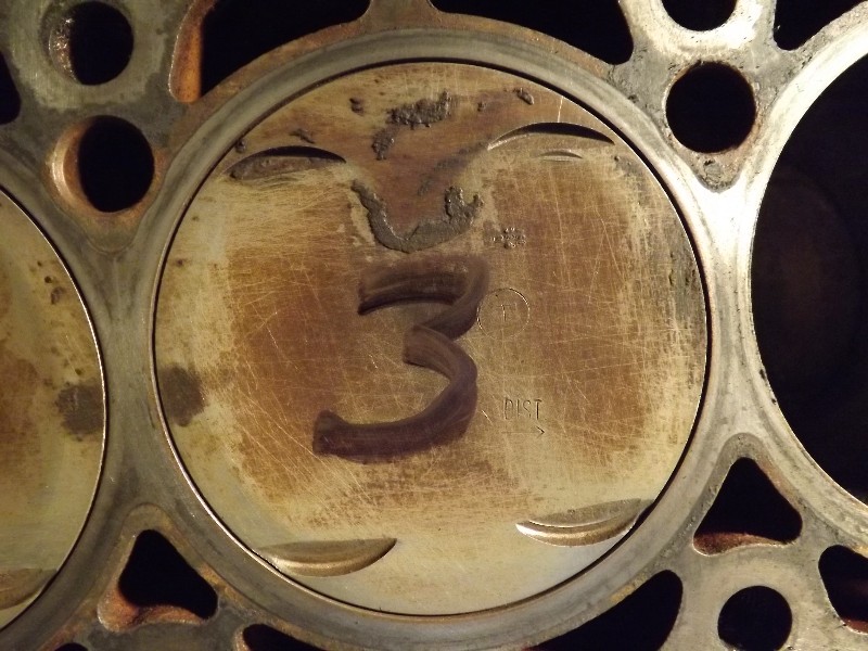

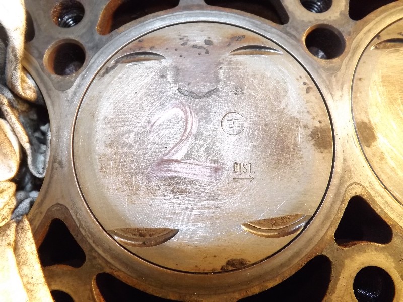

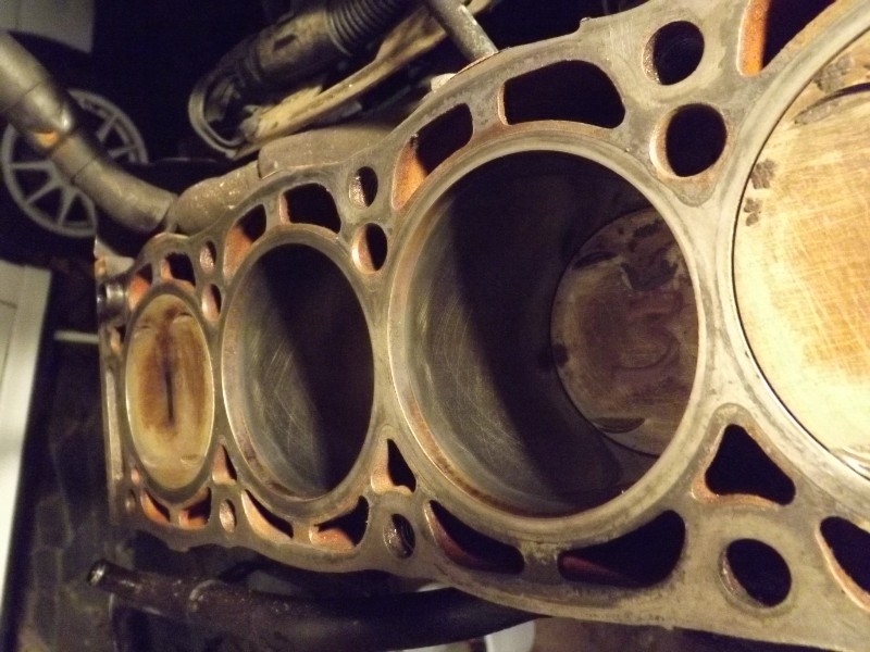

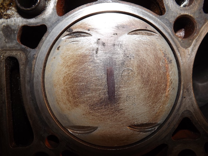

have a look at these pictures of the pistons and tell me what you think!
[attachment=10407]
[attachment=10408]
[attachment=10409]
[attachment=10410]

It must of been a snapper in a previous life then. If you checked the timing and all the pins went in, it couldnt of been that head that caused that piston damage. I reckon its snapped and someone has rebuilt the head them selves and looking at them compression figures, not too well!
23-09-2013, 07:59 PM
just remember the compresion figures are turning over by hand not on the starter
yes i agree with the snapper idea
all the half round marks, out outside the cutouts are on the inlet valves
but they look old marks that are carboned up
i think it has had a recon head as the alloy castings on the head have been sprayed silver including the cam seals

The only issue it can* cause is a failed bottom end due to damage to the big end bearings from when everything got mangled up. Not that it matters to cully because if he is refurbishing is, he will fit new bearings anyway!
*but thats very rare
23-09-2013, 08:48 PM
Yeah deffo going with a past timing issue there. What I want to know though is if those groves on the pistons are on the inlet sude, whats causing your loss of pressure from the exhaust valves?
23-09-2013, 08:52 PM
(23-09-2013, 08:48 PM)Grant Wrote: [ -> ]Yeah deffo going with a past timing issue there. What I want to know though is if those groves on the pistons are on the inlet sude, whats causing your loss of pressure from the exhaust valves?
If it was that head that had the belt go, i bet they fitted new valves but not guides. The valves would of contacted each other when it snapped so probably not seating properly.
23-09-2013, 08:58 PM

You can see they're old gouges definitely. Can't understand the person who whipped off that head, saw those pistons and just stuck a new head on...
