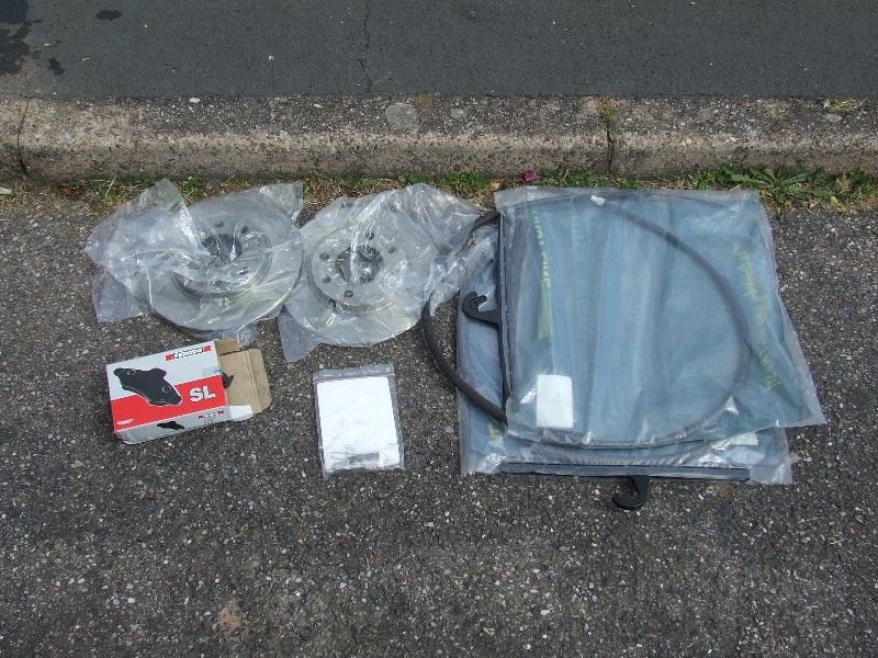

so after collecting all the parts over a few weeks
it had to be done today and it was sunny so bonus
parts
2x disc's
4x pads
1x fitting kit
2x handbrake cables

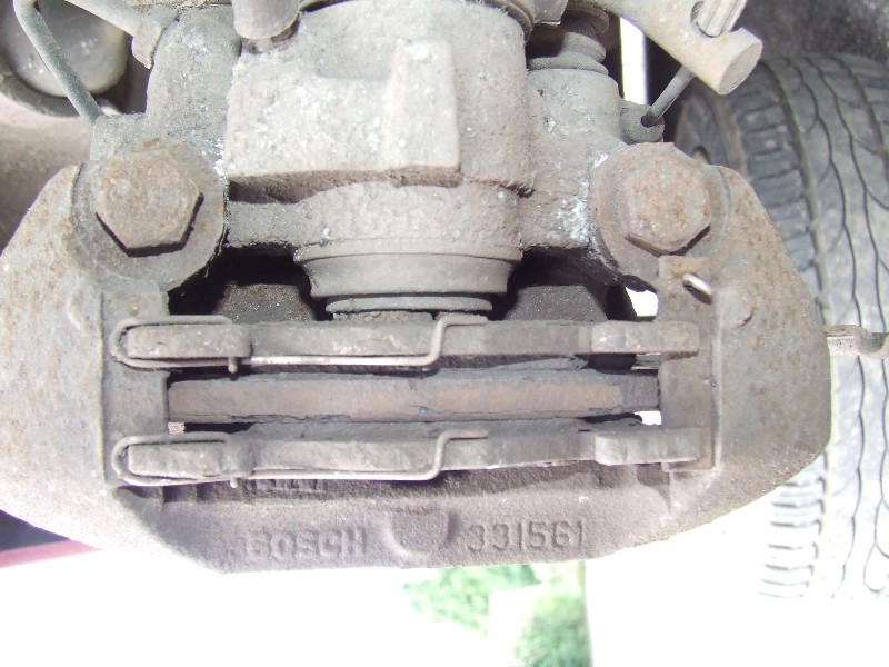

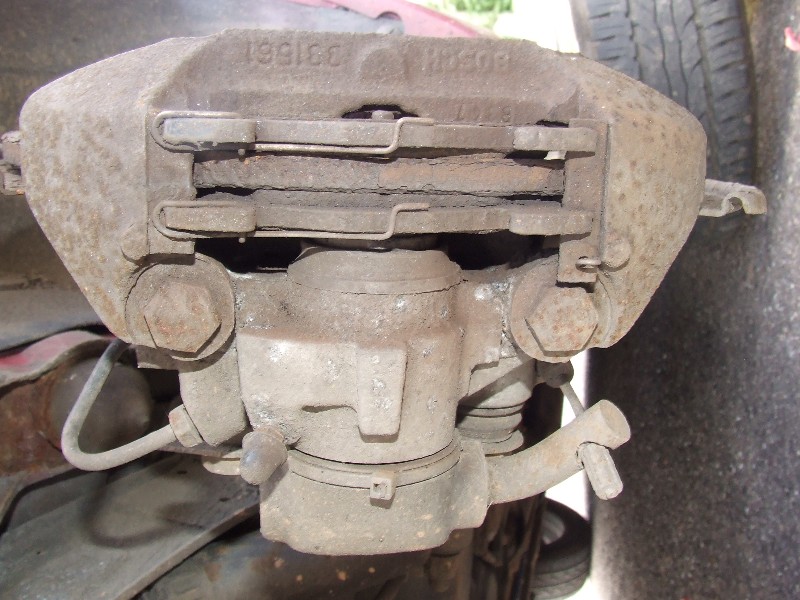

so started off by removing the wheels and taking photos of the spring clips that retain the pads as i will/did forget there fitment
took it all apart and found the pad retaining pins seized so had to chisel them out so good job i bought a fitting kit

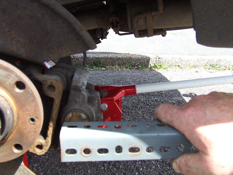

wind back pistons FTW!
cleaned it all up and refitted the new stuff referring to the spring clip pictures for reference

Changed vw polo rear brakes the other day, needed some special tool though to adjust the piston back far enough to get the pads on do you not need one of these for the 306?
[Image: mcetg0.png]
no nothing special as long as it fits into the slots i used an offcut of angle shelving to turn the pistons in
