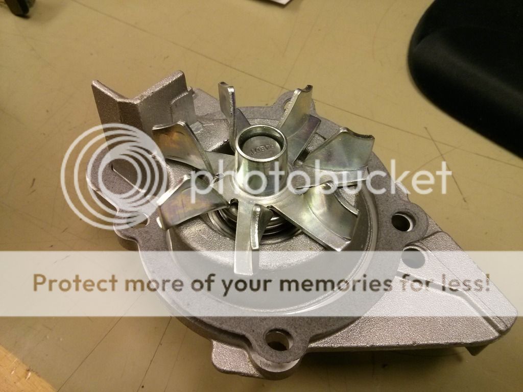

I've been looking at do the cambelt and I'd ordered a pump from ECP.
They sent me this
[Image: IMG_20160428_125700_zpssxboenbb.jpg]
I didn't the impeller style.

Now I thought it should be more I'll the HDI ones or am I wrong the the OE ones have the ones like the above?

OE GTi-6 water pump is similar to the pump pictured at the bottom.
1990 Peugeot 205 GTi 1.9 // 1991 Peugeot 205 GTi 1.9 16v // 1992 Peugeot 205 GTi 1.9 // 1999 Peugeot 306 HDi Estate
That's what I thought, the others are just cheap tat then.
Sent from my Nexus 4 using Tapatalk
the top 2 are cheap press steel, although they may last, the design will create cavitation, which could cause case erosion.
the back end of the impeller is flat for a reason, this is to prevent cavitation and to help flow through the pump. The small hole in the back of the impeller is there to allow a small amount of water to pass, which would then be on the low pressure side, creating lubrication for the seal. i would not be happy with that part, unless i had no other option..... even then i would insist on changing it out for OEM asap.
if the shaft sizes are the same, you could remove the impeller from the busted one, and fit it to the new one, A small blow torch, and puller should do the job. Smile

Pretty sure those top 2 are identical? What brand were they?

Ah that's odd, the ECP KWP one looks OE in the pic! http://www.carparts4less.co.uk/cp4l/c/Pe...5ac&000366
I'm pretty sure they are both the same though, despite the packaging. Confused
Website images are frequently misleading, especially ECP who have a nasty habit of picturing and describing one product only to sell you an "equivalent" (I use the term loosely)
