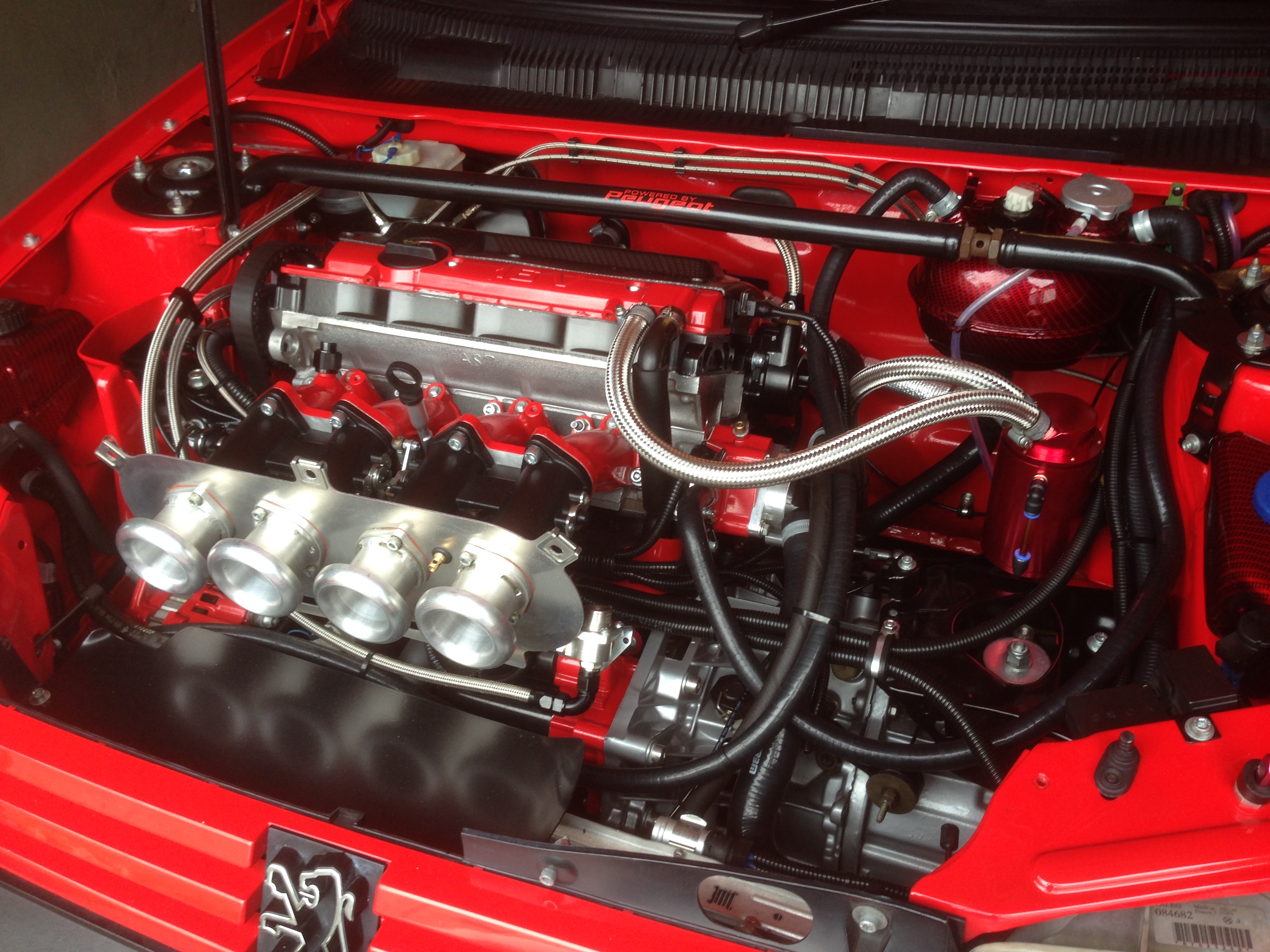

Tas is working on the car next Friday and I'm booked in for a mapping session with atspeed on the 4th.. Coming along slowly Smile
Water pump wise is one of those things, Currently Motaquip are OE as i have never liked most pattern pumps, What do you think of Tas' car
Overall Road Going Production Class Winner at BARC Gurston Down Speed Hillclimb 2012, 2013 & 2014 With a class record along the way (For a while), Taking 2nd place will be Ian Redding's 306 GTi
2016 Castle Combe GT championship class winner
water pump on trade is not bad, belts are cheaper than aftermarket Big Grin
(22-04-2016, 10:39 PM)miles Wrote: Water pump wise is one of those things, Currently Motaquip are OE as i have never liked most pattern pumps, What do you think of Tas' car
Never got to hear it start, but damn it's nice! Some serious money has been spent on it. Inlove
