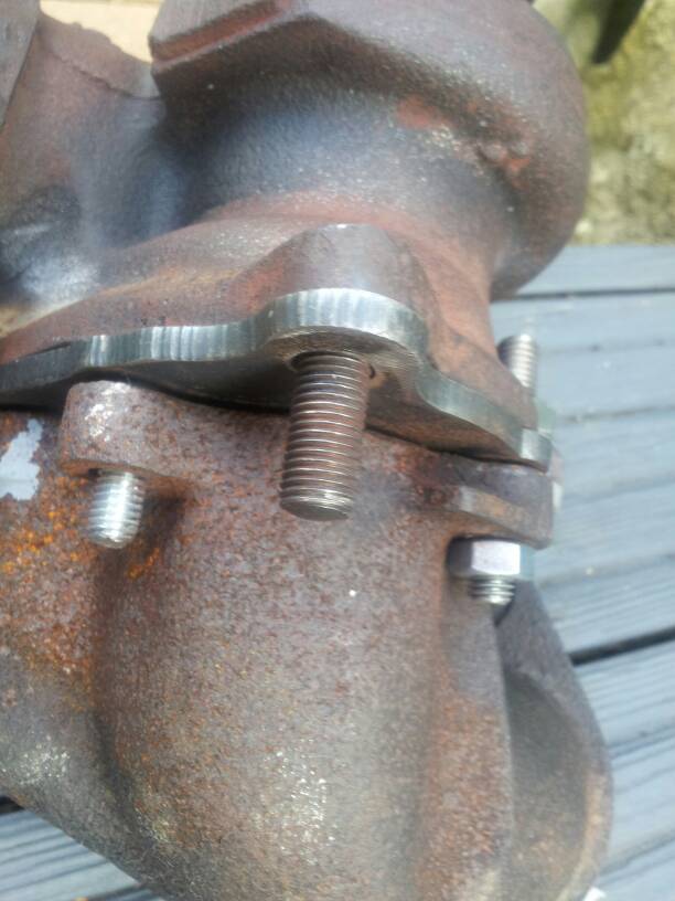

Anyone know what size/type of thread is on the td04 manifold?
Looks like m10 but doesn't fit. Imperial?
M10 x 1.25 not a regular 1.5 thread. If thats the original stud that is Smile
Any idea where I can get a couple apart from eBay because you have to but a pricey pack

Will I need to blank this as I took the wastegate actuator off and weld it shut
The other thing was what are these for as it already has a oil feed on the left side and return/drain on the right side (opposite)
Yes blank that if it the gates welded and those are the water cooling holes so ignore them lol

Whats a good or easy way to blank it if you have little tools?? Ahh yes I remember forgot about the watercooling
Cheers
cut an inch of tubing. put one end over the pipe and zip tie/clamp a bolt in the open end, that normally works
or just squash the pipe (might not seal 100% tho)
and/or use chemical metal i the hole

I got bolts for the studs from ebay, 6 for not much at all.
You do need to seal that hole up, I used instant gasket in mine, then a small piece of hose with instant gasket to make sure it was sealed.
Are you going to be using any gaskets?
Holts firegum exhaust paste. f*ck gaskets for a laugh. I never blocked my waterholes just left them.
(09-07-2013, 07:08 AM)Tom Wrote: Holts firegum exhaust paste. f*ck gaskets for a laugh. I never blocked my waterholes just left them.
I used that and gaskets. Got a sheet of metal gasket material from eBay and cut my own.
I brought a gasket for the t2 manifold where it goes onto the engine but the turbo itself and all the plates - I was just planning on using holts exhaust paste as I've heard it seals a treat Smile
I'll try putting some on the small turbo pipe and capping it off with a small silicone hose, cheers
(09-07-2013, 09:31 AM)scottbmxer Wrote: I brought a gasket for the t2 manifold where it goes onto the engine but the turbo itself and all the plates - I was just planning on using holts exhaust paste as I've heard it seals a treat Smile
I did both so I was sure it was sealed, didn't want to take it off again.
