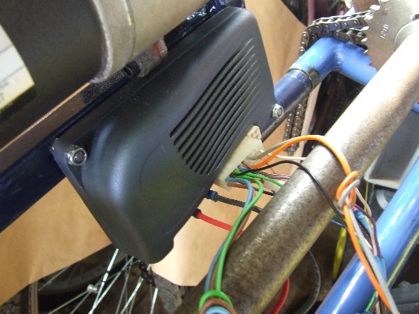

have got the motor speed controller mounted and have nearly wired all the control circuits

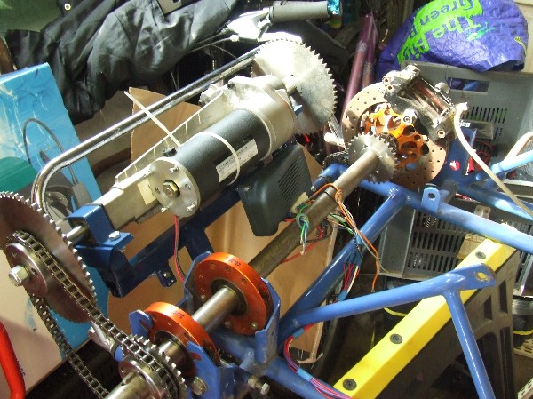

Ive had it running on the stands in the garage
video to follow heres some more pictures
been wiring in the essentials today like master kill switch and battery lines
still not quite sure where I'm putting the battery's yet cause i need to source a seat i can fit into Smile
[Image: DSCF0123.jpg]
temperary battery's notice the fuse at the terminal for protection Wink
[Image: DSCF0124.jpg]
