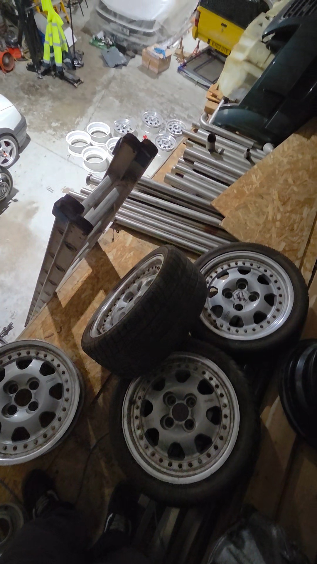

OK so trying to figure out the best way to update this thread as its been so long ?
So straight off the bat she's had a serious amount more work done to her now ? its probably just easier to sum up the changes as honestly cant remember in what order I've done them now.
So she's now running a twinpass fmic, 2.5" full stainless system, bosch 9mm setup (installed by Sir Bash ?✊️), powerflex black wishbones, Side skirts, Baker bm engine mount kit, spax rsx coilovers, adjustable arb links, 307cc 304mm brakes and 16" xxr (probably more I've forgotten as per normal)
since the last post there's been several wheels and looks tried such as my banded steel phase..
I enjoyed the bandeds but just felt it wasn't the look I was after and these restricted me to 283mm brakes at the most. Continuing with my fast road approach I ended up making the leap to xxr 527 16". These aren't too alot of people's tastes but perfectly fit the look and style I was personally after.
More recently I've purchased another brake upgrade, these will be recognised as Stefan Golesworthy's 205 gti6 supercharged brakes.
The setup consisted of 4 pot nissan sumitomo also known as r33/300zx brakes and utilised 283mm disks with the aid of an adapter. After a play I soon realised the clearance wasn't so great on the xxr literally giving less then a mm clearance on the spokes. Luckily stefs currently working with me to design new adapters that will allow me to run the 304mm 307 disks which will actually solve the clearance issue aswell as giving me the excuse for bigger disks ?
On another note, finally got the last of the components and tooling required to build up the forged Xud.
I'm aiming to do 99% of the work myself just for a sense of accomplishment later on.
I do have a single question related to this which is should I purchase a brand new febi oil pump and chain or run the original?
But I doubt anyone will see this too reply ?

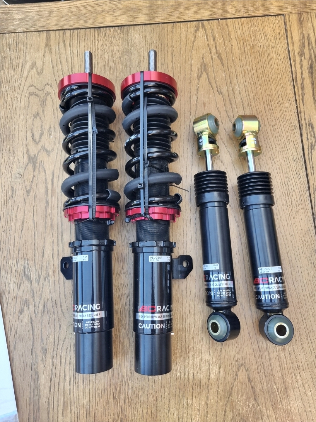

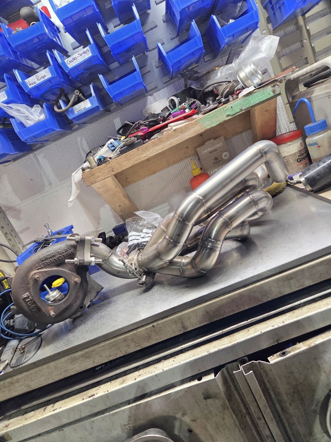

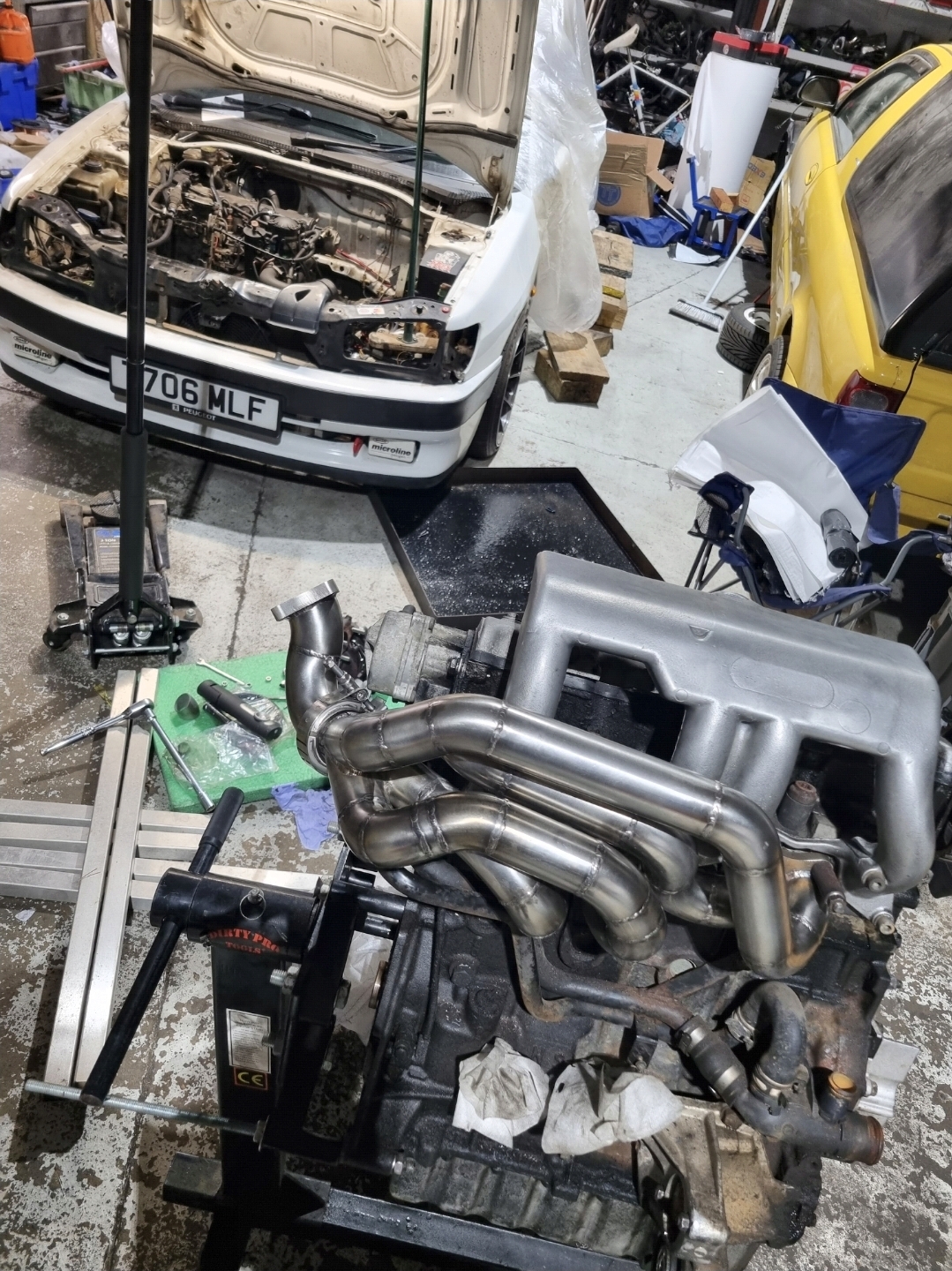

Been collecting alot of parts to revive this old gal when ive got a spare 5 minutes to work on it. Plans had to be massivley upscaled as couldn't have this sitting in the shadows of the sedan.A good 95% of the parts are sat waiting now, I just need the time to put it all together.
So straight up, the plans pretty evil ? Gonna try keep the theme of a "fast road" sleeper alive with some elegant touches. Aiming for a minimal of 3x stock power. (Wish me luck!)
Parts haul so far is some new BC Racing coilovers with custom machined spring perches to suit BBM top mounts. Hybrid rear bars (think there somthing like 26/28mm setup) to go with xsara vts trailing arms. Obviously she had the big brakes before, 4 pot r33 skylines with 304mm disks, 266mm rear venteds. Interior wise is going full black out, finally got my hands on a set of full leather executive seats and got a 2nd set of dimma wheels just to hit those VIP feels.
Engine wise...
Forged rods, 4 to 1 manifold, gtb2260vk turbo with custom vnt controller, 2.5" exhaust system, ported head, cam shaft, heavily modified 11mm pump (got pretty good at these now ?), oil cooler, fmic and various other bits i don't quite want to give away yet.
