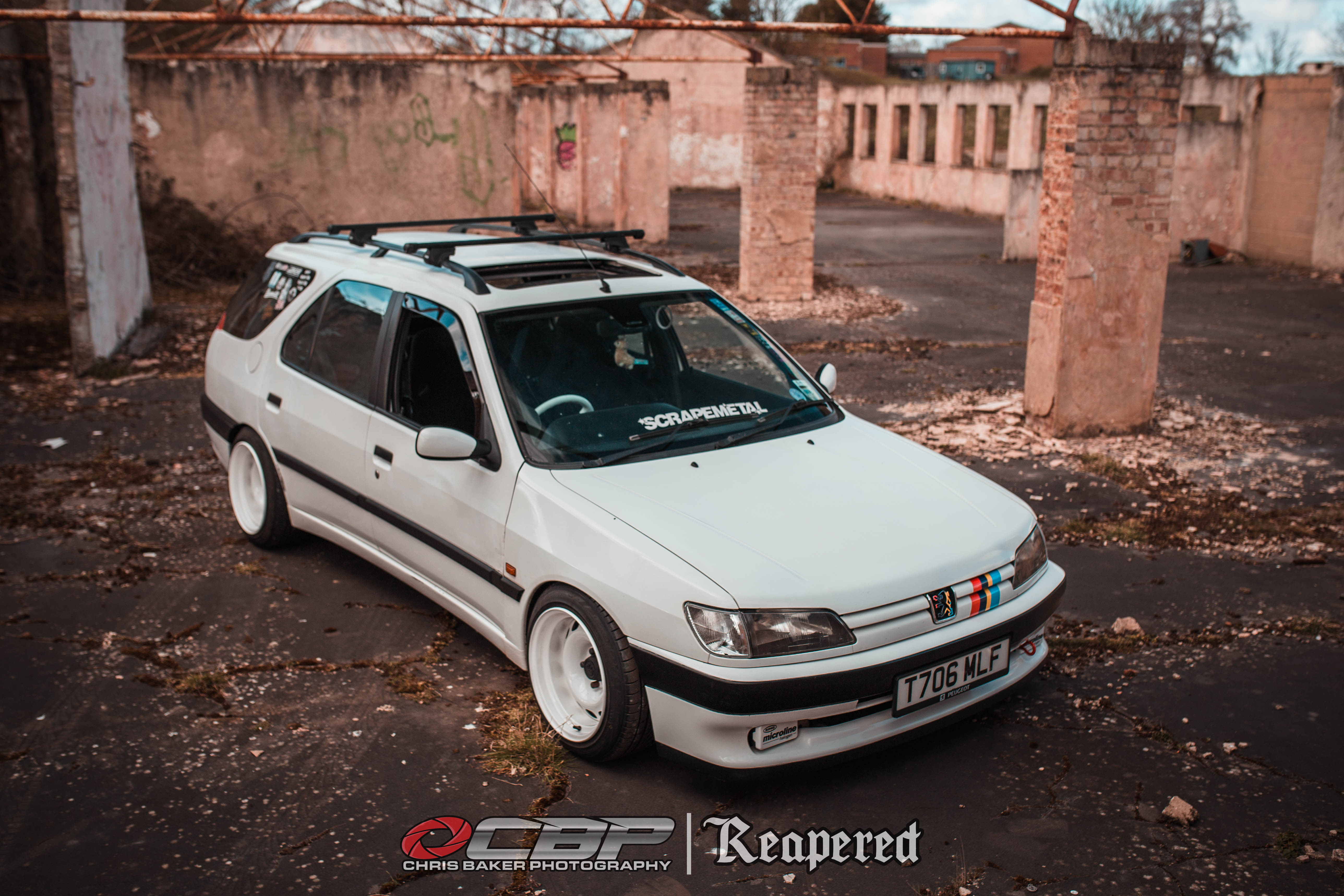

since the last post there's been several wheels and looks tried such as my banded steel phase..
[attachment=32163]
[attachment=32164]

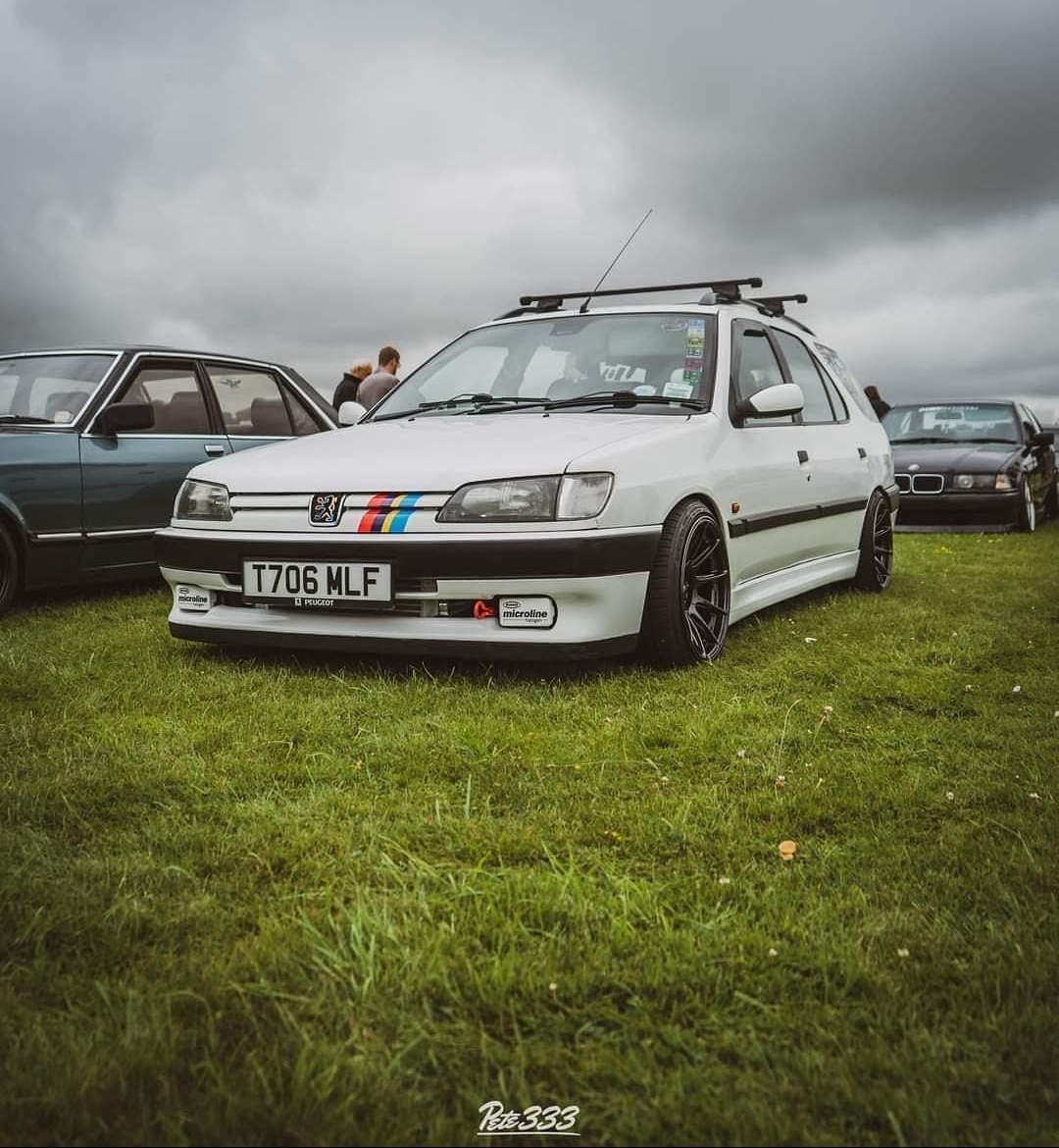

I enjoyed the bandeds but just felt it wasn't the look I was after and these restricted me to 283mm brakes at the most. Continuing with my fast road approach I ended up making the leap to xxr 527 16". These aren't too alot of people's tastes but perfectly fit the look and style I was personally after.
