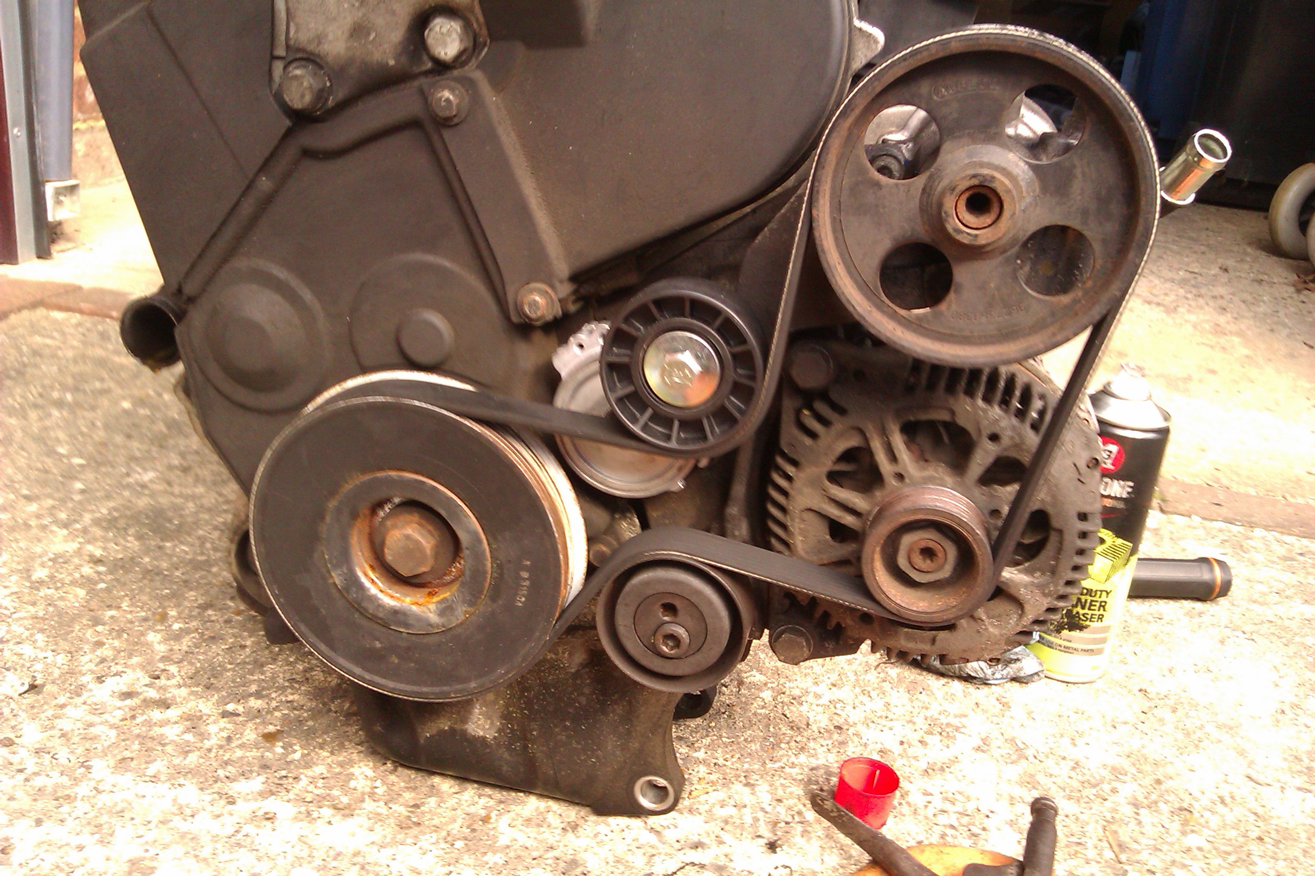

Edit - I guess pictures don't auto resize on here now lol...
(04-03-2018, 12:24 PM)Toms306 Wrote: The access to the tensioner isn't that bad and it's just one bolt, I don't see what you'll gain from cutting a hole in the hole in the chassis tbh, it's not even that high up.
I kept the sprung tensioner with air con delete myself.
