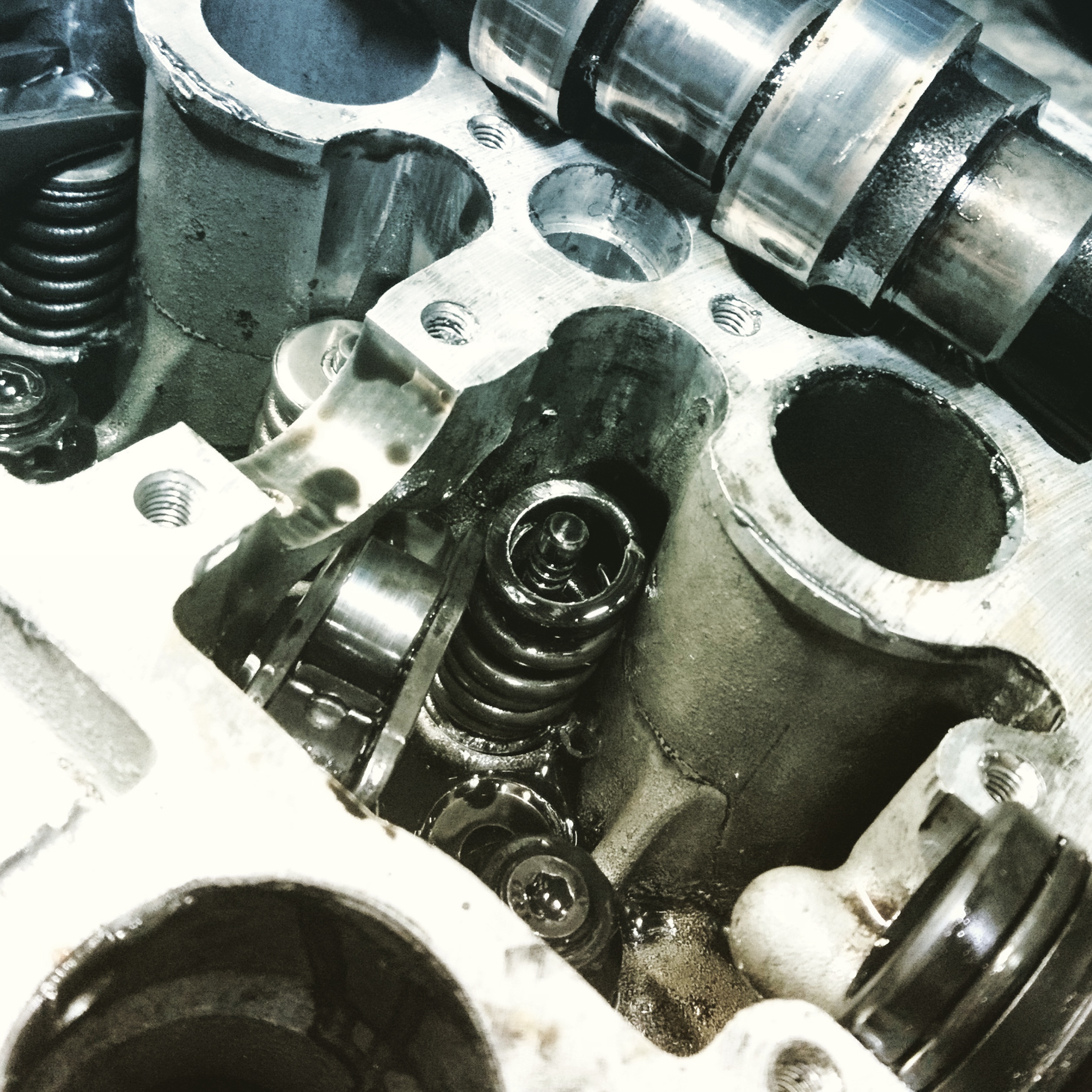

ahh that would do it.
collet unseated/not firmly fitted and pinged out?

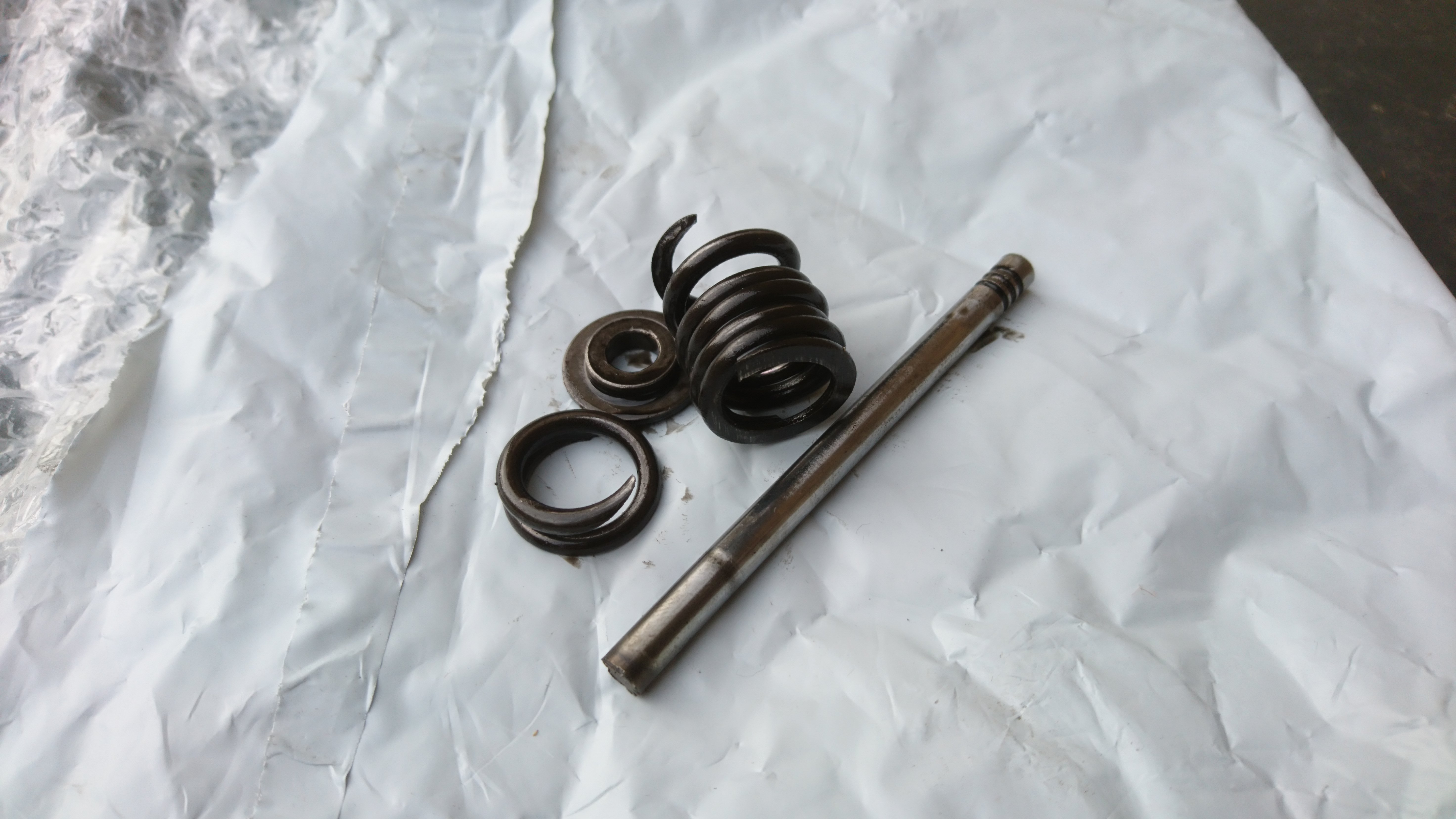

Valve springs cracked FSR - two different engines with different springs had the same failure mode.

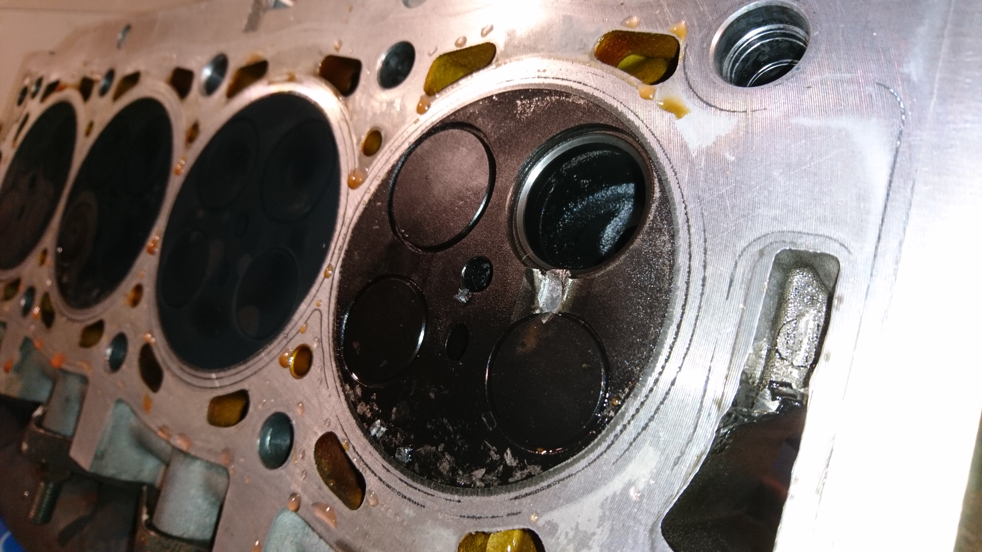

Head badly damaged. Injector nozzle destroyed.
Valve seat cracked

Had many offers of parts which is super kind and may indeed keep this going. Company who supplied springs has been good and on inspection of the snapped spring has seen its a material fault
They have asked for a price on parts to put right.
Next step is finding a different company to make springs!

Head not worth repair, valve seat is destroyed but so is the head behind the valve seat.
