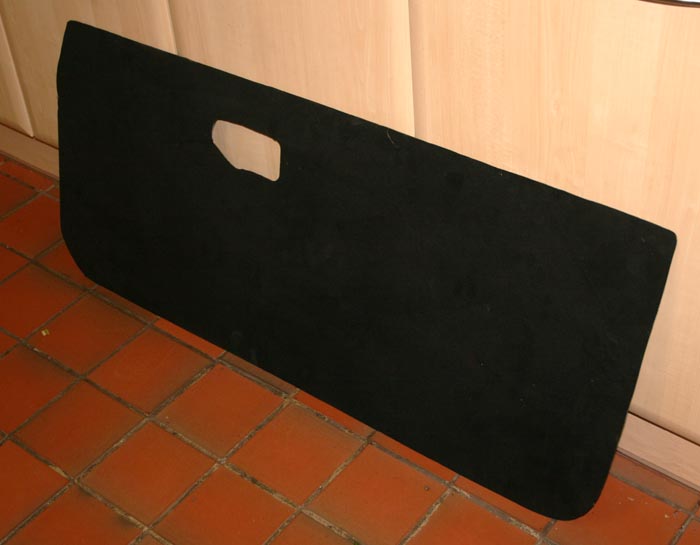

Once again with one of my mad ideas I’m looking to track Puglet in 2018 so the door cards are on the table to be replaced.
I have found some online that look to be what I am after and was wondering if anyone has made there own. Just so I can gauge an idea on depth of Perspex sizes and such.
Pictures to show example.

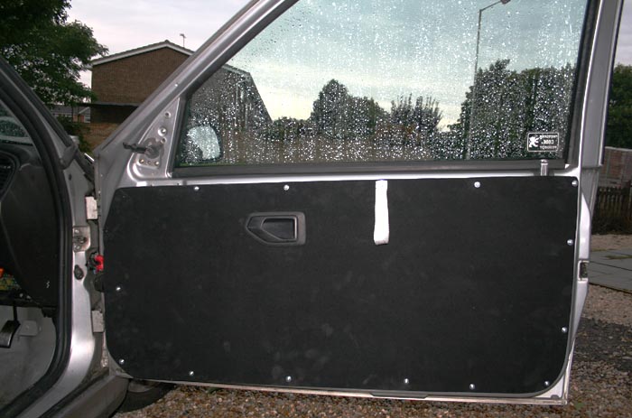

I've used 1.5mm ABS for mine. You can cut it with a sharp knife so it's easy to work with. Cost me £36 for an 8 x 4 sheet.
[Image: 20120704_212316.jpg]
(03-11-2017, 09:05 PM)Ben Wrote: I've used 1.5mm ABS for mine. You can cut it with a sharp knife so it's easy to work with. Cost me £36 for an 8 x 4 sheet.
I've just got 2mm sheet of this. On end of line discount £29 for 8x4 delivered
That's a good price. Delivery would have been great I had to bend it up into the car!
