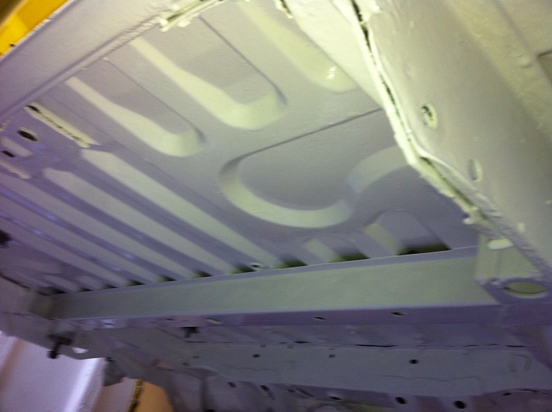

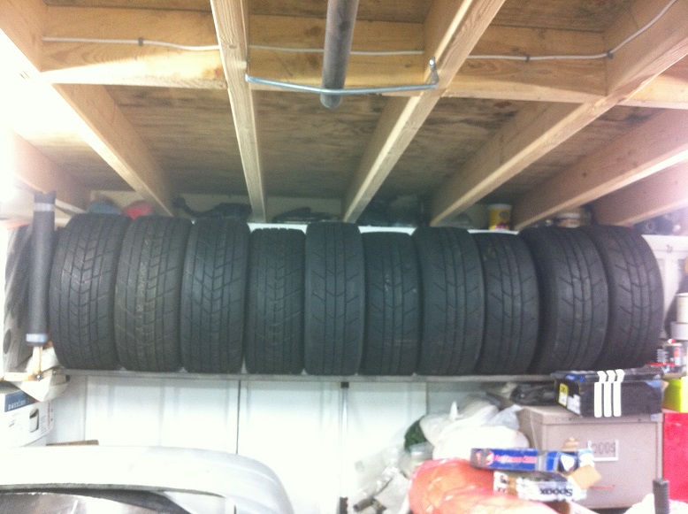

managed to do a bit on car today and garage ,needed to get more floor space , so started to make more tyre racking out of inch box section i had but just need peice for centre support wich will get when back at work , also while rear beam removed while getting wide tracked , cleaned up rest of floor and gave rust protection and coated with white  . will be back on car tommorow so will keep updated
Tyre rack looks great and so does that underside. Makes me sad seeing as ive had a look under my boot today and I can tell you now it looks nothing like that!
(26-12-2016, 07:07 PM)Eeyore Wrote: Tyre rack looks great and so does that underside. Makes me sad seeing as ive had a look under my boot today and I can tell you now it looks nothing like that!
Cheers , done the whole of the underneath now , wich had hardly any rust so wasn't to bad a job , just trying to keep on top of the car , don't want to do a load to it for it top be eaten by tin worm

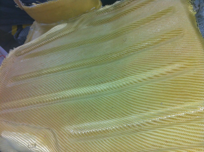

Been a bit busy to post on forum lately due to work , but still managing to do bits on car , have been making a few bits out of kevlar and carbon fibre for car , seriously thinking about rallying car so have made kevlar sumpguard for it , also sourced a mate who has maxi rear spoiler wich hes lending me so can copy , will post photos of parts as go along , only photo have at moment is of sumpgaurd as posted

photos of  kevlar sumpguard that have made for car now photo  download issue is fixed
Good stuff! Big Grin Liking the look of that sump guard! Anymore pics of the car as it stands now?

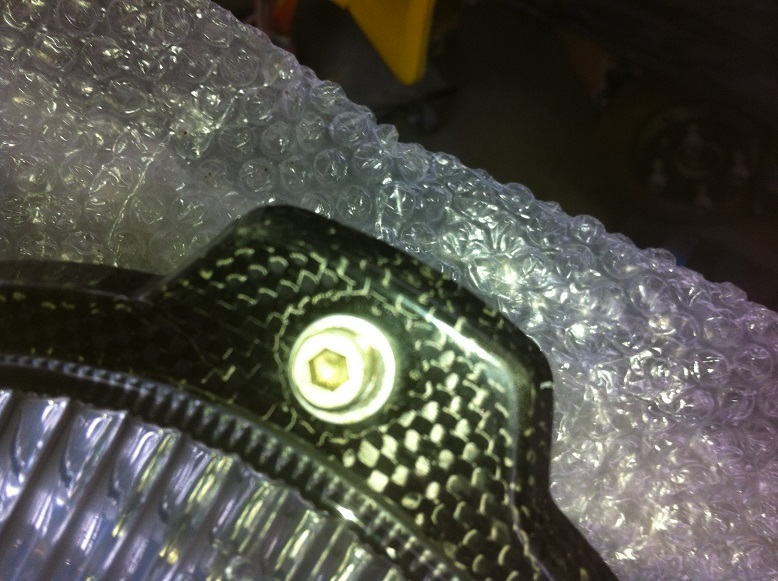

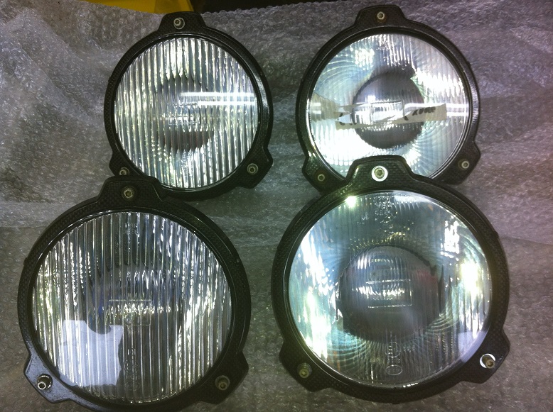

got delivered some brand new wrc gas discharge lamp pod lamps aswell , with carbon fibre mounting rings , as will be needed for when start rallying again
Loving the lamps! what pod have you got to mount them in?

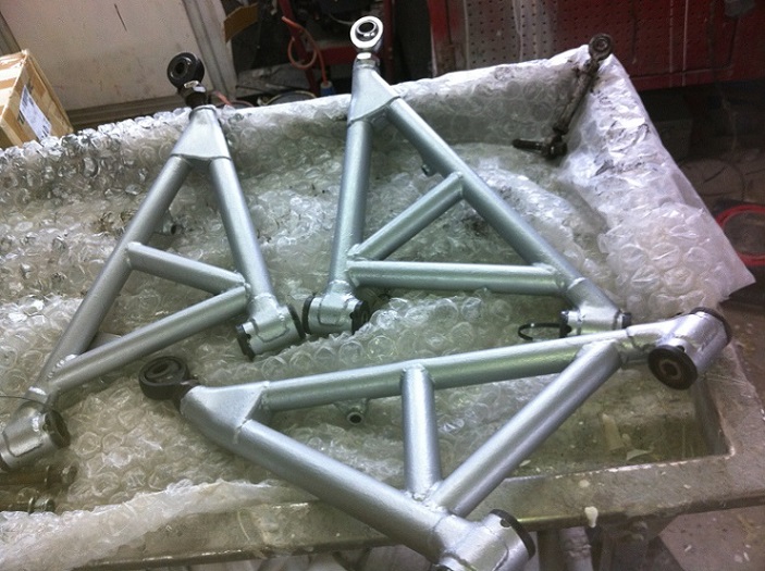

i am getting  a proper maxi lamp pod matt ,  also these are the rosejointed maxi width tubular wishbones for the car , they are a good 40mm wider than my other pts tubular ones and 10mm more castors,

Matt the new wish bones are 40mm wider either side compared to the pts tubular ones I had on the car , with adjustment in outer rose joints , so can go wider for more camber , there was photos of the pts one on my thread , but not sure if they were messed up when had problem with forum photo downloads so will post photos of others later
standard width pts tubular wishbones photos ,
This is a stupid dumb question from me but what makes these better than the original shape wishbones? How much better and why? Smile
(27-03-2017, 10:18 PM)MY95 Wrote: This is a stupid dumb question from me but what makes these better than the original shape wishbones?  How much better and why? Smile
not a dumb question , the black ones in above photo are peugeot talbot sport grpA ones wich are a adjustable rosejointed outer , so can run more camber , they are tubular as a lot stronger and also use alot harder inner bushes to cope with rigours of rallying , the silver ones higher up page are maxi width ones , again adjustable outer rosejointed , and tubular for strenght , with harder inner bushes , but are 40mm wider either side and run 10mm more castor than pts ones , so wheel sits centre of maxi arch , hope this answers your question mate
That's spot on cheers Smile loving the colour choice you have went for too! Hopefully see you at Pugfest/FCS this year Smile
(27-03-2017, 10:37 PM)twangy Wrote: the silver ones higher up page are maxi width ones , again adjustable outer rosejointed , and tubular for strenght , with harder inner bushes , but are 40mm wider either side and run 10mm more castor than pts ones , so wheel sits centre of maxi arch.

The black pts one are available from special tuning uk , the maxi width one were made , I make or get some things fabricated for the car , as keeps the budget down mate , otherwise would cost me a fortune to build , thanks wayne
