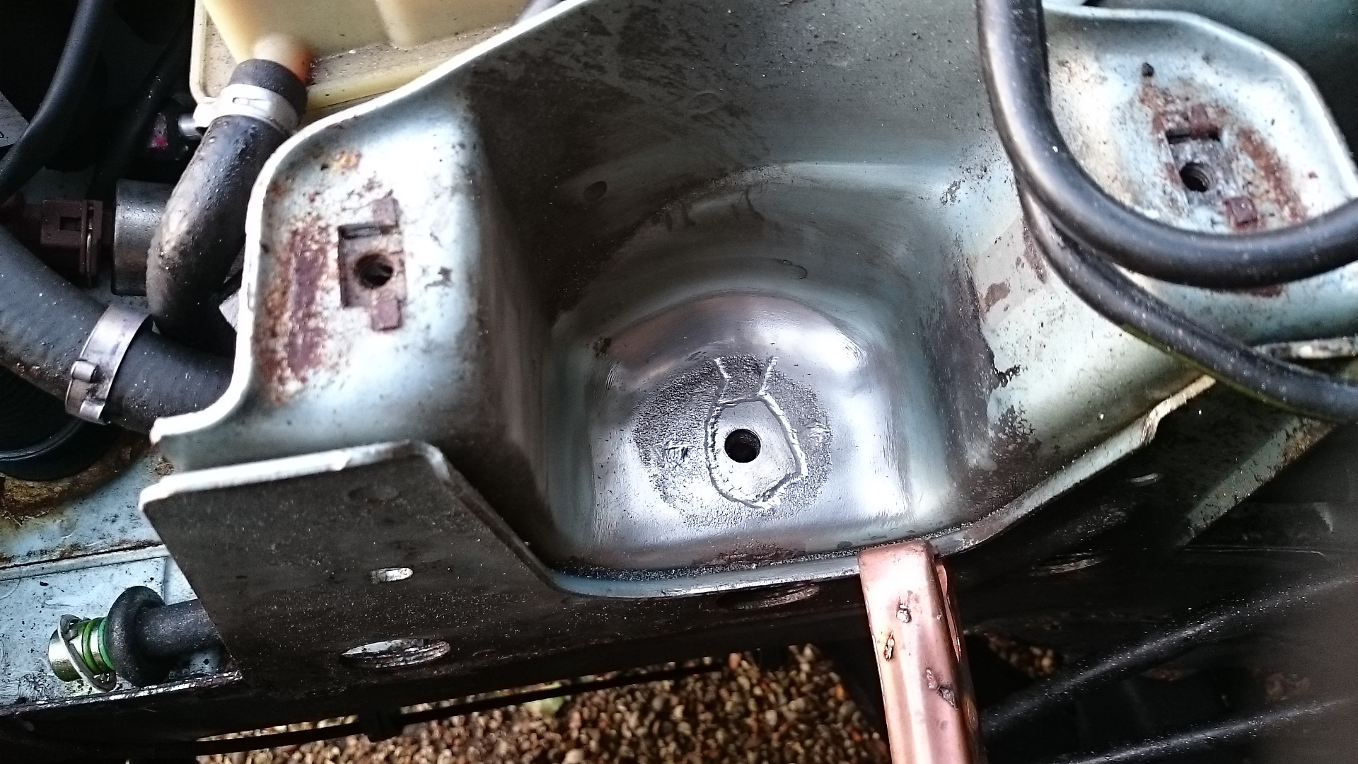

What was supposed to be a productive late afternoon of little jobs to get ready for the engine in the bay...
That was after I had ground the cracks....
Welded them. Welded in a plate. Broke out the hammerite.
Slapped in the new mount.
Here is to tomorrow.....

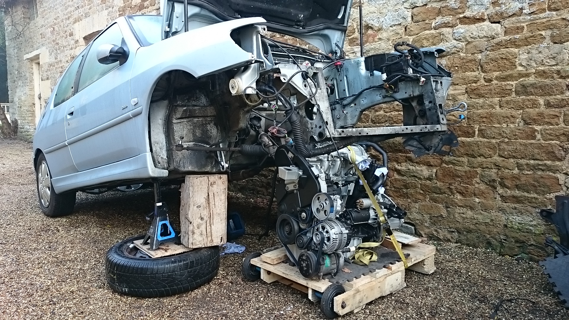

think I have ballsed up... can you see where... amongst all the bodgery?
...before you ask.... I have no engine crane... but I have will power and a little but very excitable brain. lol
I love the ingenious way of getting the engine in
Looking great dude
Rocker cover oil cap too high?
(30-12-2016, 08:57 PM)Paul_13 Wrote: Rocker cover oil cap too high?
Yeah.
I messed up asuming 206 and 306 mounts were the same. Gotta do it all again with a 306 mount. Hey ho.
Makes that video a bit rubbish. I'll save the mount...never know where the engine may end up

Engine looks like it's leaning towards the gearbox side?
(01-01-2017, 08:02 PM)Dum-Dum Wrote: Engine looks like it's leaning towards the gearbox side?
Yeah. Its cambelt end thats the issue.
My mistake. Confusion about 206/306 mounts
Good to see it in and on mount even if it is a little wrong first time around Big Grin

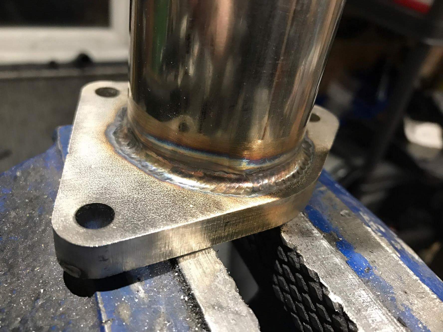

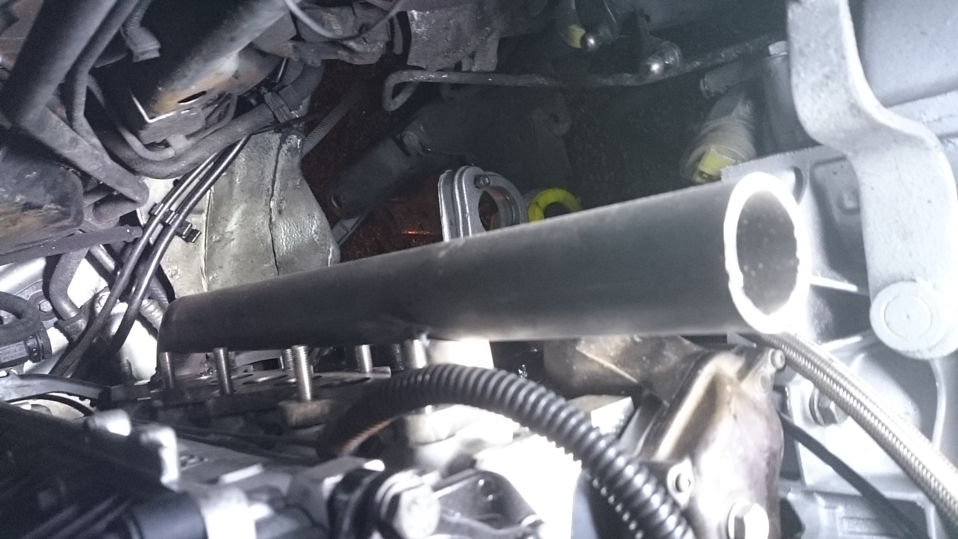

Log manifold, really?
Scaffold tube?

Seems a bit thick walled for a manifold doesn't it? Or just for mock up purposes?
Yup.
Nope.
lol
Nope.
scaff tube ftw
i'd be using steam pipe or thick walled pipe of some description if i were doing another turbo manifold.
so much more added strength.
log ftw!
This is seamless thick walled stuff. I want it strong as can be/longevity.
I've been following this as I'm interested where you're gonna go with it but I have to but in... log manifold after all this hard work???? Please tell me it's a joke
(12-01-2017, 04:53 PM)Piggy Wrote: This is seamless thick walled stuff. I want it strong as can be/longevity.
ive never seen seamless break? only poor welds etc. If its purged it will never crack.
90' 205 gti6 supercharged
05' Evo 9 IX GT
Team eaton.
Right im gonna throw my 2p in now. Whats wrong with a log manifold? As long as its a good size it should be fine. Im yet to talk to piggy about his power "aims" however most atuff this will be fine for imo. If his really really gonna push it to within the last inch of its life then maybe it could be better. Ive seen some friggin quick cars on log manis
(12-01-2017, 06:23 PM)bashbarnard Wrote: Right im gonna throw my 2p in now. Whats wrong with a log manifold? As long as its a good size it should be fine. Im yet to talk to piggy about his power "aims" however most atuff this will be fine for imo. If his really really gonna push it to within the last inch of its life then maybe it could be better. Ive seen some friggin quick cars on log manis
There's no doubt it'll work and make good power it's just not the most efficient way of doing things, but as said I don't know what piggy wants out of it or where he's going with it, turbos work off exhaust pulse which I'm sure you know, a tubular/collector style manifold will have very little turbulence maximising the energy given from the exhaust pulse, a log style manifold generally has a lot more turbulence which will cause the exhaust pulse to lose energy making the turbo spool slower and lose power top end, But if it works for what he wants it for then fair enough but if you're trying to get the very best out of it it's not the most efficient way of going about it Smile
A log manifold is the worst type of manifold for power.
I suppose with all the effort and attention to detail that's going into this I'd just expected the manifold to be done to the same standard.
