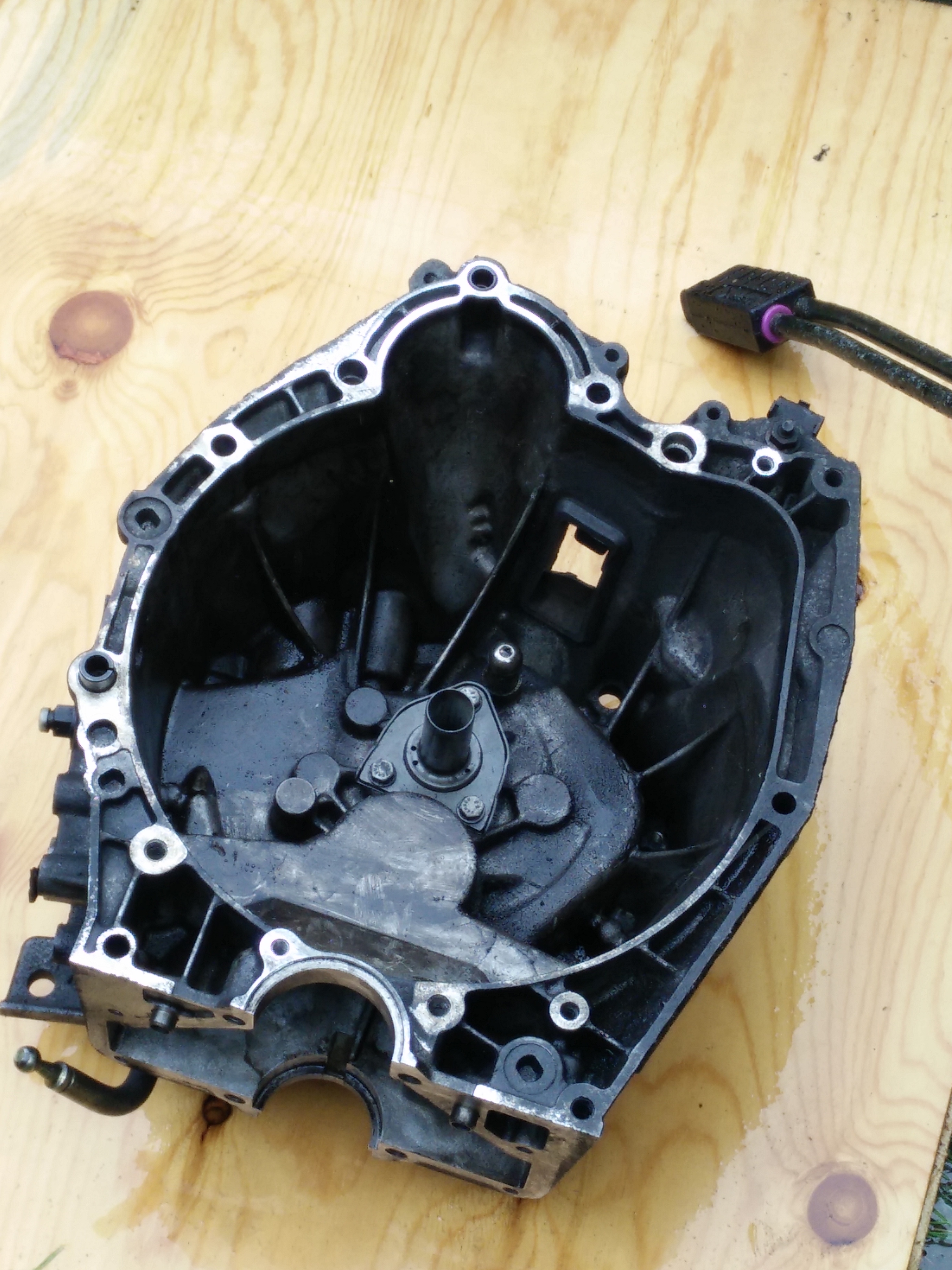

Pictures of the old gearbox dismantled :
And washed
And a closer look at the crack in the housing.
The housing can not be used unless I was to weld it :-) at the moment I have gone for the solution of tearing both gearboxes apart and hopefully end up with one that is okay.

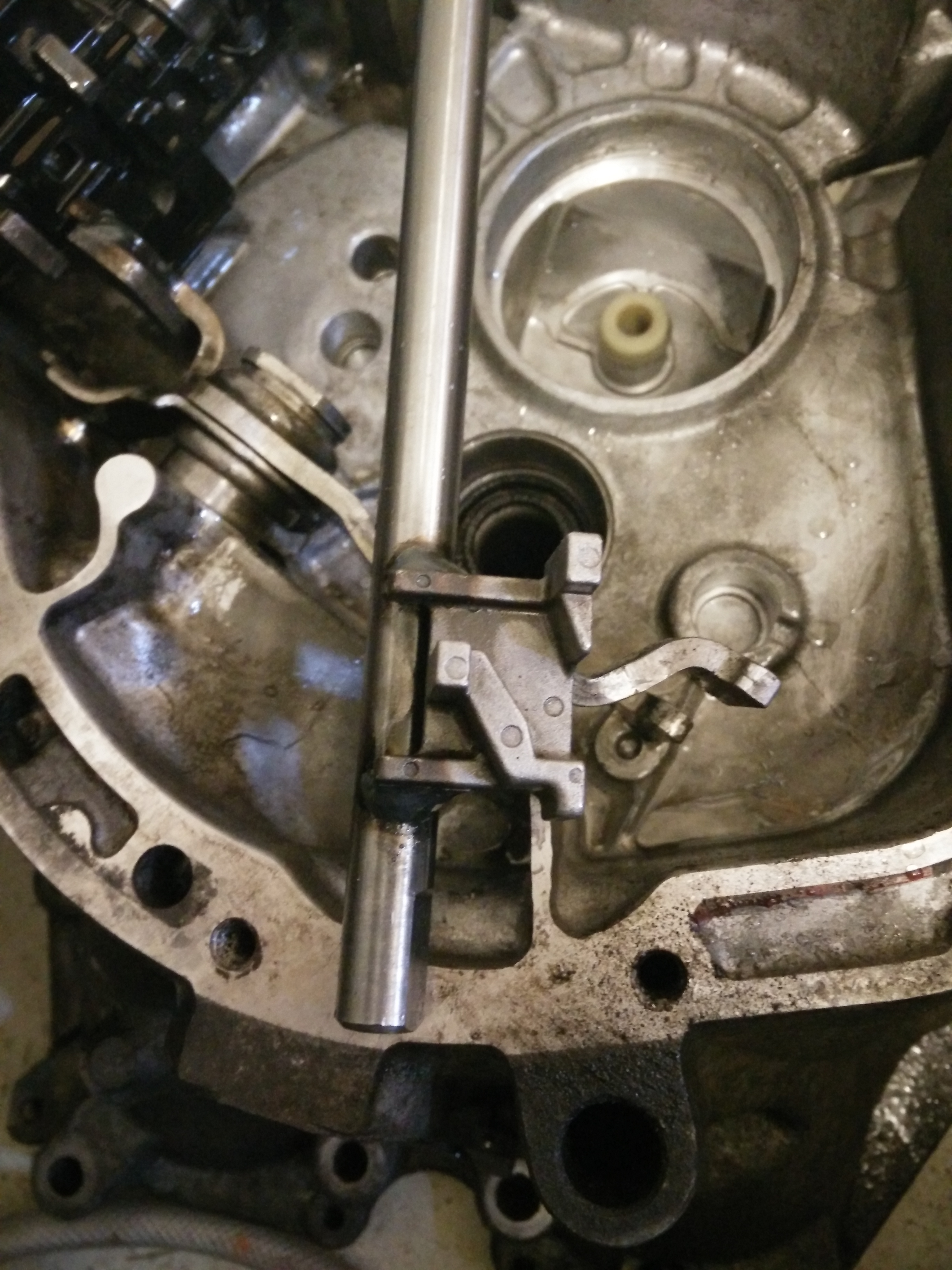

the fifth gear lever is also different in the two boxes. see pictures :
The old one :
which have two welded points and is thinner at the welding points.
the new one :
Which only has one point of welding, but the bar is not thin?
i don't know right now which one I'm goint to use.

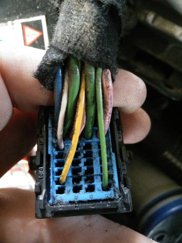

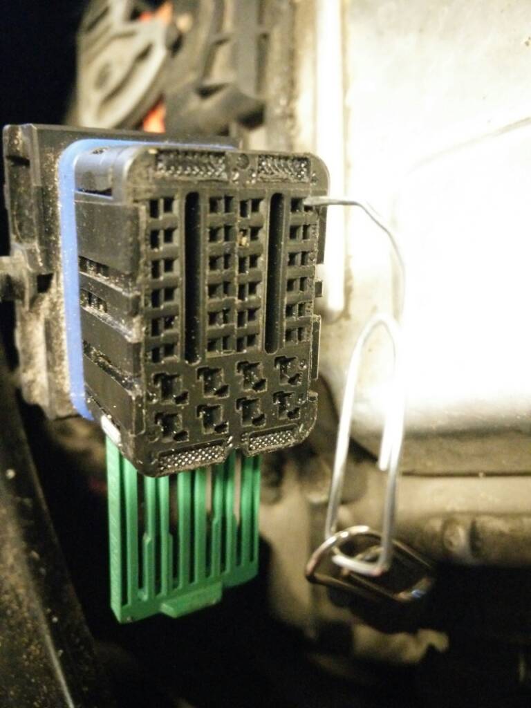

Okay so I have been tinkering around in my garage again. I needed a break after the transmission fight. But my mate just called to tell me that my turbo was done/finished. So hopefully over the christmas holiday I will install the gt2256v turbo om my 206. And hopefully get the vnt to work and here comes the tinkering. I have moved the wire (green) from a4 to b4, being from egr to vnt pin.
I used a paper clip to loosen the wire.
Then I checked the wire went to the egr plug which fortunately did.

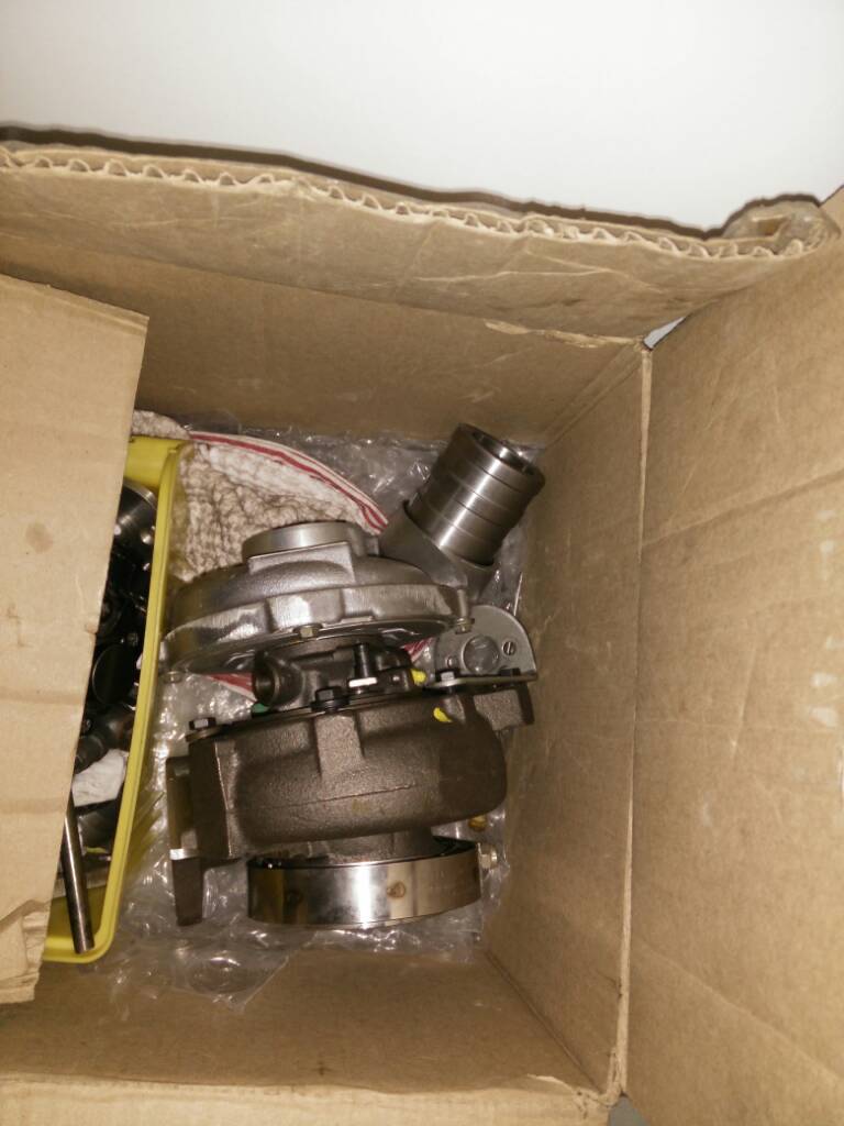

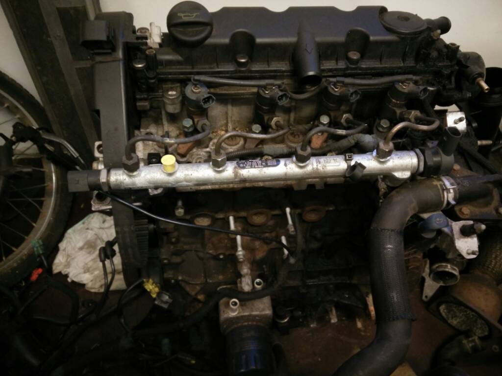

Below are some pictures og my turbo and the fuel rail I'm planing on using.
Until next time merry christmas
Sendt fra min A0001 med Tapatalk
Why the different fuel rail!?
Because I'm planning on using a audi 2,7 high pressure pump. The control on that pump isn't the same as on the standard but the one on the fuel rail should be similar.
