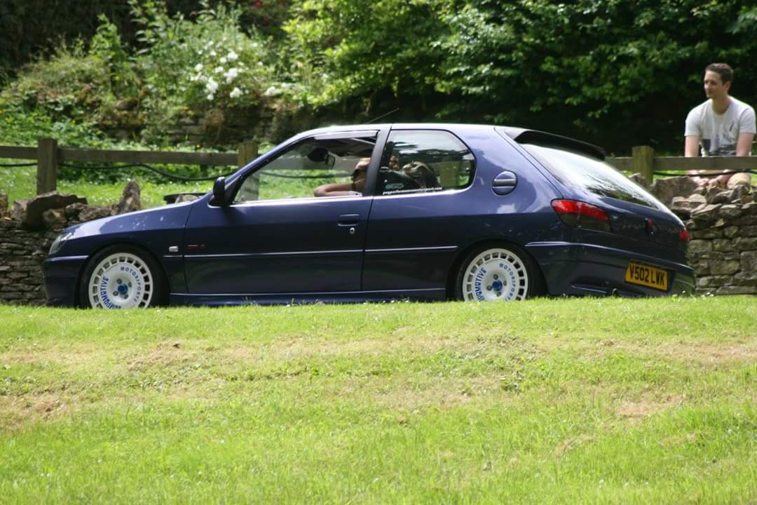

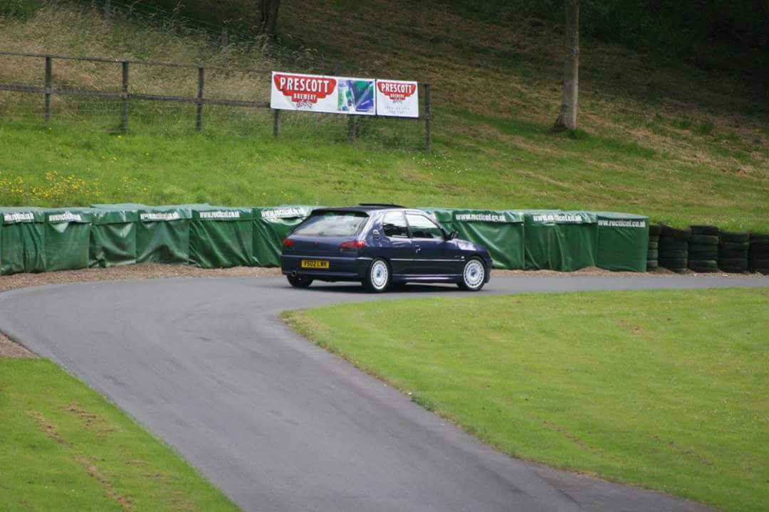

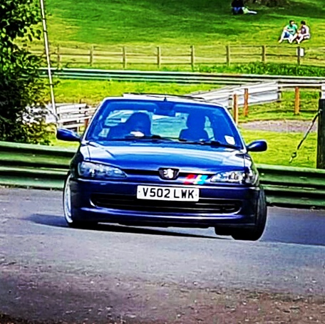

Pugfest 2016:
Camping was awesome, people were awesome. Good times had all weekend.
The car was pretty good considering how last minute it all was with changing the springs the morning I left etc
Problems I had on the hill :
The quickshift kept slipping making gear shifts pretty sloppy and I lost reverse a few times over the weekend lmao
Power steering I'm quite annoyed with, it was working alright on the way to Prescott but after my first two hill runs it was cutting in and out, usually on the hardest corners which was a bit exciting :p
Got a few jobs to occupy me this week and then just enjoy the car for the rest of summer :Smile
Couple of my favourite pictures so far :
That last picture is ace! Big Grin car was performing well just needs ITB's and fine fettling Big Grin

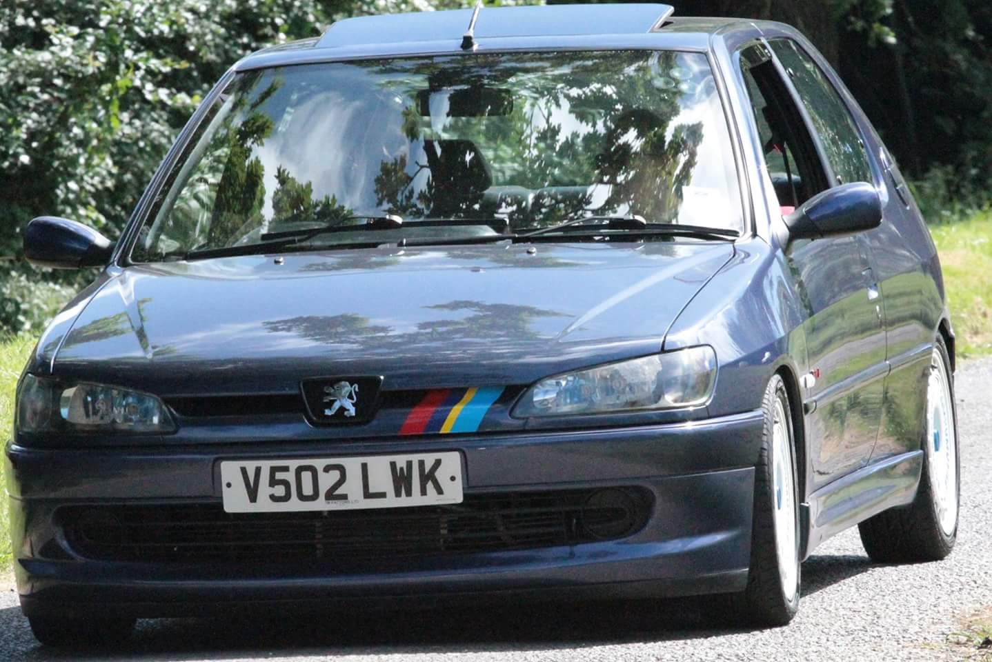

Few more pictures :Smile
Fixed the pugfest issues now (hopefully)
Found out only 1 cooling fan was working so sorted that to get both slimlines going with the override mod.
Aquired a 106 epas wiring loom off Matt, changed the relays and switch and my pas situation has got alot better. I think the issue was the relay I was using was suffering from overheating.
Sorted the quickshift permanently (until I get a satchshift anyway)  by running a bead of weld around the collars. Try bloody moving now!
Didn't get much of a test drive on the way home as I was in a police car sandwich lol
