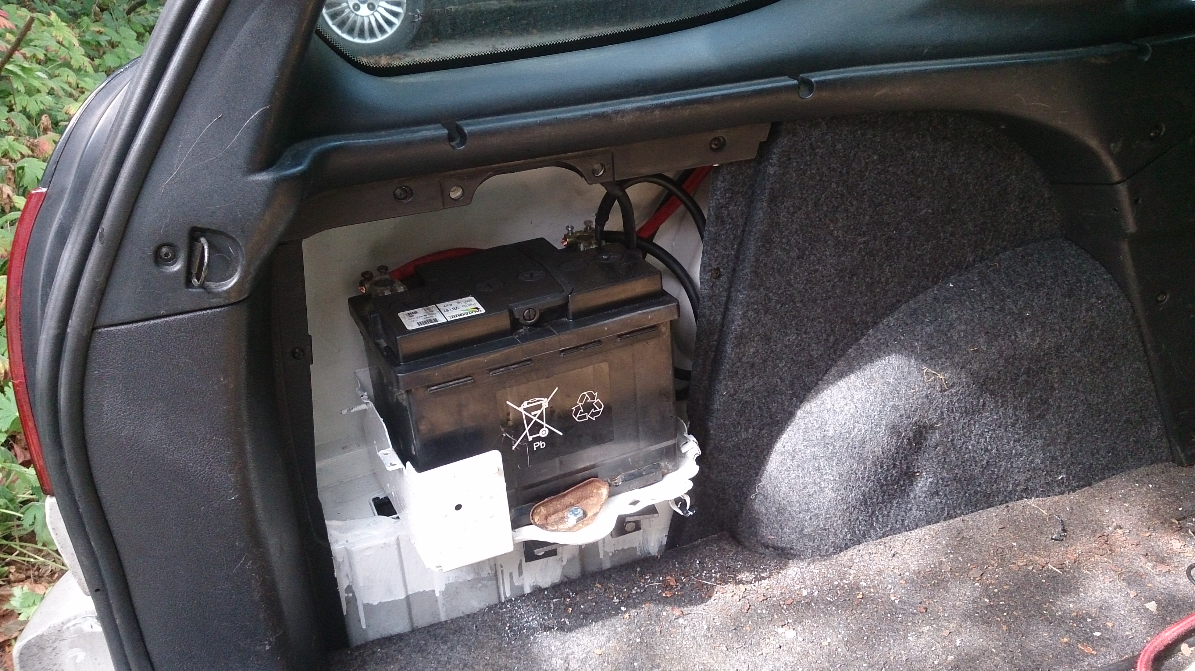

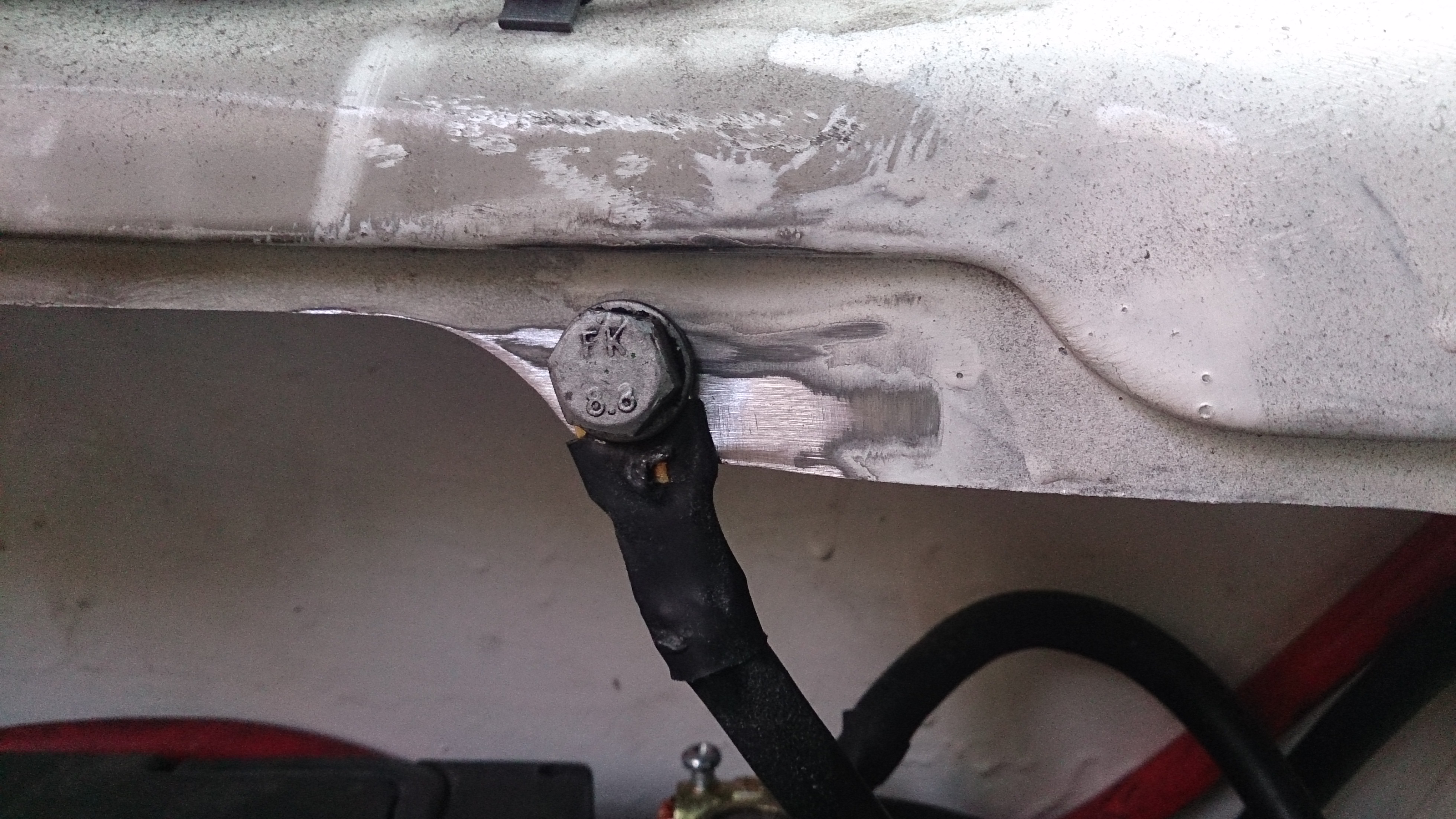

Where did you earth the battery in the boot jekyll as I've relocated mine and on my volt gauge I'm getting like 3 volts lol then it creeps to 11 volts after about 5 seconds then when I try starting her the starter just clicks and nothing happens
(03-04-2016, 09:17 AM)mattydturb Wrote: Where did you earth the battery in the boot jekyll as I've relocated mine and on my volt gauge I'm getting like 3 volts lol then it creeps to 11 volts after about 5 seconds then when I try starting her the starter just clicks and nothing happens
I needed about 4 earths to get mine to have a decent earth in the boot of my estate
Cheers for that dumdum I've kind of got mine working now I've just put a nut n bot threw one of the holes already provided in the boot floor took it down to bare metal on both sides and now I'm getting 11v on a full battery so might have to put another earth on like you've done
Sorry liturally just seen this. Im earthed under a seat bolt. Found the biggest issue was forgetting to upgrade the engine earth for me

i used a light bolt hole and never had an issue once. ill take a pic when im down workshop next. as long as its clean both ends you should be fine
