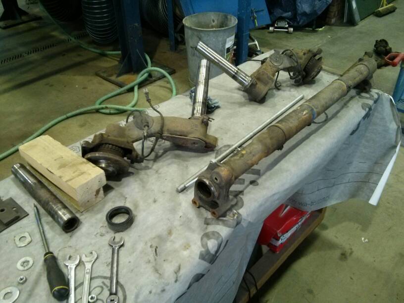

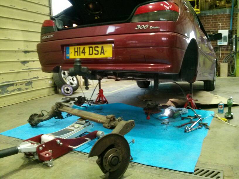

P bushes, I did Tue rear axle on the car and it improved the situation about 75% and now have a new set of wishbones and balljoints to go on.

Not much you can do about the beam though, that's expensive whichever way you go as there aren't many decent used ones left now.
True haha. Mind you I think once I have got it handling good I will want to keep it and make it really nice Smile so probably will be worth it
I did the rear axle on my hatchback this weekend. Massive pain in the arse rebuilding the fucker.
