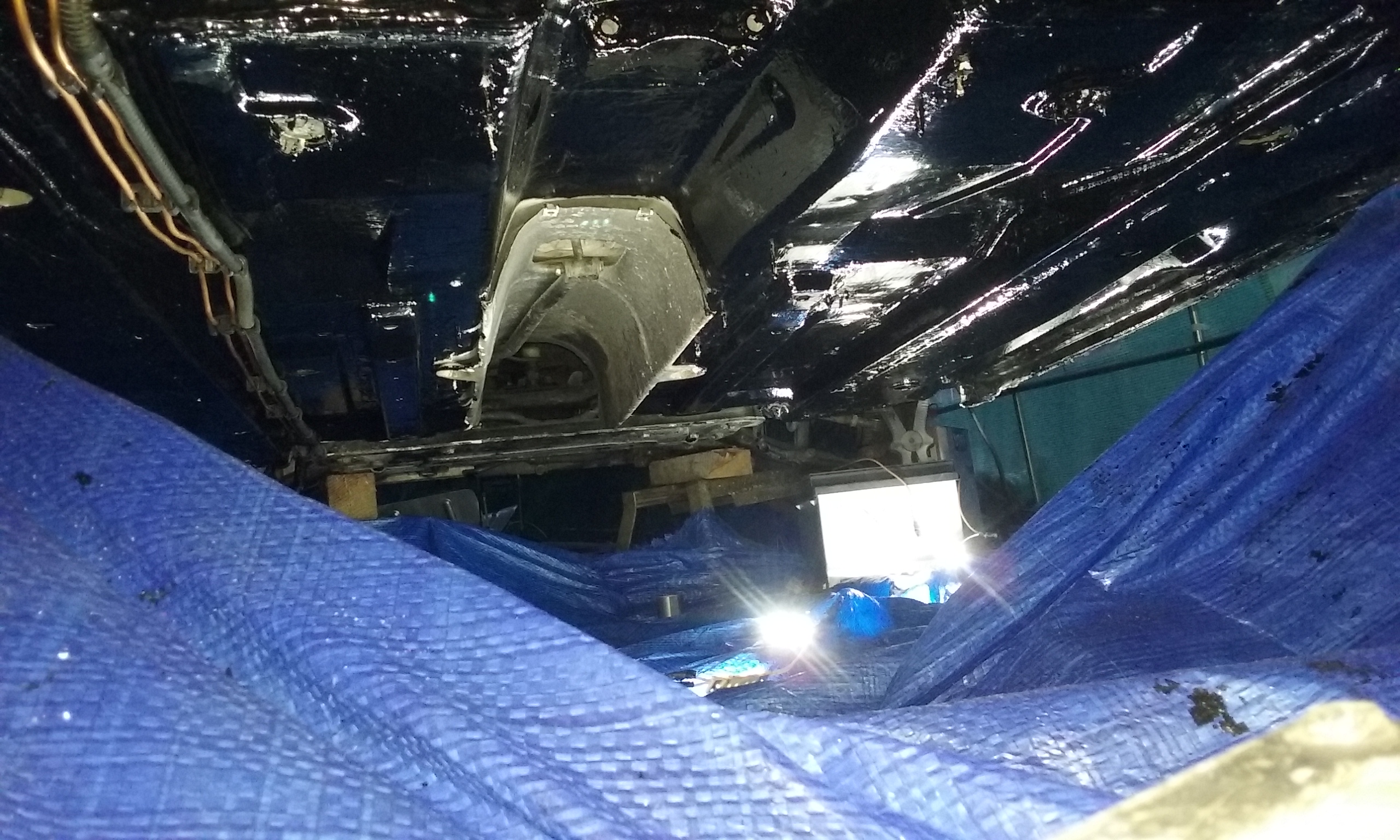

Well ive had my rebuilt cab on the road for the last few months and as good as it goes there is one major issue clouding the overall experience.
I stripped the cabriolet leaving only the engine and box in. The underside was stripped to bare still etc etc and now looks good.
Rear beam rebuilt by imaxles
New rear dampers and mounts
Calipers rebuilt  all round
New gearbox mount and engine mounts and lower arms and front shock absorbers etc.
The issue im having is... Drive below 50mph and everything is fine.
60 or above and any amount of steering i.e to overtake on the motorway or to take avoiding action for example. The rear feels like its a few seconds behind the front steering input.
