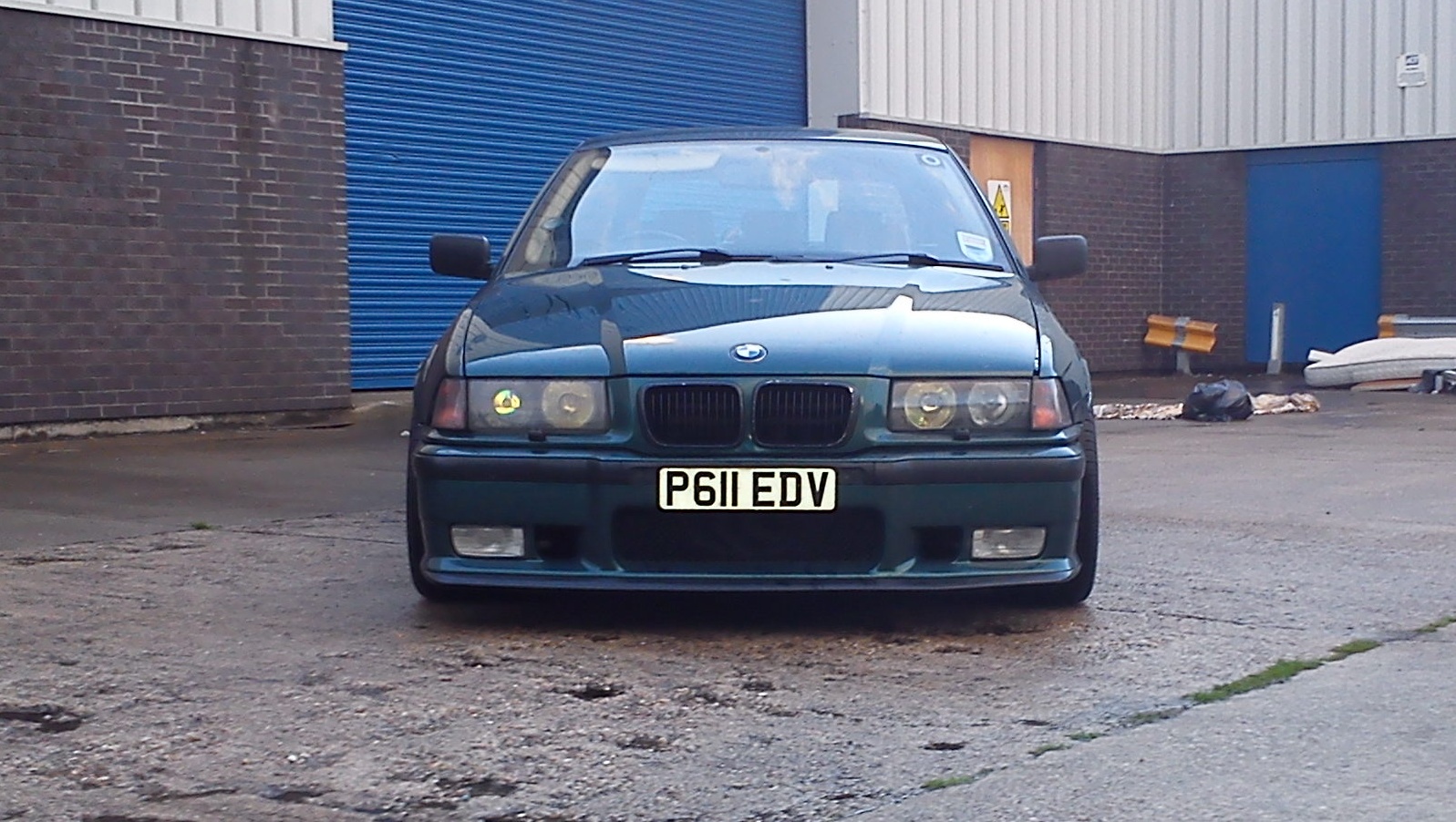

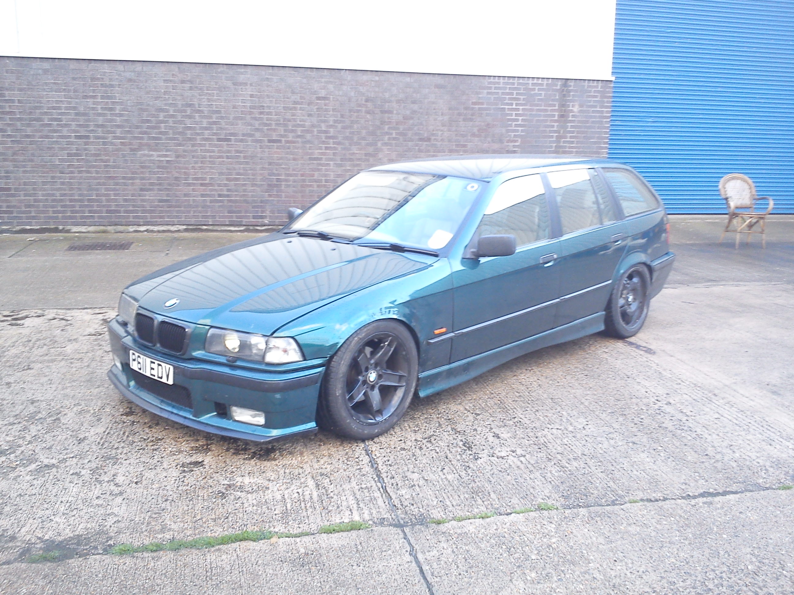

Ended up buying the brembos as i got them at the right price. Gonna see how much more i can roll the arch. If i cant get the fronts wide enough it might be time to get some arches. Always wanted to avoid becoming another "meatwagon" but at least the arches would be for a genuine purpose. Only other option is to have the front steels parted and the dish reduced up front
