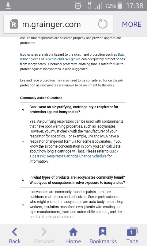

Depends on the molecule size of the fumigation chems vs isocynates. The problem with the isocyanates is it will penetrate straight through a normal mask, you almost may as well not be wearing one as far as they're concerned.
Found this...
Says there are certain masks that are suitable for protection against isos

its a long term damage thing with isocyanates, and the other chemicals in there.. air fed respirators are fine, but there are suitable filter type masks that are capable of removing volatile solvents (but most are not).
