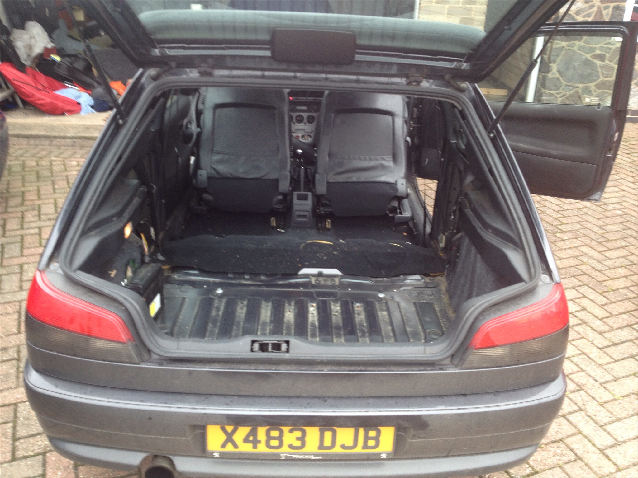

Right-o, update
Stripped out;
Cage;
Needed painting, so decided to change the colour;
And in the back!
