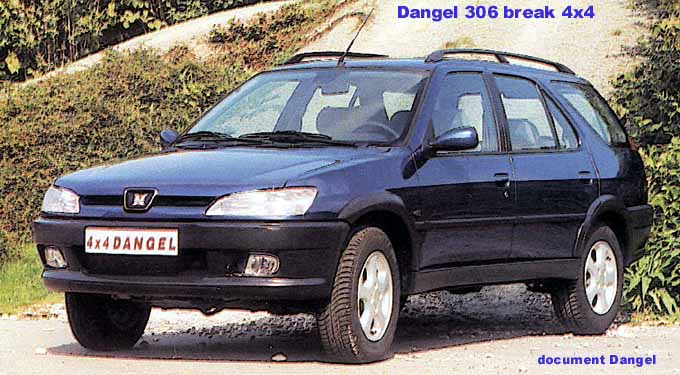

Google "306 dangel" this will give you naughty ideas although I'd prefer a 505 dangel
(15-12-2013, 05:12 PM)Dum-Dum Wrote: Google "306 dangel" this will give you naughty ideas although I'd prefer a 505 dangel
DANGEL! that's the word I was trying to remember earlier. ta Tongue

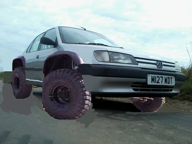

a quick render using only the finest software...LOL

like this
i suspect you could get an extra 1" - 1.5" over standard, on standard equipment. space to top mounts out and raise the torsion bars with some shock spacers aswell , and it wouldnt stress stuff to much, i cant see have that would stress any more than a 70-80mm drop which i run on all our 306s, Then get some 13-14" 8J banded steels with some chunky tyres & add on arches

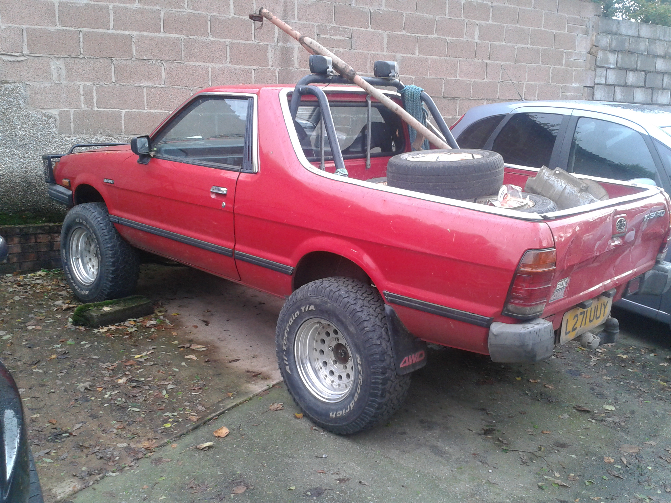

my friend is building this pickup into a mini monster for himself
no lift kit available for it so he is fabricating all the plates/blocks himself
think he said its havong a 6inch lift with larger tyres
is that with the kit? looks stock lol

(16-12-2013, 06:06 PM)John1.4 Wrote: is that with the kit? looks stock lol
yes the lift is done remember the subaru pickups are car based not like a hilux Wink
