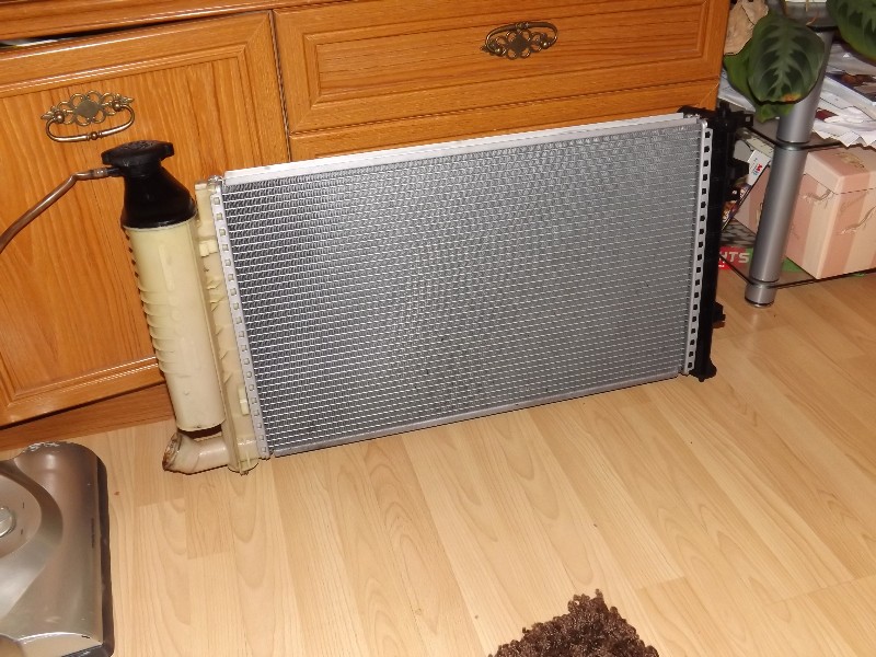

nice new S/hand alloy radiator Smile
Looks almost new.
(29-11-2013, 08:04 PM)Dum-Dum Wrote: Looks almost new.
wrong forum at the right time
less than 2 month old Wink
