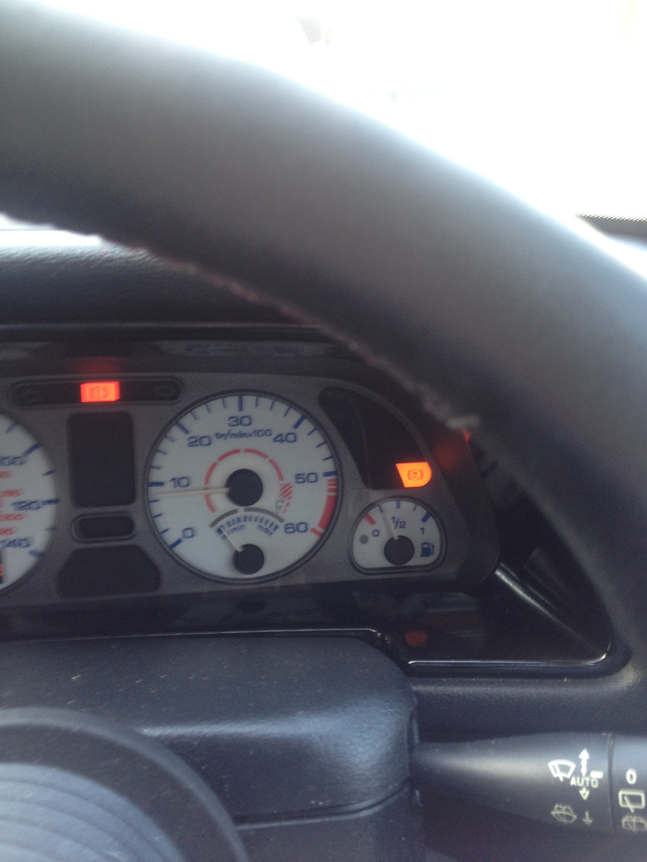

Soooooo as of Friday, my light saying I have no traction has been coming on and staying on, anybody have any thoughts as to why?
pic:
I am clearly parked up so how I have lost traction?? :S
thanks in advance
Check your MAF
its the ABS light
[Image: sig.jpg]
Thats the ABS light, check the fuse and if not get the codes read to tell you which sensor it is.
Its defo not a MAF sensor issue
Hmmm after putting my glasses back on my face I can see now it is a ABS light loool
ok sound, will have a look tomorrow. My abs still works though?? I tried it yesterday.
+ had a blonde moment and forgot it was called ABS!! Tongue
I wish 306s had traction control. Sad
If the light is on, the ABS won't work, it defaults to 'off' as a safety precaution.

Back on topic, my ABS definitely doesn't work when this light is on, tried it out tonight, forgot my seat was broken!! Lol anywayssss, it's not on constantly, like earlier, 30 minute journey, it came on 5 mins before I was home but when it's on it stays on, what could be causing this? As don't you nee the fault to be showing for it to come up on a diagnostic?
Could somebody also tell me where the fuse is located please as I never got an owners handbook or manual or anything g like that when I bought the car.
Thanks again
I already told you it wont work with the light on. Tongue And everyone is calm... Or atleast I am, maybe Nialls raging at the fact I like an electronic driver aid, I dunno. lol
On topic though, it's probably a dirty ABS sensor/ring, I'd check those first. If they look clean try a voltage test - basically connect the sensor to a multimeter and you should see a voltage as you spin the wheel. Also I believe you can see the ABS logged faults without the light on but not totally sure on that.

mine was the same, the abs ring on the nsf had snapped. 99p replacement of ebay, i just beed to fit it now get it fitted now.
if it is down to a damaged abs ring make sure you find the correct one as their are 2 types fitted.
one with teeth and one with small rectangular holes
