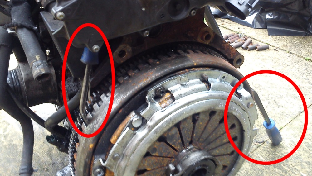

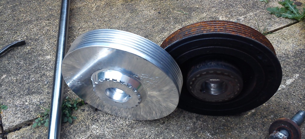

So today I decided that before I remove the original clutch and flywheel from the 2.2 I'd remove the crank pulley so I can do the cam belt and more importantly swap to my shiny lynx one. Anyway the gun wasn't man enough to undo it so I had to use the breaker bar. Sadly I couldn't find a decent locking point for the flywheel so used my ingenuity, enter stage left Mr and Mrs pry bar. One jammed wasn't enough so I had one wedged between the flywheel and the head and the other between the flywheel, the floor and my foot while stopping the engine falling over with my knee. Anyway don't try this at home kids as I thought I was gonna snap the pry bar but eventually it came undone.
Decided that I'd better check that the pulleys were the same and fortunately they are.

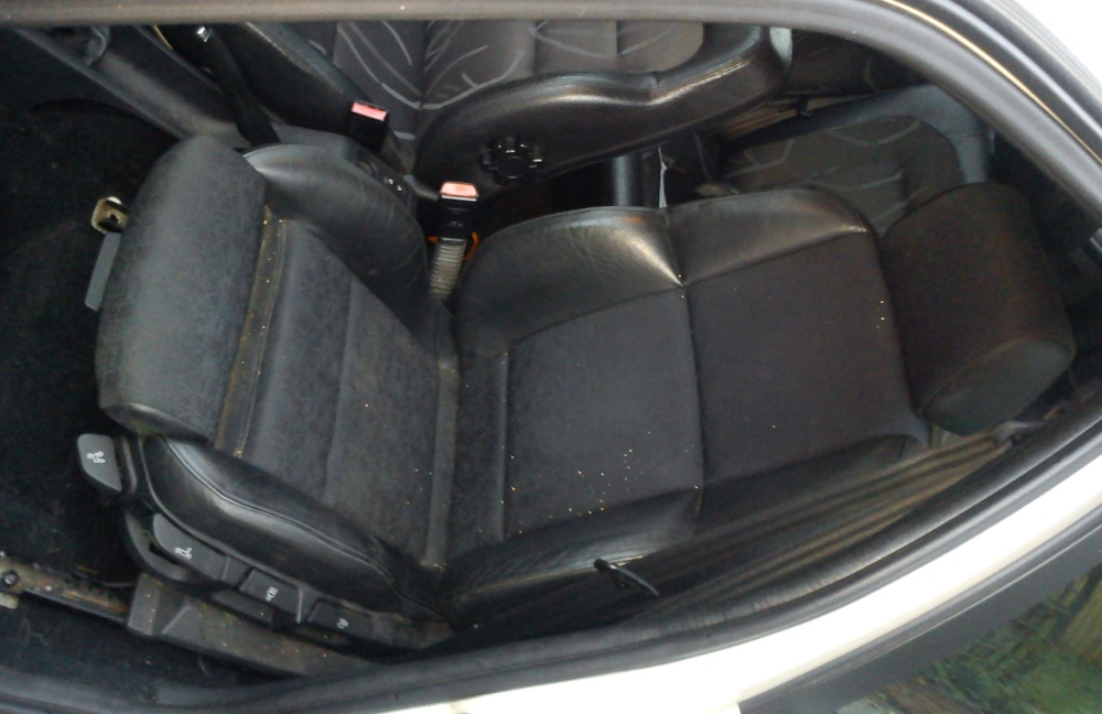

Anyway I've been to wales today and been reminded of why I hate the welsh police but I've picked up a new interior. Any guesses what its out of?
I might see If it bolts in tomorrow depending on how hard its still trying to rain.

(20-10-2013, 04:12 PM)Chris Wrote: E36/46 half leather sports interior?
Damn you your right, E36
This didn't take much guessing haha.
[Image: signaturerrf_zps1c82612b.jpg]
The side bolsters and pattern of the fabric give it away. Coupe interior by any chance.
[Image: sig.jpg]
(20-10-2013, 04:15 PM)Chris Wrote: The side bolsters and pattern of the fabric give it away. Coupe interior by any chance.
Dont remember mate.
I think they need to go in my car, it would be much easier Wink
You think they might fit straight in?
Turns out it was a coupe.
(20-10-2013, 05:12 PM)tenwierdufos Wrote: I think they need to go in my car, it would be much easier Wink
It would but much less awesome, you can have the rears if you want for a beer or 2
(20-10-2013, 05:35 PM)Tom Wrote: You think they might fit straight in?

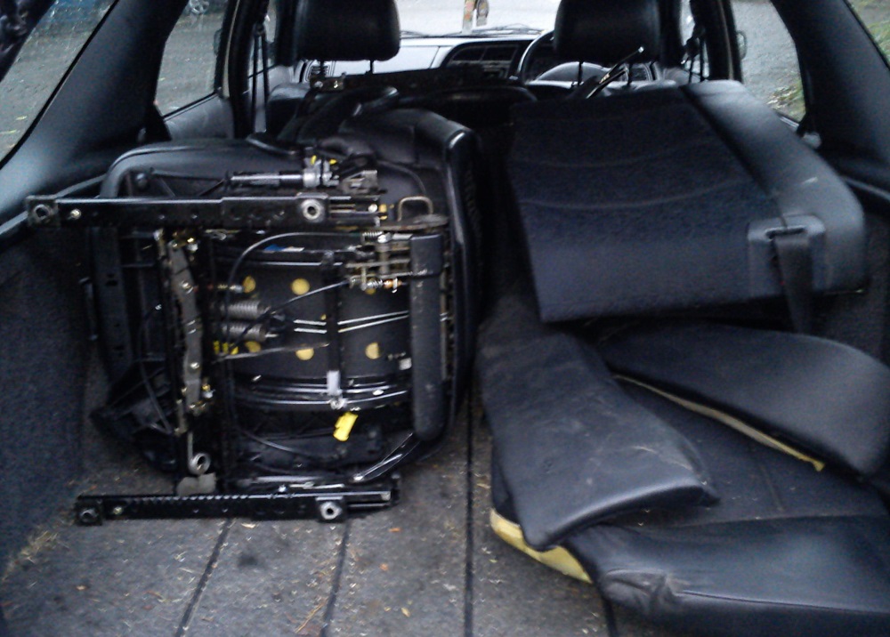

I was hoping that although the distance between the rails is narrower on the BMW seats (by about 40mm) the fact that the BMW has big holes for its mounts and the 306 mounts slide would mean I could get away with it but it doesnt look like I can. The BMW rails are also about 100mm longer.
That said I got the passenger one in on the nearside front bolt and they are sooooooooooo comfy, with the height all the way up and the headrest up it will touch the roof but with it down itll easily slide back far enough to touch the rear seats. Cant wait to see if i can actually get them fitted tomorrow.
look forward to seeing them fitted. IMO, the seats is the biggest let down of the 306 but then i think that might just be something that tall people suffer from!
(20-10-2013, 06:12 PM)Niall Wrote: look forward to seeing them fitted. IMO, the seats is the biggest let down of the 306 but then i think that might just be something that tall people suffer from!
I think part of the issue is the angle of the base as well as not going back far enough. These BMW seats although wont go any lower are a huge amount more adjustable and will give me a huge amount more front leg room, As I said above, theyll happily go back far enough to touch the rear seats so you cant do any better than that.
The only downside is they weigh an absolute fuckton they must be about twice as heavy as the 306 ones.

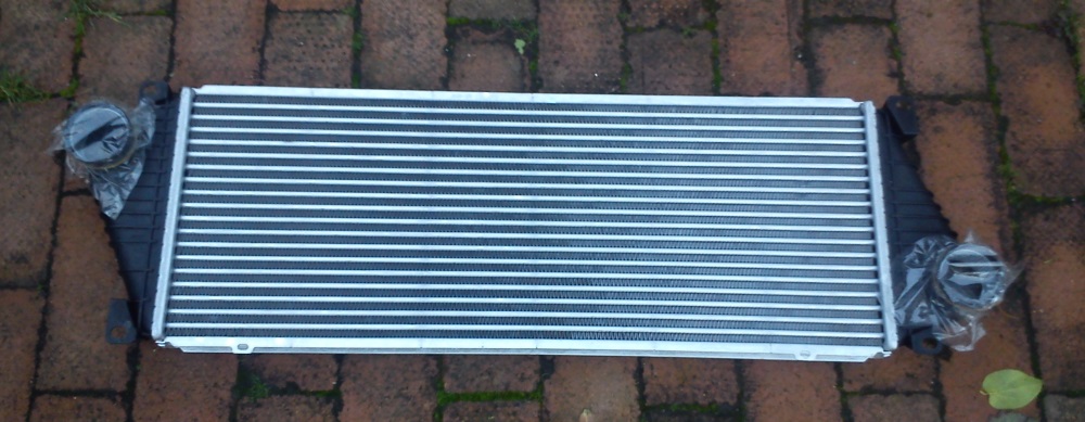

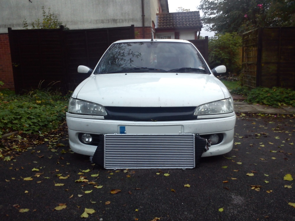

So my intercooler turned up today. Was hoping it was going to be very close to the Iveco daily coolers that I like but its wider, taller and not quite as thick however the pipes are 2.5" both sides. sub £50 brand new delivered is not to be sniffed at though.

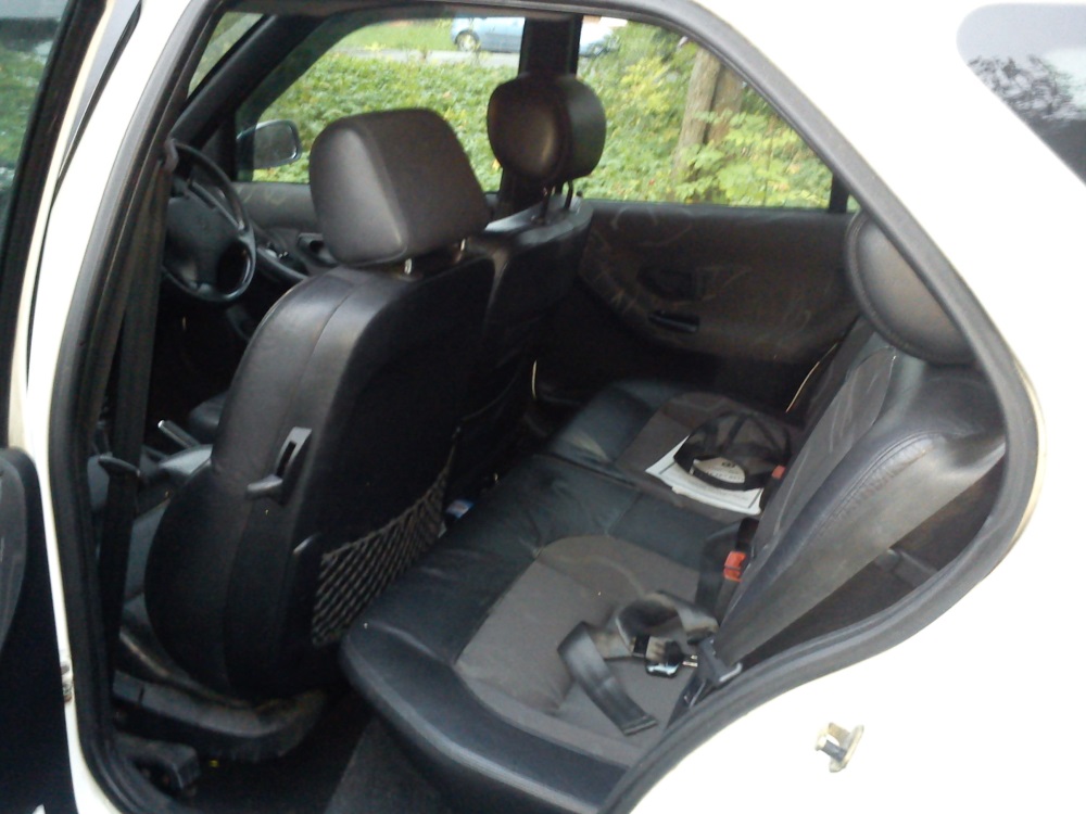

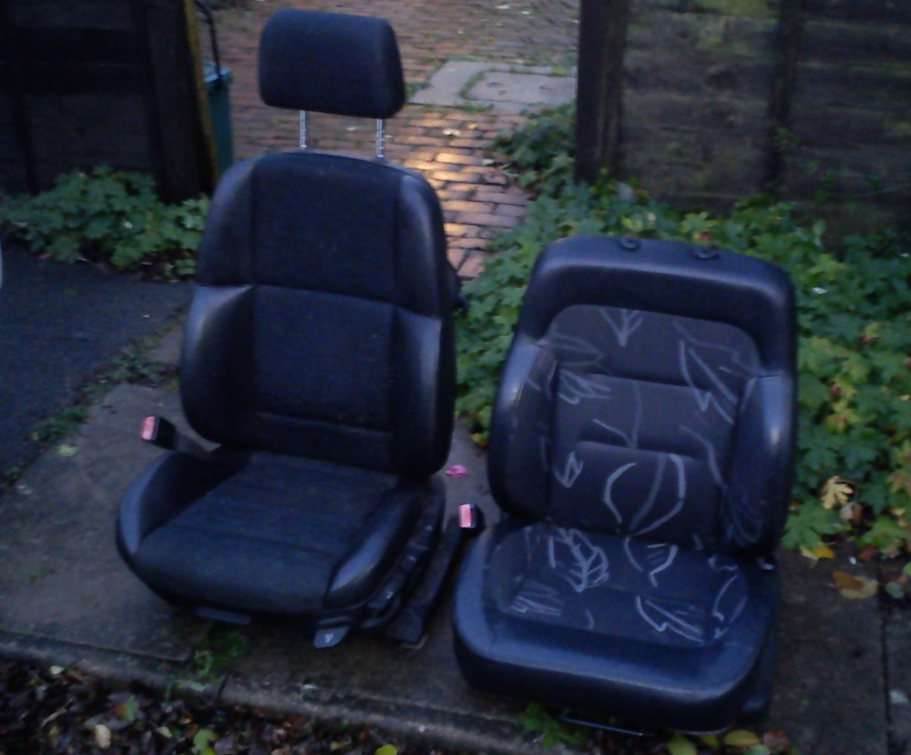

Heres the BMW passenger seat side by side with the 306 one.
And here it is bolted in place with the 1 bolt that lines up where I want it to. As you can see it goes substantially further back. Ill sort out brackets on my days off this week.
LOL@ the rear legroom! haha
(21-10-2013, 07:10 PM)4WayDiablo Wrote: LOL@ the rear legroom! haha
The picture doesn't show it well but thats actually touching. That said some cars come like that out the factory.
Absolutely cant wait to get the drivers seat in and hopefully be comfortable.
So can you only get one bolt in then chris?
