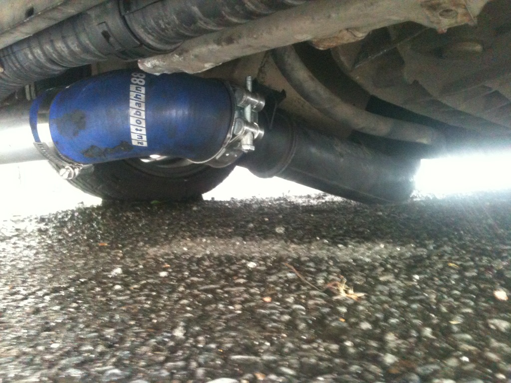

Plans left are to raise the rear one notch get my alloy steeled sprayed then fitted new clutch then limited torque stage 2 then I've taken this car as farad I want to go :-) there is a slight issue with a dodgy intercooler set up being routed very oddly lol so am gunna have another bash when more silicone arrives
*facepalm*
Plans sound promising though mate, you'll be amazed at how much difference a proper map makes, assuming your pump doesn't die first. With regards to that intercooler pipe - tuck it up into the gap between the sump and 'box, sit the PAS pipe around the outside of it, should sit a lot nicer. Smile
Because of the angle of the charge pipe it's pulling the black pipe down from where it's meant to sit :-( so have ordered some elbows and a straight reducer so I can go aroun the chassis not under it I think the guy I bought this set up off has standard ride height lol mine is - 60 :-( I can't drive the car anywhere but I'm looking forward to the map I already live the mega awesome sound of the turbo spooling XD
