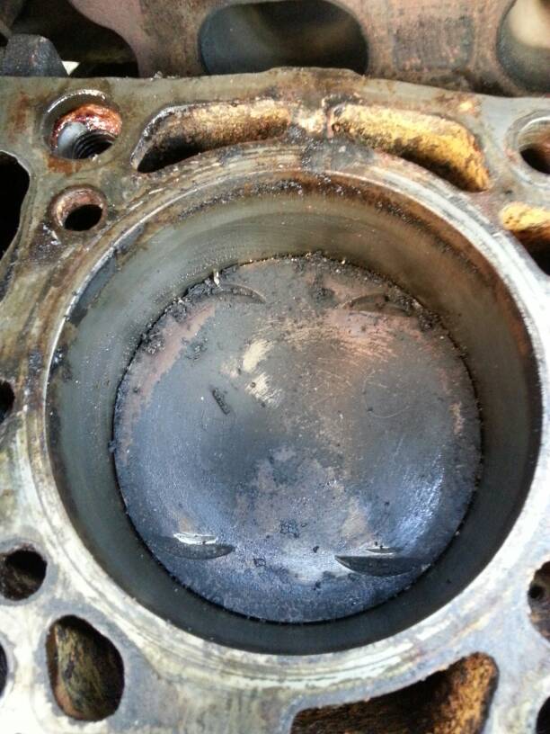

Not much has happened to it yet as I wanted to get the head of to inspect the damage. This way I can make plans and set a budget.

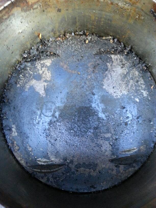

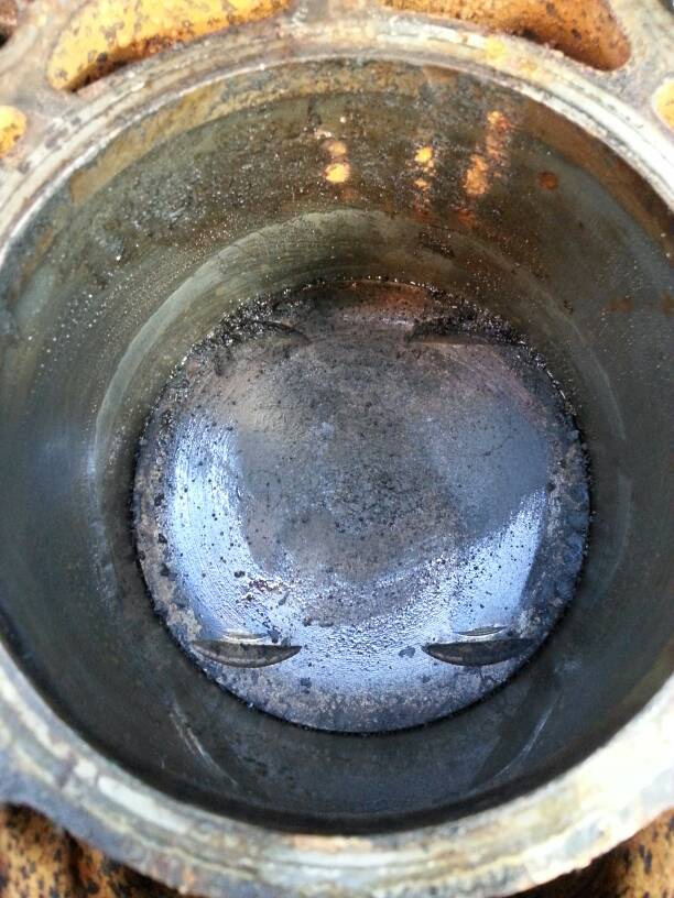

The valves are well and truly bent, some are catching on the head they're that bent. They have left scores on the pistons to be expected, but as far as we can tell threes no major damage!
Pistons starting from cam belt.

cool there are marks on all 4 cylinders on the inlet side,

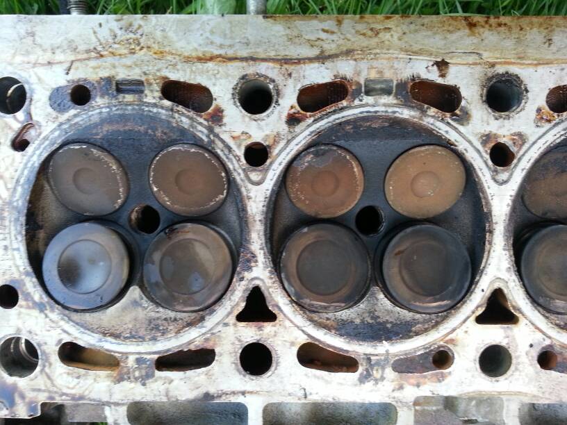

Ill brave the cold and get pictures of the head for you.

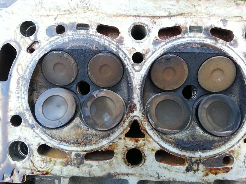

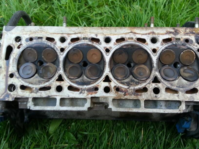

Heres pictures of the head.
You can tell a couple of the valves are catching the head.
Same but from opposite angle.
yeah they be mashed
lol when you get those inlet valves out that head they are going to look bent as a dogs hind leg
(10-10-2013, 06:28 PM)cully Wrote: lol when you get those inlet valves out that head they are going to look bent as a dogs hind leg
Yeah im guessing they will. Undecided hopefully not too much damage to the valve seating. I think the head wont be stripped till I got car in garage as I have more room in there with big work bench.
