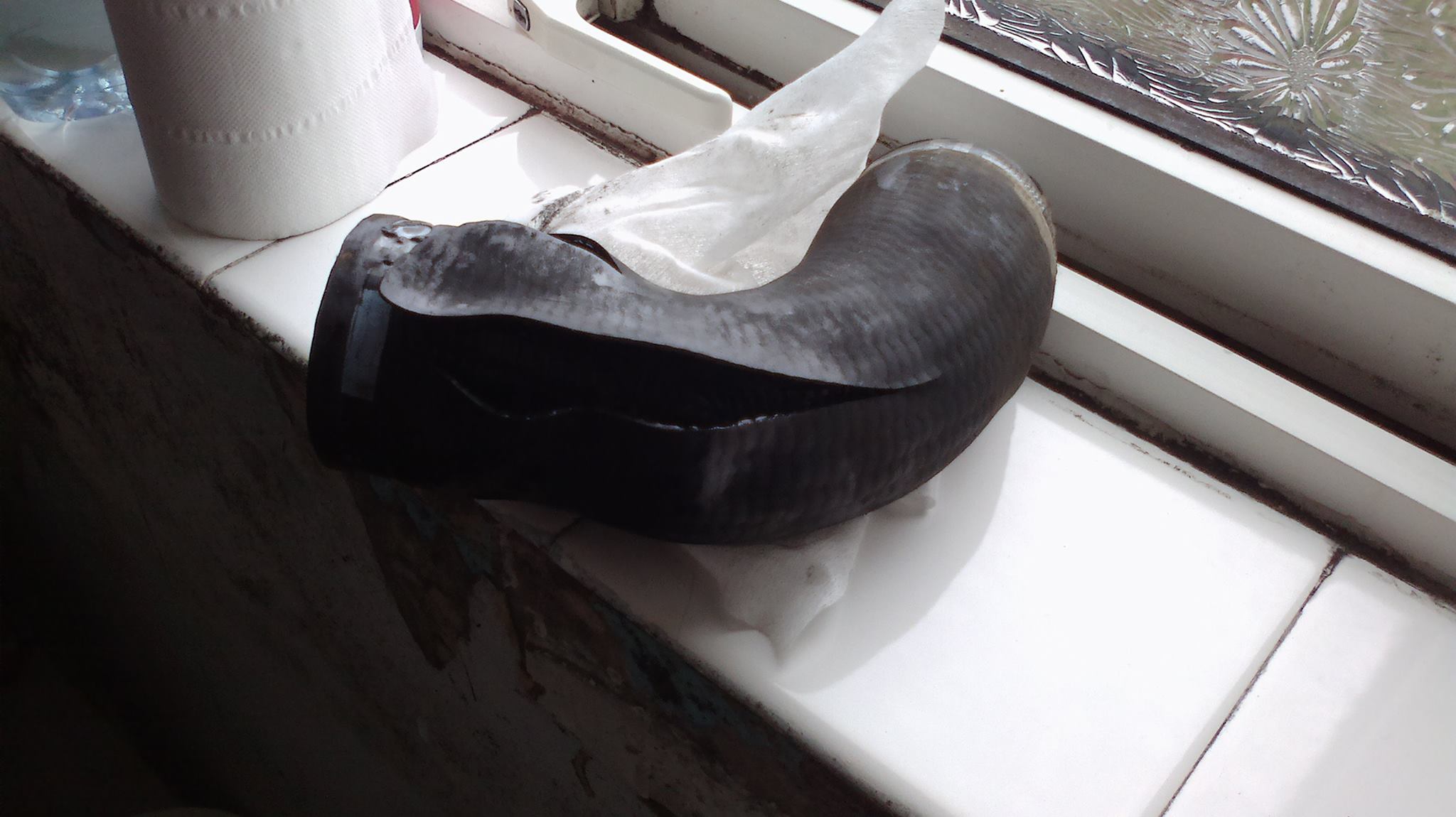

aye well should be fun finding it, was motorway cruising though and heard a big pop, thought a tyre had blown out at first, realized it hadn't, loss of power, looked in rear view mirror to see stupid amounts of coal and everyone moving to overtake me . .lol
found it lol . . . . . .
Thats quite epic for stock boost
