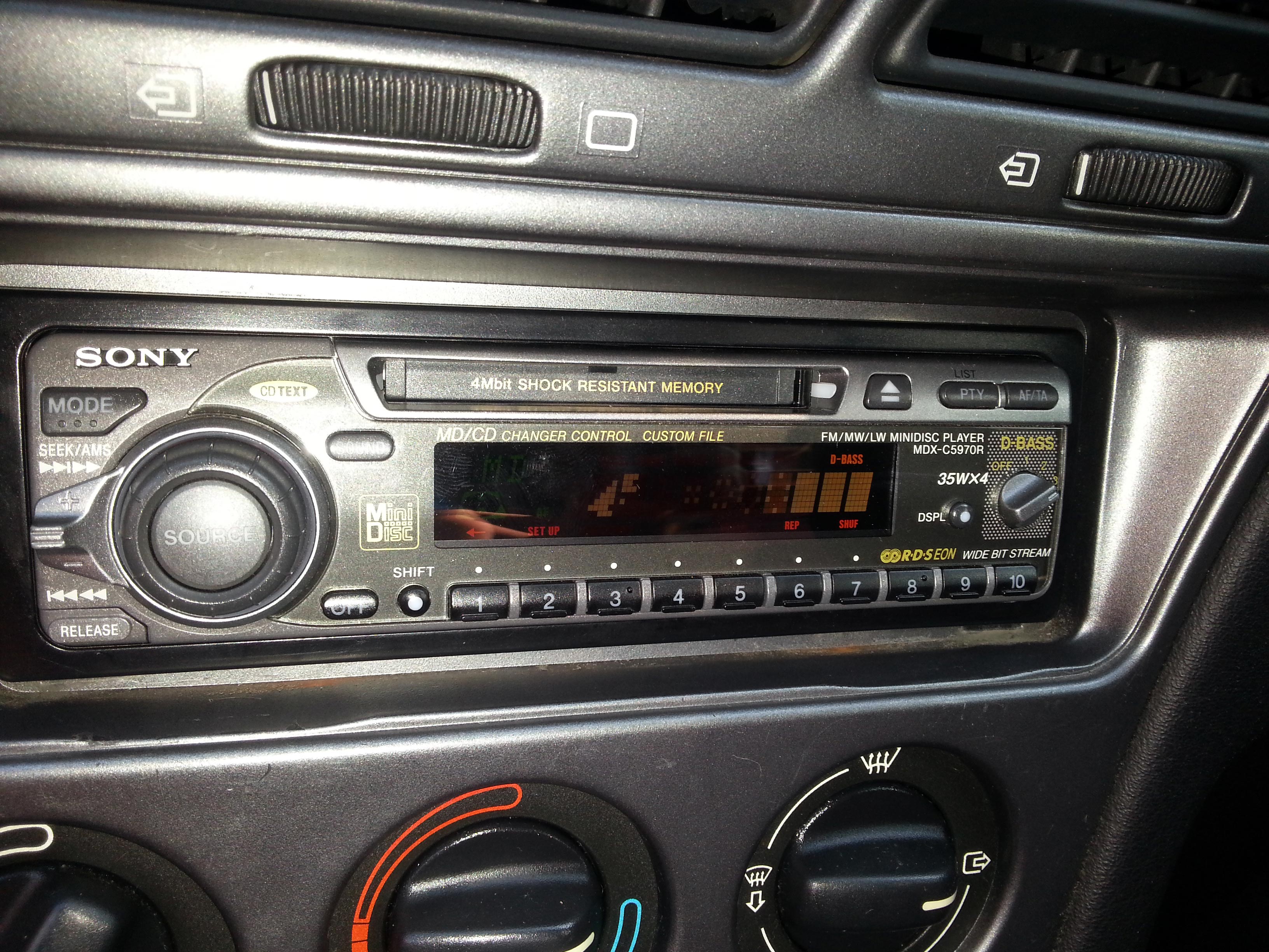

Anyway here is my new (old) head unit!
That's right Mini Disc ;-)
