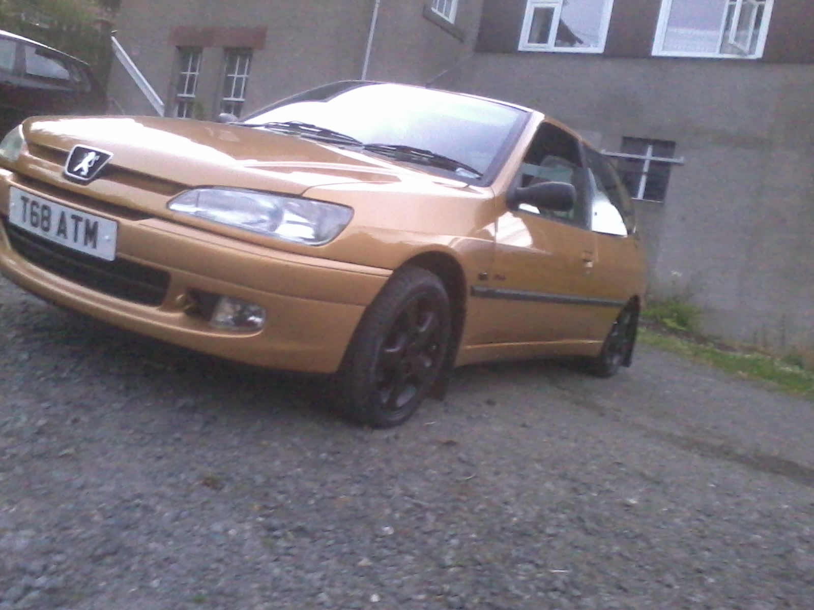

Alright folks, new to this place in case u were wondering! I got myself a ph2 Blaze yellow D Turbo 2 months ago now. It was completely standard with a years m.o.t having passed with no advisories and a f/s/h @117k I have recipts for a 2nd hand engine,gearbox,timing belt etc at 90k miles for £1500 back in 2008 done at citoren edinburgh so its pretty fresh underneath also. The body work is pretty good for the age no rust or welding and the interior aswell... This is a small ongoing project of mine from standard to how am needing it to be.. Hopefully after i get the looks fully sorted ill get on to tuning the lucas pump and that to a stage 1 then see what happens with other stuff aswell...
Heres the car standard...well with flaps lol... and the car had 4 wheels in the back so it looks abit lower than standard!
I got a new rocker cover gasket, new filler pipe, drive shaft seals fitted and also put on a 2nd hand dturbo exhaust as the exhaust that came with it was from a 1.6 or some shit!! back pressure y lady garden!! haha. I also polished and valeted the whole car and got an official peugeot touch up pen for any small dents etc... not bad but not a 100% match due to the ageing of the sun slightly over its 14 1/2 years of life!!
I got a set of lasers (yes not cyclones for once!) for it but they were in some real need of tlc and refurbing... i ended up doing it myself with the aid of 14 hours, a wire brush attachment for a mini grinder, wonder wheels and 4 grades of wet and dry before etch primering them and spraying them gloss black and laquering them to f*ck!! They turned owt alright id say for a homer!!
after buffing and fillering
after several grade of wet n dry
after cleaning and zink primer (all round, both sides)
The spray gun attachment for a can and the gloss layers
again after glossing
..........CONTINUES...............
and thats them laquered and done!         they were then polished ready to rock!
Next step was my evergreen lo-pro 45mm's going onto the rims... mental sticky tyres and mental grippy just abit f*cking noisy and they dont last long!

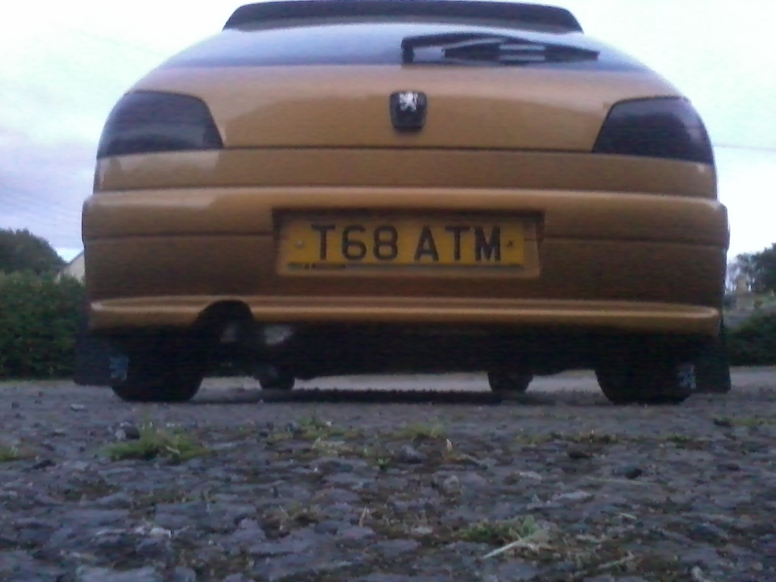

I then tinted the back lights and side repeaters pretty dark     (still quite visable lights tho)
I got super white xeon main,beam and side bulbs....         ( old standard 1s were too dull)
iv recently also bought semi synthetic oil, oil filter, air filter and fuel filter all of which i have still to do haha.
Then i got the torshin bar lowered 90mm (2 clicks i think) sitts pretty sweet all round the arches well u can still get ur fingers up just in just!         Handles like f*ck now!
iv got 60mm front springs to go in... stil waiting for them to go in and also i was thinking of getting uprated shocks all round??
so thats all so far but heres the rest of my pics for now...
all comments or suggestions are greatly welcome and much apretiated thanks for looking.
Shes looking good mate, think it would look awesome with a GTi6 front bumper if you can find one.
As dum said! gti bumper would look win. Good lows all round IMO too Smile
(16-07-2013, 11:11 AM)Dum-Dum Wrote: Shes looking good mate, think it would look awesome with a GTi6 front bumper if you can find one.
cheers mate.. loving this site.. thats a good idea if i found 1 in blaze yellow that would definetly be worth it!
(16-07-2013, 11:19 AM)Matt Wrote: As dum said! gti bumper would look win. Good lows all round IMO too Smile
yeah i think uz are right... never really noticed before,the bumper does look too standard for the car, a gti 6 front bumper and a set of skirts would be handy. hard to get the skirts im finding tho... would rather get them both in blaze yellow so the ageing of the colour matches... thanks for looking bud

Looking good mate, not to keen on the back lights though, have a look at mine if you like! Smile
Blaze '6 and Blaze D-turbo!
looking good . . .there's a reason people like cyclones though, Lasers are the heaviest wheel made for a 306, about 3kg a corner more . .lol
thanks for the feedback guys... i know the tinted backlights are a bit neddy, they even appear purpley kinda in colour on the pics but my phone sucks... they are solid black in person and i was just trying to keep a black and blaze yellow theme going on.... just to be abit different... i was even considering spraying the back and front pug badges black also?? i really do need to get the pump tweeked abit its no fun running standard! im onto that just know think iv found a boy whos willing to help me in my area... this website is truly excellent... should have got on here eairler.. a few of my pals have 306s also.. all from a small area hahah
(16-07-2013, 12:29 PM)Mattcheese31 Wrote: looking good . . .there's a reason people like cyclones though, Lasers are the heaviest wheel made for a 306, about 3kg a corner more . .lol
yeh i did reasearch them before hand and found that out... i just didnt think it would make that much difference?? does it ? i was just liking the look of the phase1 wheels aswell, i had a ph1 xsi 8v before, thats prob why i like them better....cyclones are still tidy.. i just wanted abit different 15s

Just a quick question for what i was goin to do next aesthetically.. black front and back peugeot badges and an ph1 ecosse spoiler (boot window 1) or not? just wanted some feed back!! cheers all!

UPDATED 11/05/2014
Hey people haven't updated much on here for a while but i have done a few small things to the motor over the last 6 months and the engine is still completely standard and untouched. Its done 130k f/s/h and has just passed its 2nd m.o.t with me with 2 advisories over the both of them!! Its still on a lucas haha but im away to screw it out next weekend myself after i get the t-piece for my boost gauge here and fitted. Heres a list of all that iv done to date that i can remember and pictures aswell!! enjoyItwasntme
*4 New tires 2 kuhmos on the front and 2 evergreens all 45mm low pros (sooft)
*Refurbed by myself last year lazers in black
*Jamex D-turbo springs 60mm ( maybe need to get the grinder out!!?? )
*Uprated shocks all round
*Torchin bar lowered 100-110mm (ish)
*ph3 HDI sideskirts resprayed by me haha came with crack in Censored for £45 too!
*ph3 parcel shelf and speakers,
*Resprayed matt black spoiler and front badge
*Blacked out rear lights,indicators (need to get them smoked front 1s u get too
*205 1.9 GTi custom full exhaust need to fit my decat section tho! 1yrs mot now
*mk1 renalt scenic splitter and 2 rear headrests missing b4 from scrapy all for 10er
!!PICTURES!!
[attachment=16123][attachment=16122]
[attachment=16124][attachment=16125]
[attachment=16126][attachment=16127]
** And here's how she sits today!! Inlove
[attachment=16128][attachment=16129]
[attachment=16130][attachment=16131]
To Do Next: screwed out to 17,18psi, Custom air intake, New radiator,
custom focus rs FMC, Them smoked front lights u get and then maybe a gti6 front bumper if i can find one in blaze that is! Then ill see from there

Looks well!
Front needs coilovers to match the rear & you should cut and weld the exhaust so the tip protrudes a little less. Would look spot on then
(12-05-2014, 12:42 PM)mcglynn Wrote: Looks well!
thanks budd... yeh i couldnt agree more about needing coil overs on the front. Im gettin some asap or atleast choppin a coil off the 60mm d-turbo springs that are in for now..?? Im gonna get around to fiddling with the exhaust it was done in abit of a hurry Itwasntme
should look pretty epic when theirs coal pouring out the LUMM of an exhaust when its roaring next week 8D hehe
no smoke no poke... so they say!Puke
Wouldn't go cutting springs matey. I done it on my last car and that ended up in a heap.
Wasnt directly the springs fault as I fell asleep. Had they not been cut the car would have reacted a lot better when I woke up though.
