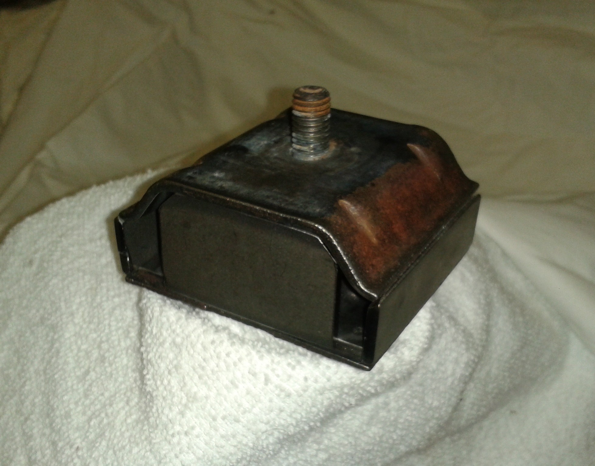

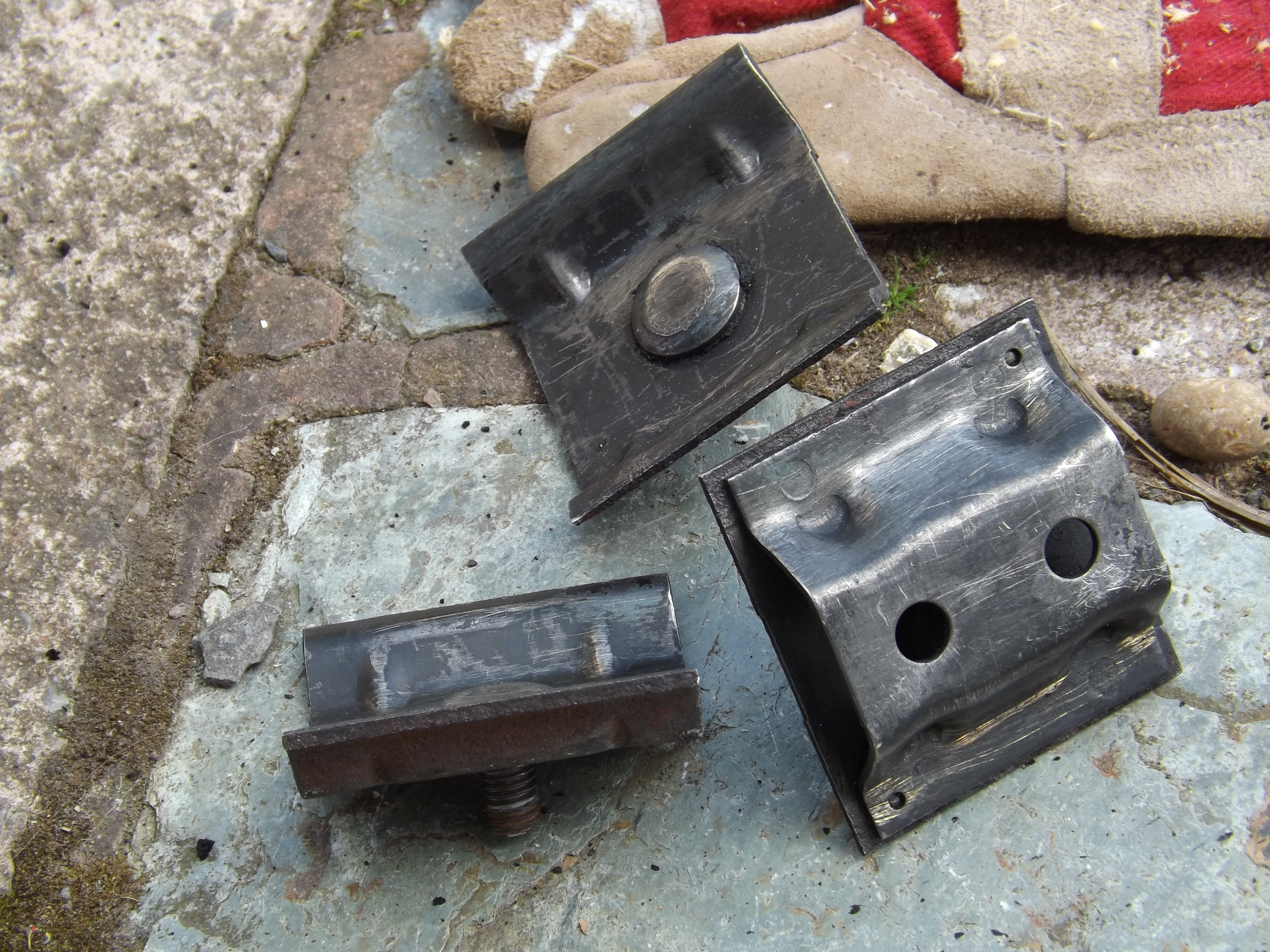

started cleaning up my old mounts so i can convert them to solids

Thing is though if you don't get these exactly right its going to throw the track of the car out, and this would have quite a serious effect on the handling and not in a good way lol, so £130 isn't that bad lol, did you make a jig from your new set before you fitted them?
im in the process of making the rear pair.they will be the easy ones
i will make a jig for the front pair as they are a little harder to get right
